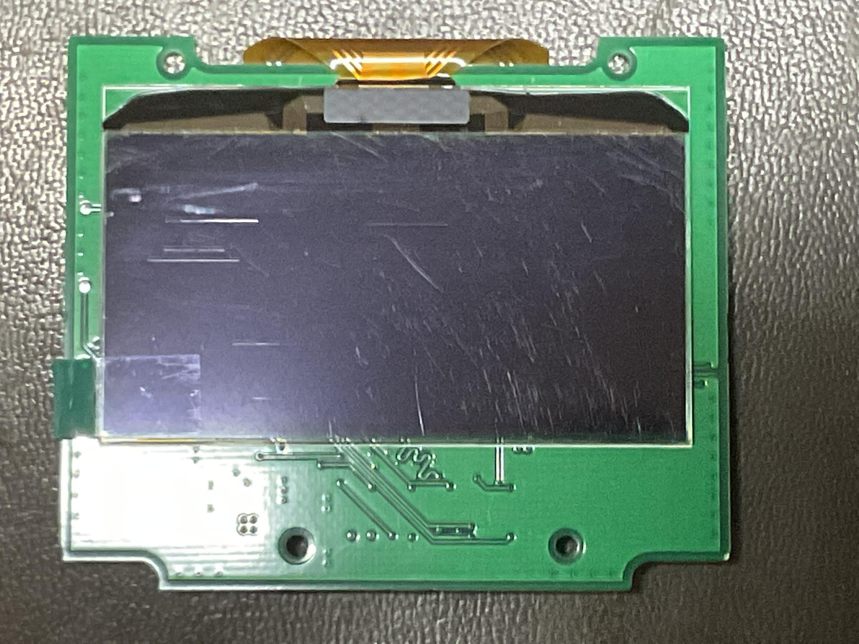

        Re: Agilent U1253B OLED display failed
        A quick update: I did get the display from a U1273A today. It does work on the U1253B, BUT: it doesn’t fit right (display is to the left and the mounting holes are different). More to come later…

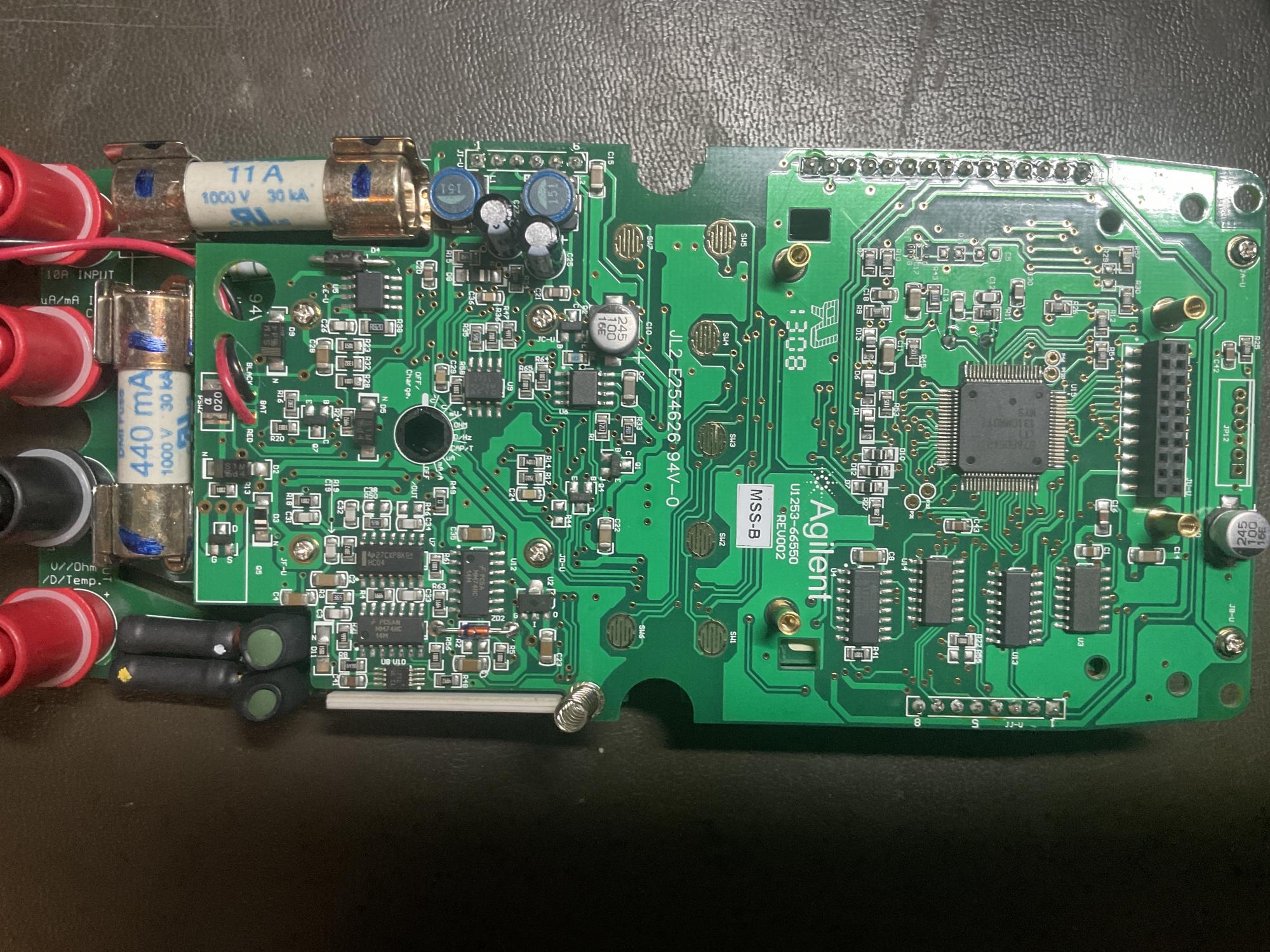

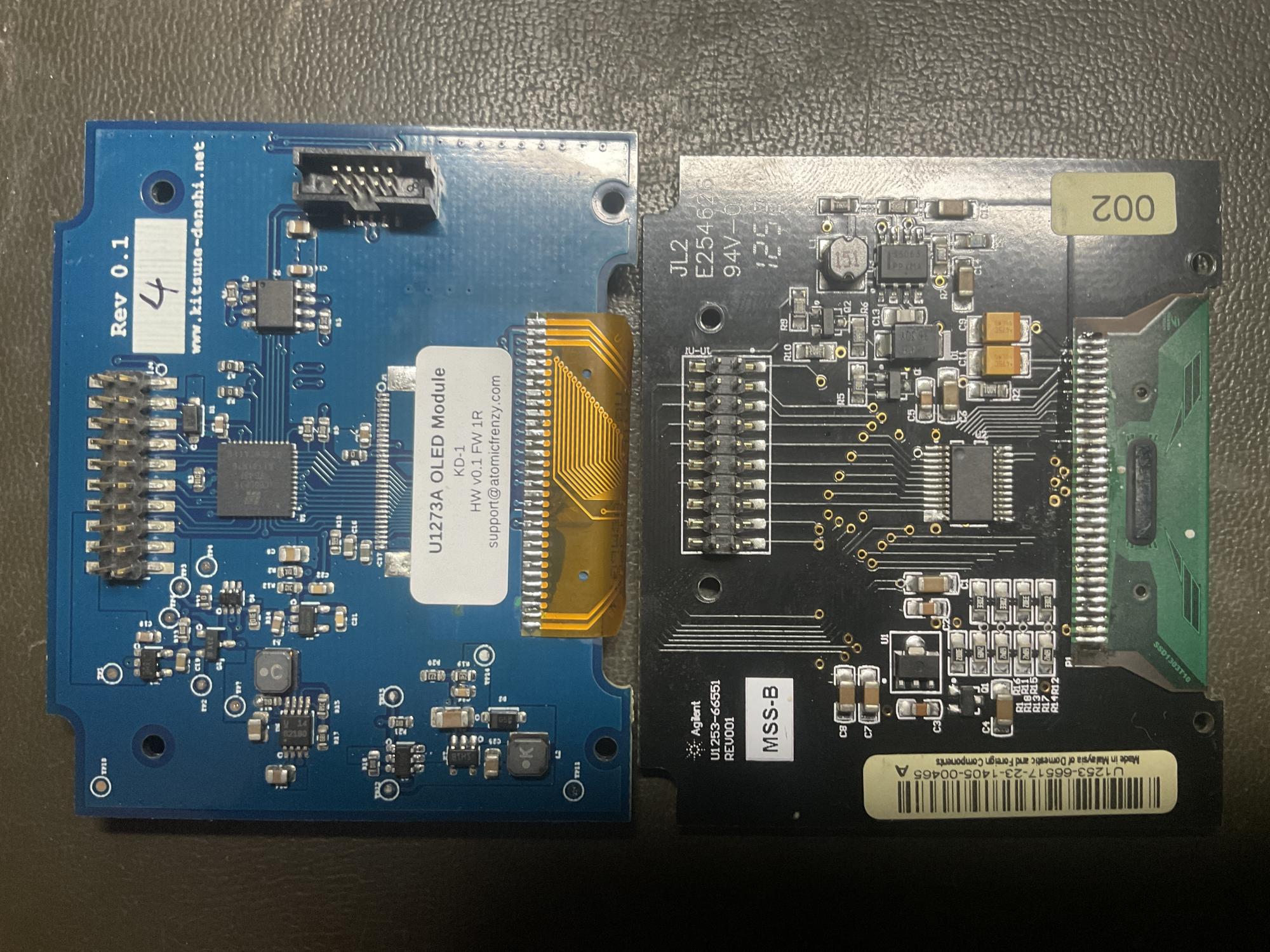

          Here are a few pics. Look at the display being offset due to the connector location on the back.

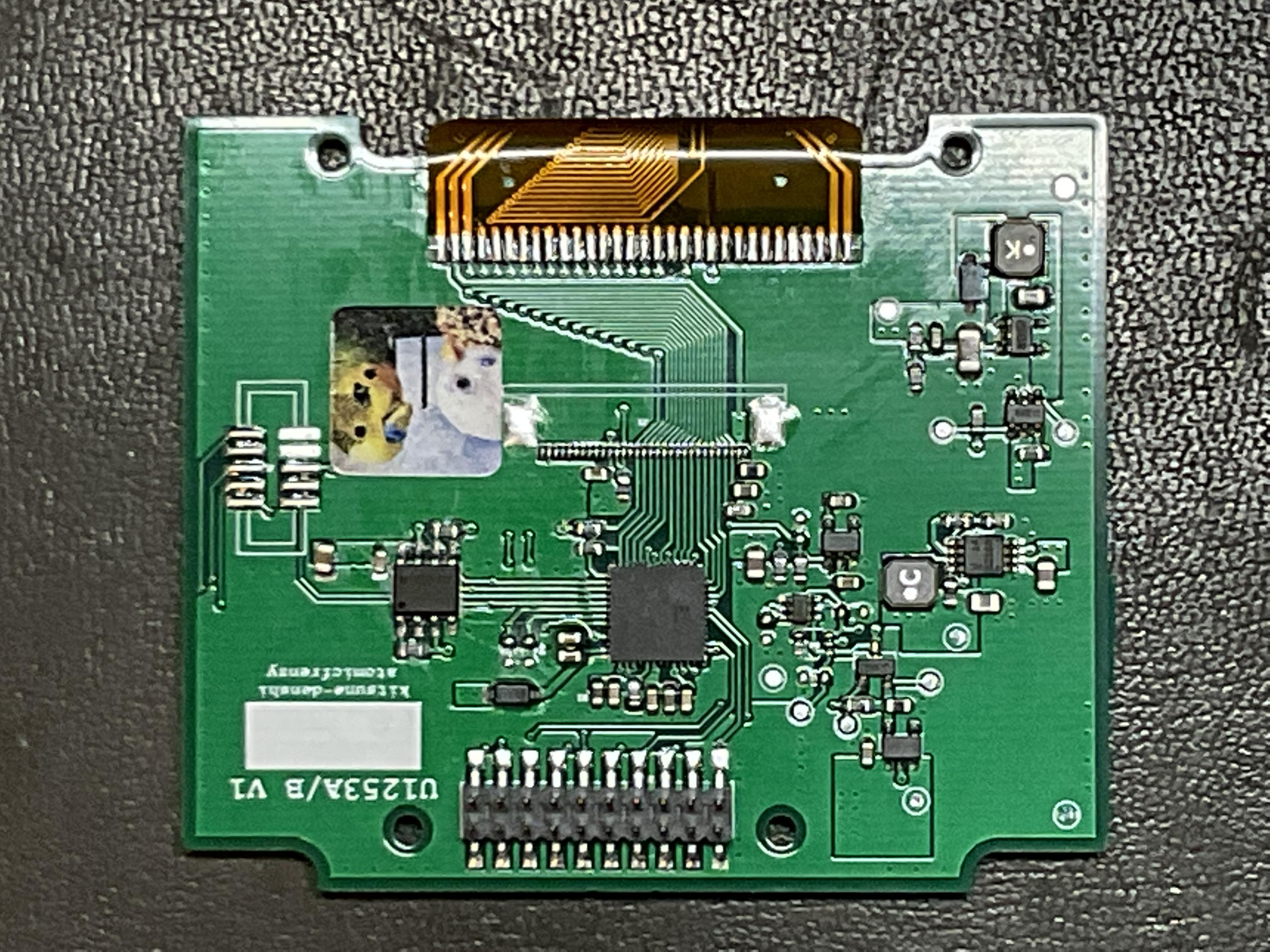

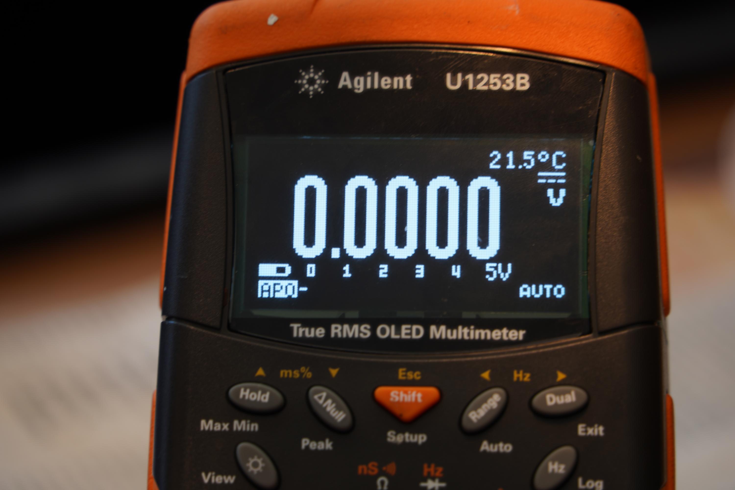

            Fast forward a few months: The display I've ordered from that EBay seller worked fine as kind on my meter, but I couldn't mount it correctly. After a bit of chatting back and forth, I decided to send the seller my original display so he could "redesign" his old board.
            So he DID! I've got the new display! Thanks bra! You've made my day! Haven't had time yet to install it, but hopefully soon. Here are some pics of the new display and board.
            • CapLeaker
              Leaking Member
              • Dec 2014
              • 8352

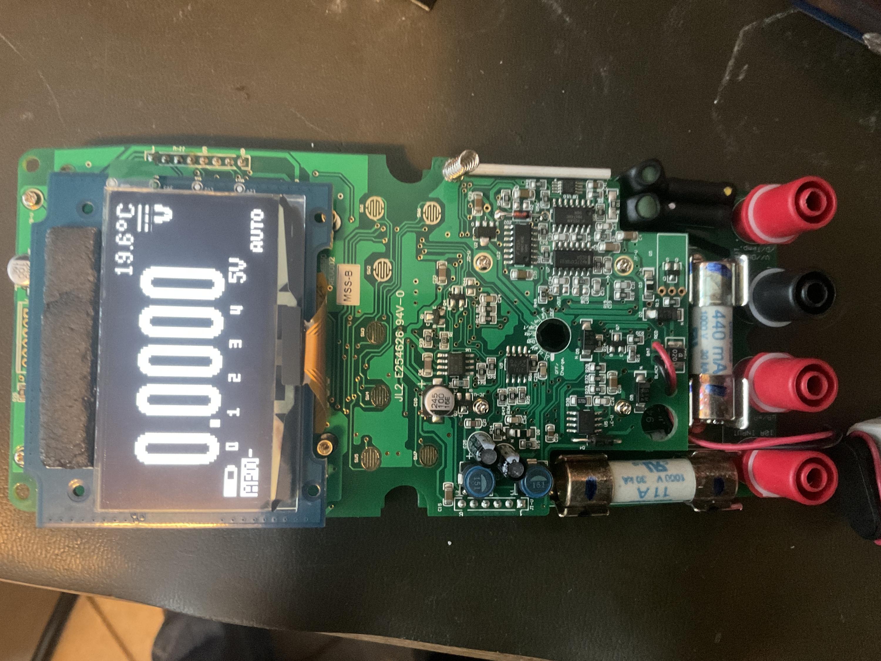

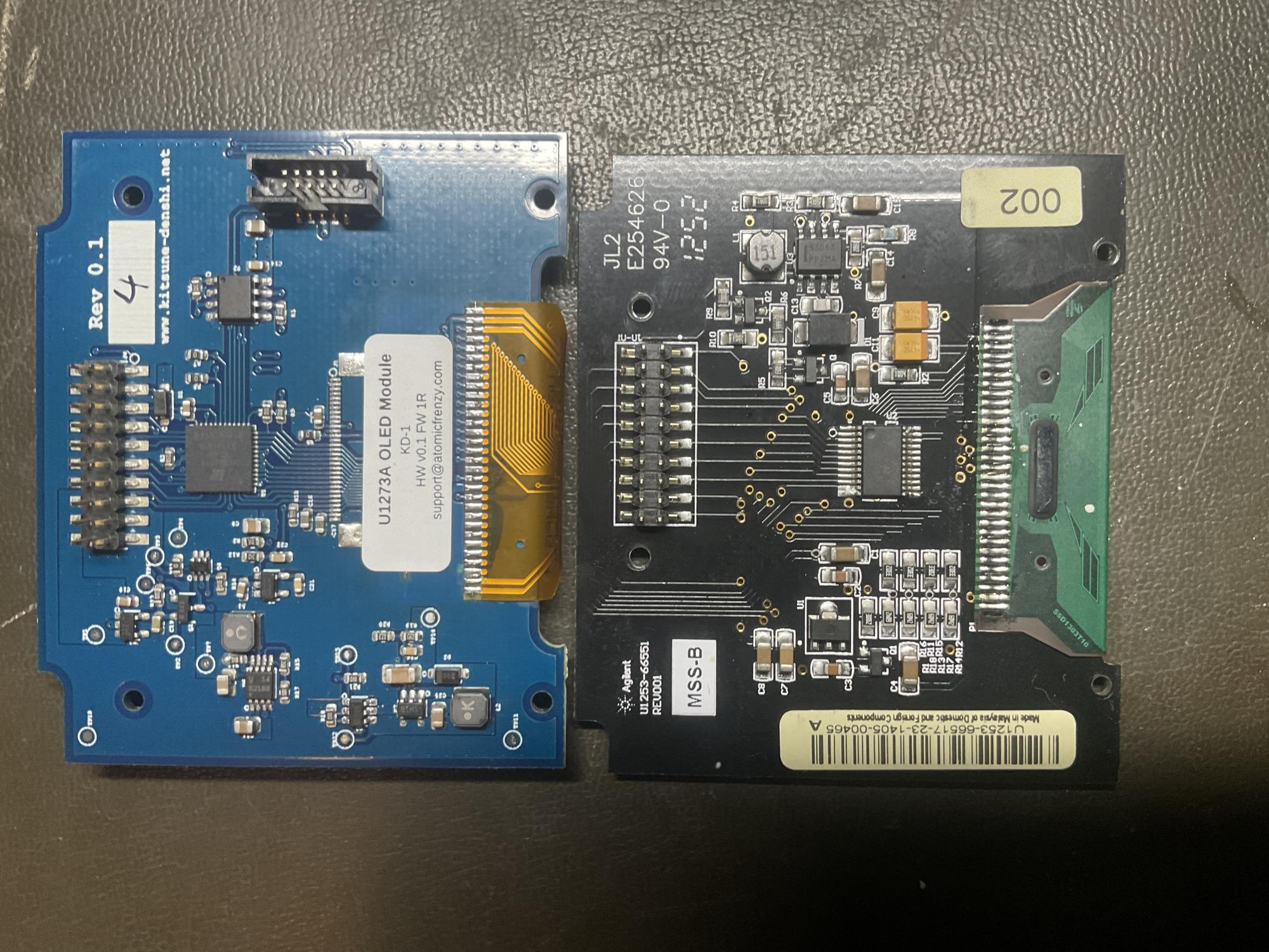

              I caught a lucky break today and got home early and had to try that new display out. I've got this display drop in replacement from "atomicfrenzy" on EBay for the Agilent U1253A and the early model U1253B. So remember to verify the old display that it has the same old style SSD1303 display. Atomicfrenzy's replacement is perfect and fits correctly. No clearance issues or anything like that. The artifact issue due to the old 132x64 to the new 128x64 is not existent and properly dealt with on this fully assembled version. I had chosen a white display not the yellow.
              Be careful what you order. Atomicfrenzy also has a kit, which does not address the column shift issue and is cheaper. You may contact the seller and I am sure he will get you the right display.
              He will put a new listing up for this drop in display later on today. Thanks again buddy for making this happen!
                  That's great, using an MCU as a protocol translator to keep new displays compatible and stick it to Keysight. He totally redesigned the power section.
                  I think the first board fits U1273A. OLED TV's are still out there, so there is hope for the lifetime issue.
                  I wonder what to price something like this at. I have to finish the 34401a board I started before my old one totally gives up the PMOS lol.
                  The new green OLED is a bit gnarly, I think it's the brightest but a bit icky.

                      So far so good with the drop in replacement OLED on my U1253B. Not sure why, but I like the white display better than the original yellow one. Everything is functional as it was before. No glitches or anything. I tried it with rechargeable NIMH true 9V (9.6V) batteries, with regular 8.4V NIMH and a 7.2V LI-ION. Works fine as kind!

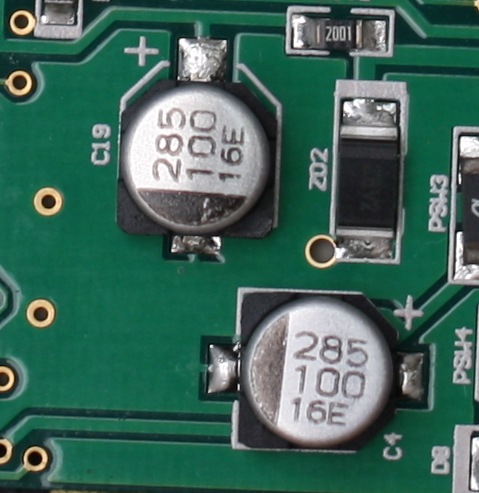

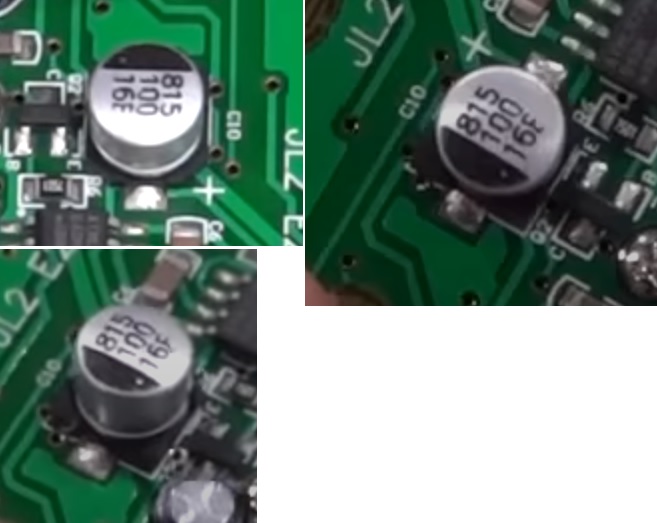

                              My OCD caught that the SMD capacitor C10 in his meter is bulging though.
                              See screenshots from the video:

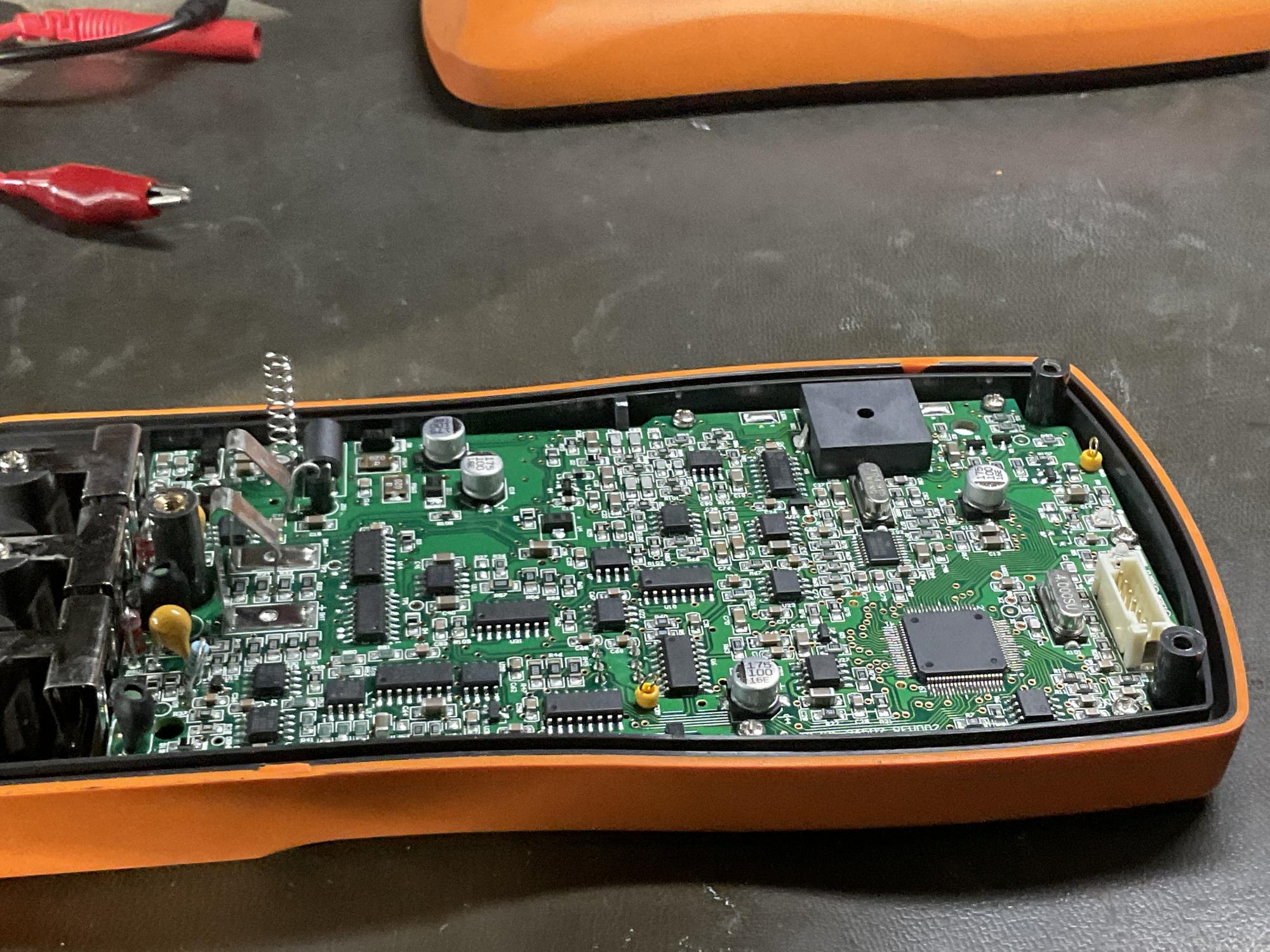

                              I have the same with C19 in my Agilent U1733C does anyone know if it is normal or not?
                              Based on the markings it seems to be the same cap model, not sure who makes it?

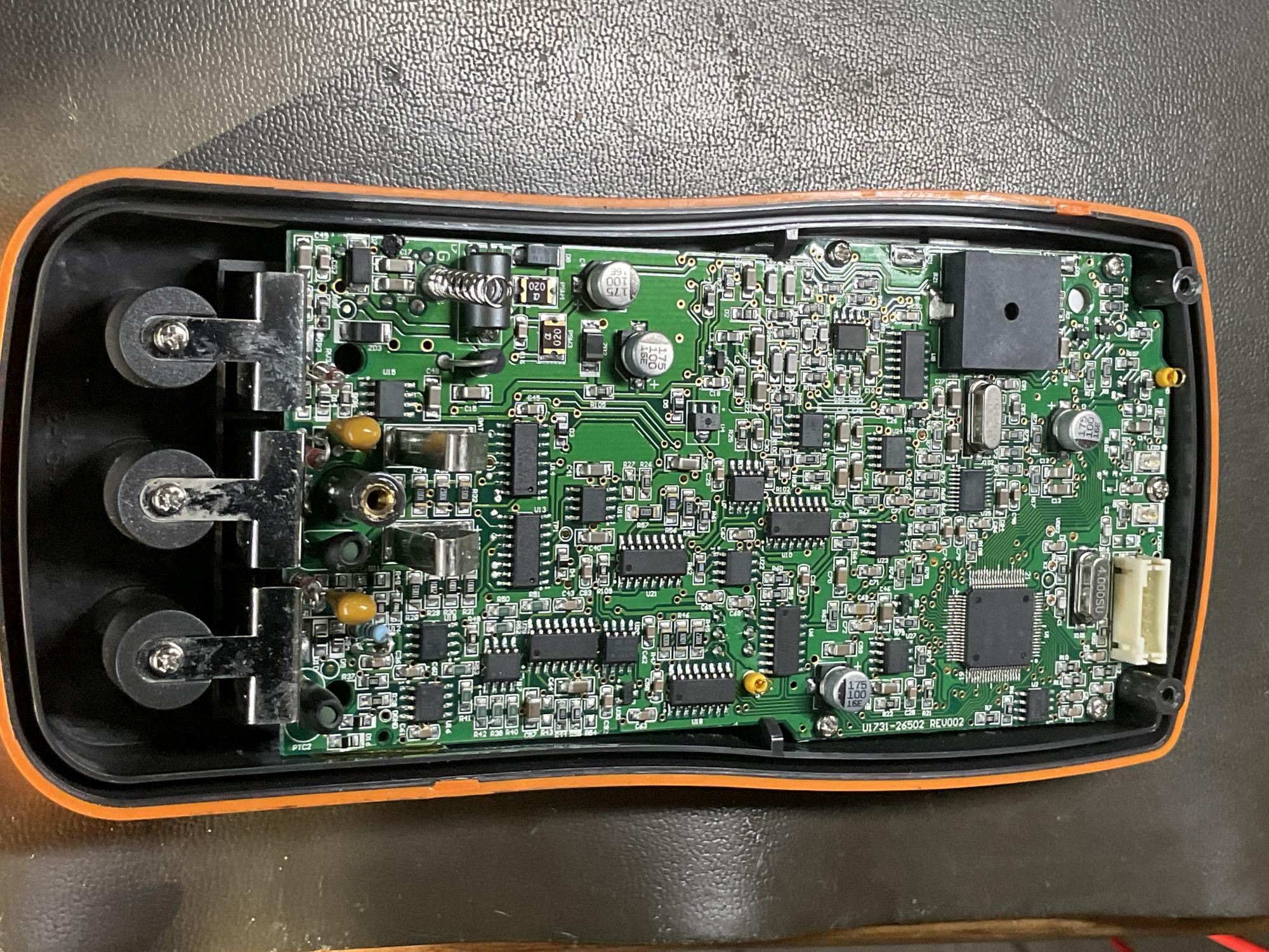

                                Those caps look a little pregnant. In order to calm you a little down I’ve opened my Agilent U1733C and snapped a few pictures. There is already one board picture of my U1253B here on this thread, so I am not going to bother reposting that.
                                Here is my take on this cap issue:
                                To me those caps / brand in question do have a very slight bulge to it. To me these aren’t completely flat. Even mine are not on the U1253B nor on the U1733C. It seems that those caps you pointed out are having a worse bulge than mine… what’s your take?

                                  Thanks, I guess it could be normal.
                                  I did measure the ESR in circuit on my U1733C:
                                  I don't remember the exact values but C19 , C83 & C44 measured normal in my eyes.
                                  But C4 seen on my picture here above that has a flat top measured a bit high!
                                  I still think it is strange that some have flat tops and others not.
                                  Still no idea who the manufacturer of the caps are, but seems like Agilent / Keysight likes them as they are used in multiple meters from them!
                                  I did post some high resulution pics of my U1733C on eevblog here:
                                  https://www.eevblog.com/forum/testge...adings-normal/

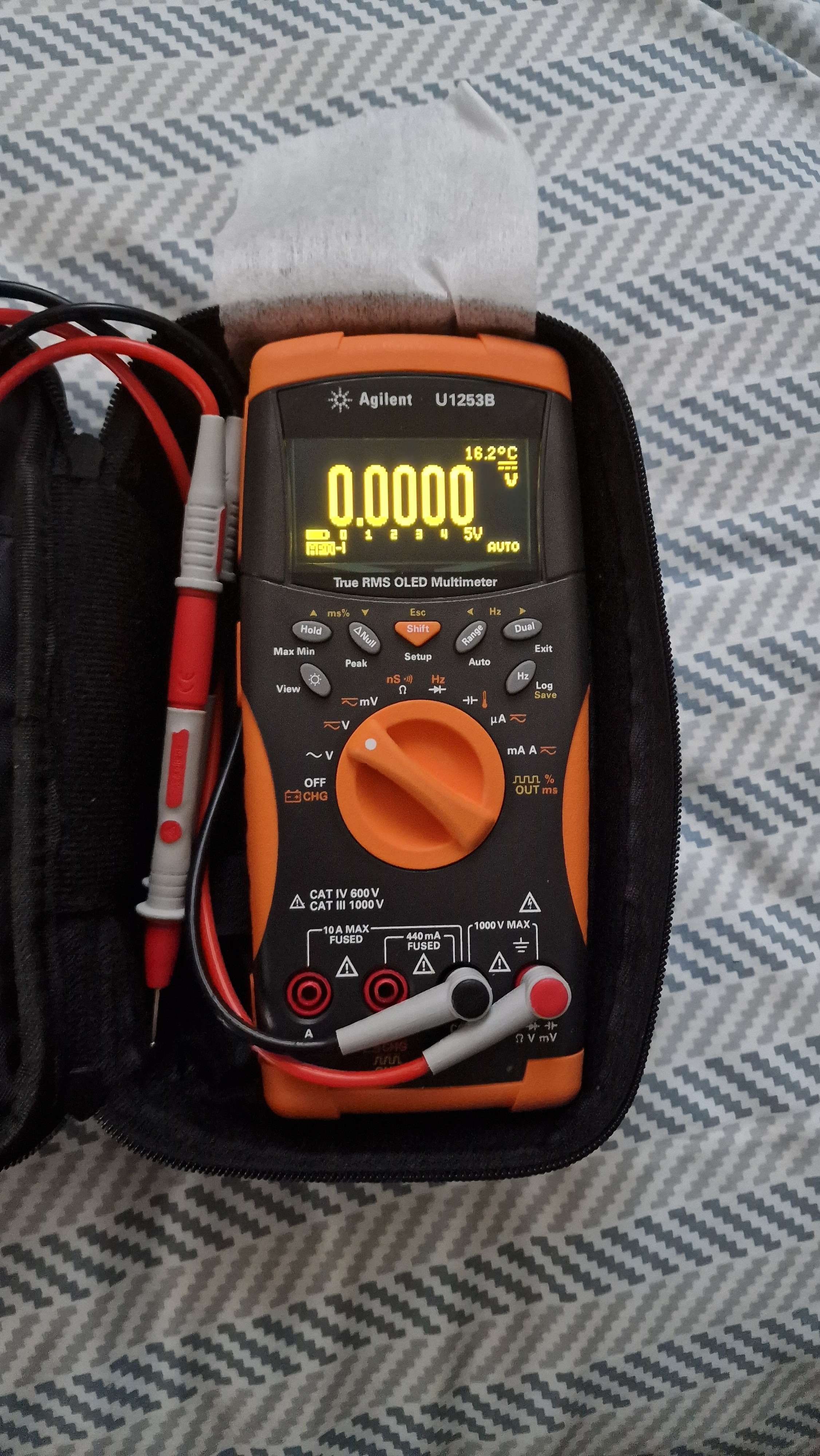

                                    My U1253B failed after about 4 years with virtually no display left at all. So went online & bought what I was told was a replacement, however
                                    it didn't work properly and some of the digits were off the side of the screen 🤬
                                    Anyway after that I just boxed the thing up ready to sell as parts. Luckily I forgot about the meter only noticing it again in a drawer about 8 months later. So before posting it for sale on eBay I had a
                                    look around for any new options, and to my surprise there were replacements showing up in the search 😀 I semi-reluctantly bought one.. And it works like a charm.
                                    If anyone's interested.. Here's the link to the one I chose..
