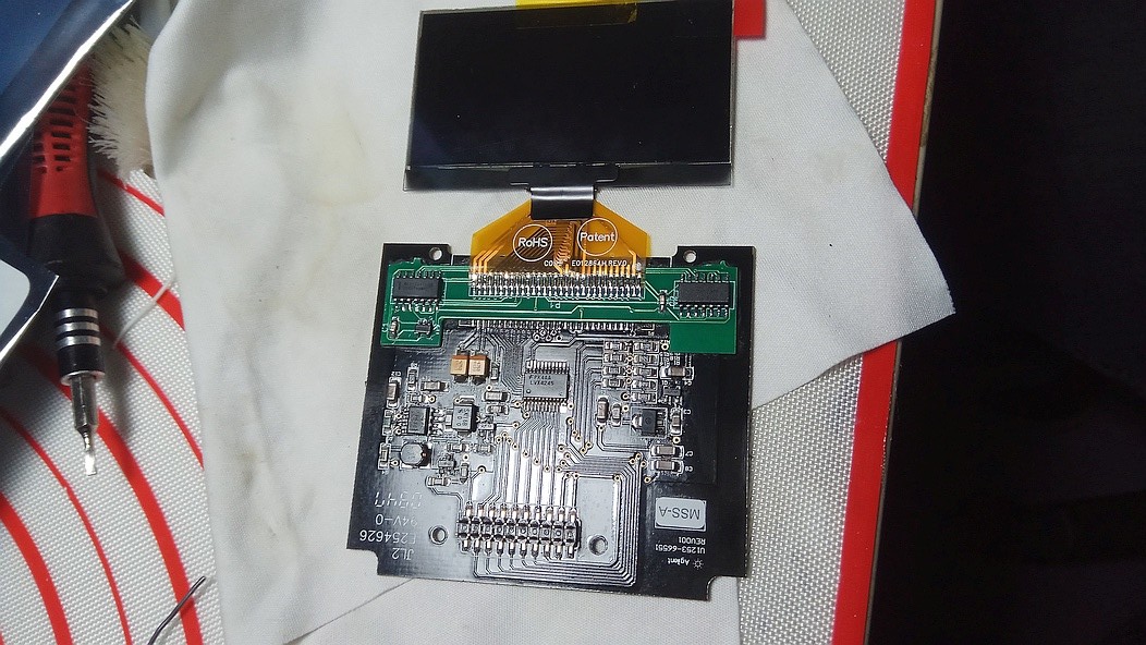

    Dang! After about 6 years of service, my display is finally toast. I did notice it not being as bright as it used to be, but now I can't use it anymore at all. I don't think there is warranty on it anymore. Also this one was a warranty replacement to my original one that I bought back in 2012.
    Here are my options:
    - fix it with a replacement display, if one is available
    - maybe it's possible to make it an U1242B (LCD not OLED)
    - bin it, kick it to the curb, shoot at it, drive over or whatever?
    - replace it with something else, but what?

    I caught a lucky break today and got home early and had to try that new display out. I've got this display drop in replacement from "atomicfrenzy" on EBay for the Agilent U1253A and the early model U1253B. So remember to verify the old display that it has the same old style SSD1303 display. Atomicfrenzy's replacement is perfect and fits correctly. No clearance issues or anything like that. The artifact issue due to the old 132x64 to the new 128x64 is not existent and properly dealt with on this fully assembled version. I had chosen a white display not the yellow.
    Be careful what you order. Atomicfrenzy also has a kit, which does not address the column shift issue and is cheaper. You may contact the seller and I am sure he will get you the right display.
    He will put a new listing up for this drop in display later on today. Thanks again buddy for making this happen!

        I believe the Agilent original OLED display is long obsolete, it has SSD1303 controller IC. Newer OLED displays have a different controller IC.
        Some small differences from the original Agilent one, like the entire screen is mirrored if you use one of the newer OLEDs so people have made adapter boards, sell kits etc:

          there is a thread on eevblog where a guy puts a modern display from aliexpress in one.
          i think it involves an adapter board.

                    Dim display can also be caused by the boost-converter problem, I think it's ~13VDC the OLED needs, but small chance this is the prob.
                    I believe Agilent/Keysight used Raytech OLED displays, who simply stops making them, minimum orders of at least $20,000. Then Solomon do a small change/upgrade of the OLED controller IC losing backwards-compatibility. I think it's intentional. SSD 1303,5,6,7,8,9 come on already.
                    You could add a small MCU to translate the pixel shift, or the mux that guy used. I think you need a new display and translator board. One guy put in a super bright green OLED that looked neat.

                              Actually there are ready made drop ins to be bought. I found the seller for the kitsuni-denshi unit. Comes with the LCD and board as a drop in replacement, ready to go. However, it’s NOT cheap!

                                        Agilent U1253A uses NEC uPD78F0547 8-bit MCU Last time I worked for a company designing in NEC processors, it was the $10,000+ in-circuit emulator the engineers liked. It's likely out of code space or the compiler obsolete. Only one byte to change. Sigh.
                                        I looks like this ali display 2.42" OLED with SSD1305Z 128x64 used with the adapter board at seeed Agilent U1253B Display adapter for SSD1309, green pcb. Not sure what the new controller is.

                                          I contacted the eBay seller and ordered a replacement display, just like the one in the kitsune-denshi link. It’s got a winbond ic. Seller shipped today, but I am guessing that I probably won’t see it until the new year. He didn’t try that display on a U1253B yet, so I guess mine is the first one.
                                          stj want’s some DMM porn… so I’ll be sure to take plenty pics.
                                          I just don’t like the looks of the seeedstudio version of the display. The original display is 132x64. The new displays are 128x64. So besides having the mirror image problem, there is the 4 missing columns that need to be dealt with. If my meter would have these artifacts that creep from the end of the right screen over to the beginning to the left side, my OCD would drive me nuts.
