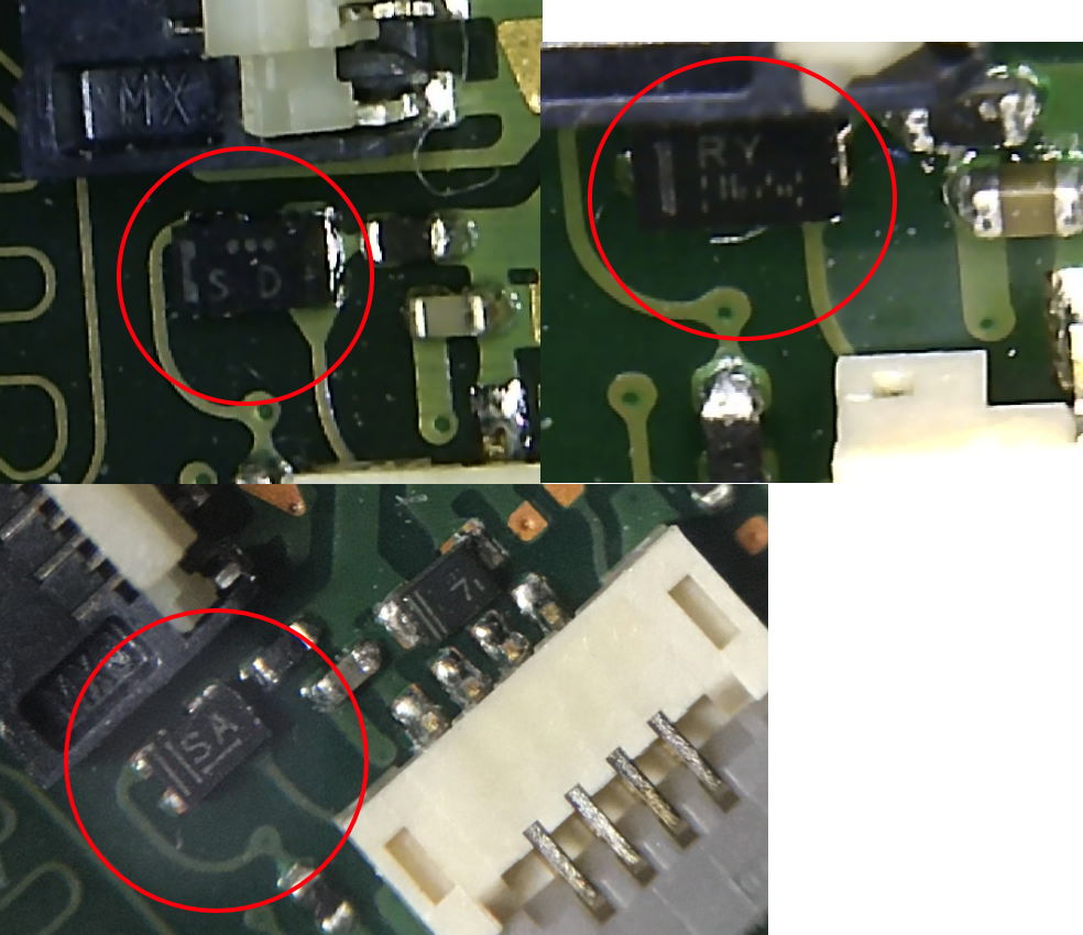

    Nintendo Switch chip id or datasheet
    if anyone can id this chip.
    seen this marking codes from different boards.
    SD
    SA
    RY
    case:
    DFN1006-3
    SOT883

    Re: Nintendo Switch chip id or datasheet
    could be a voltage regulator
      They seem to be mosfet's:
      ROHM RV2C002UN marking code RY
      nexperia PMZ600UNE marking code SA
        Thanks a lot. i will order those.
