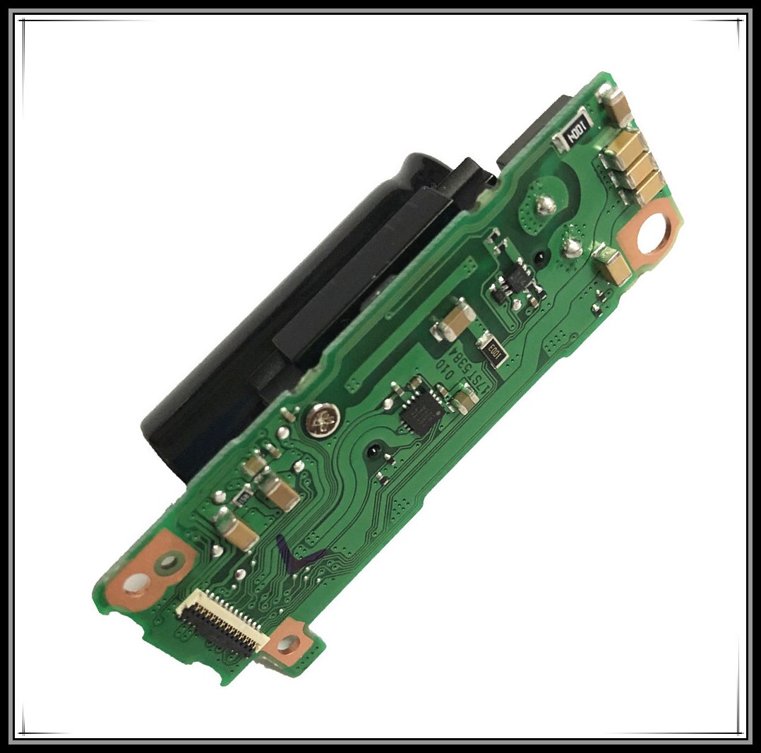

    Hello. I repaired a canon sl2 for personal use, it had a bad sd card slot, bad battery connector, plus a little bit of water residue on the motherboard. The water damage seems to not have caused any damage, just salt deposits that have been cleaned. After repairing everything works except for the flash.
    When shooting with the flash turned on, i get a "wait" message once, then on the second try I get an error: e50. I have disassembled the front to get a look at the flash board, and everything seems good, the flash board also controls the shutter, which works, so it does have communication with the motherboard.
    I have probed the transistor that switches the transformer (that goes to the flash capacitor), it has battery voltage, but never gets switched. No voltage change was detected on the gate pin with an oscilloscope. It seems this gate pin is connected directly to the motherboard via a flex, I can trace it al the way to the motherboard connector, then I cant seem to find where it goes.
    Does anyone know what I should check? I don't have pictures, I have closed the camera and I am using it daily, so I don't want to open it again until I have some new ideas. But I can´t find schematics.
    What has to be working for the flash capacitor to charge up? Does it do any check before so? Maybe check the flash bulb somehow. Sorry, I have absolutely no experience with flashes.

    Re: DSLR canon sl2 flash error 50
    error 50 = An electric control malfunction has been detected. maybe a corroded trace?
      There are new flash charge boards available, did it look like this?
        I would think that is the issue, since it had white spot from the water, but it was very little localized spotting. I cleaned it up and there seems to be no damage to any traces or components, but the key word is "seems". I wish I knew where to be looking.
          That seems to be it. But I don't want to spend much on ordering one just to have it not be the issue. I would like to diagnose first, then if needed, order one.
            flash capacitors have limited life.
            but even if it's bad you should hear the invertor trying to charge it with a few hundred volts.
            be very carefull around those caps/boards - they hold a lot of energy for a long time!!
              Yeah, it's not even trying to charge it. Thanks for the warning, I work on switching power supplies so I take my precautions. The camera also does not want to focus using the autofocus points (not live), I didn't notice this until now since I use it for videos, video uses live autofocus, a different system. I can still focus for photos with live view, just not normal shooting point mode (dont know the name). This could be something I connected wrong, but I'll check it next time I get a chance to open it up. For now it's working for what I need, videos.
                I have opened it and made sure all connections are okay. I definitely has lost it's autofocus capability. I can still autofocus and take pictures in live view mode. But while using it's mirror, the autofocus just drives the lens in then out, then it won't take the picture.
