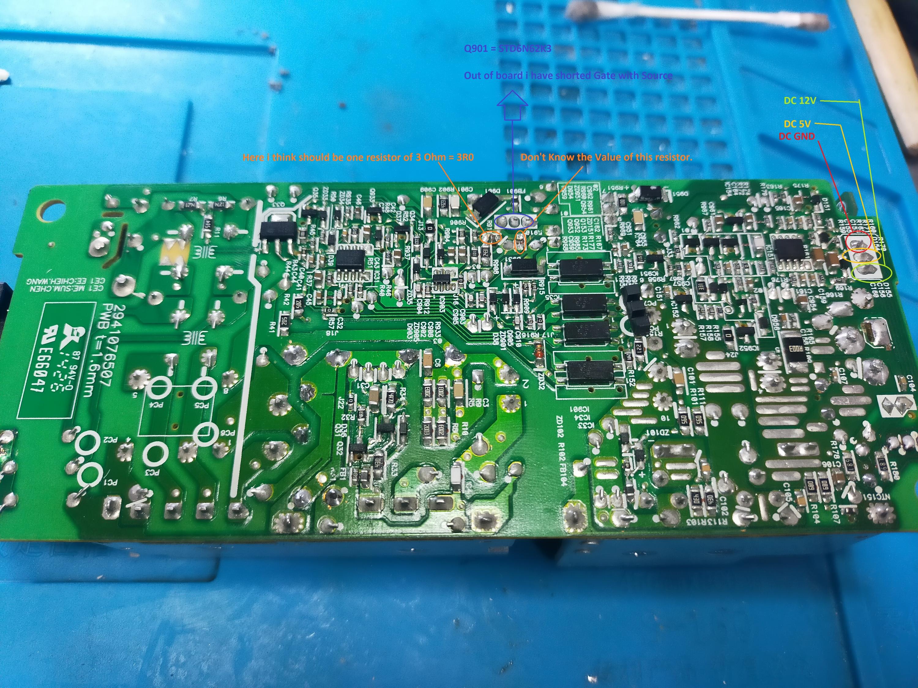

    check q901
    So Q901 is one STD6N62K3
    I took it out from the board and i measure continuity mode.
    I get Beep between PIN 1 = Gate and Pin 3 = Source.
    And linked to it i have that two resistors we talked.
    I think they are bad... but don't know the value... of it...
    One i think was labled 3R0 = 3Ohm
    And the other no label possible to discover ... schematic would be important.
    Seems i have short or bad Q901 right ?

      Well hope this could be helpfull check the image. this is near the area that converts AC to DC correct ? because on the other side of the board i have one transformer.

        q901 was driving the small transformer.

          Yes correct it drives the small transformer I believe it is 5V transformer.
          But no legs should be beeping between Gate and Source correct ?!
            • 31303
            Re: XBox One - ADP-200BR - No Power
            no, never

              Oh on that case seems that I have a bad transistor.
              Because outside it beeps
                • 31303
                desolder it and see if the short is on the transistor or the board.
