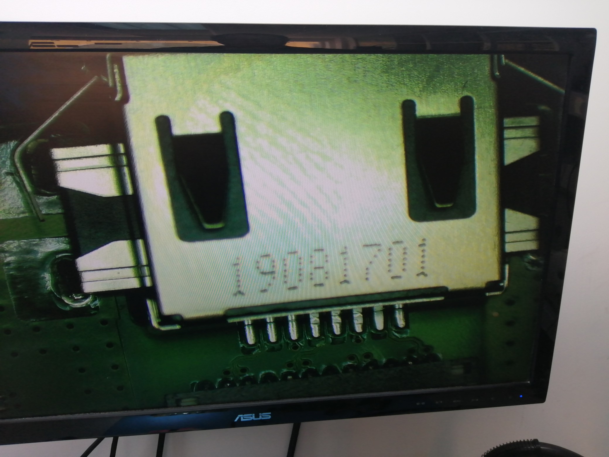

                Re: Sad tale of a PS4 - no video output

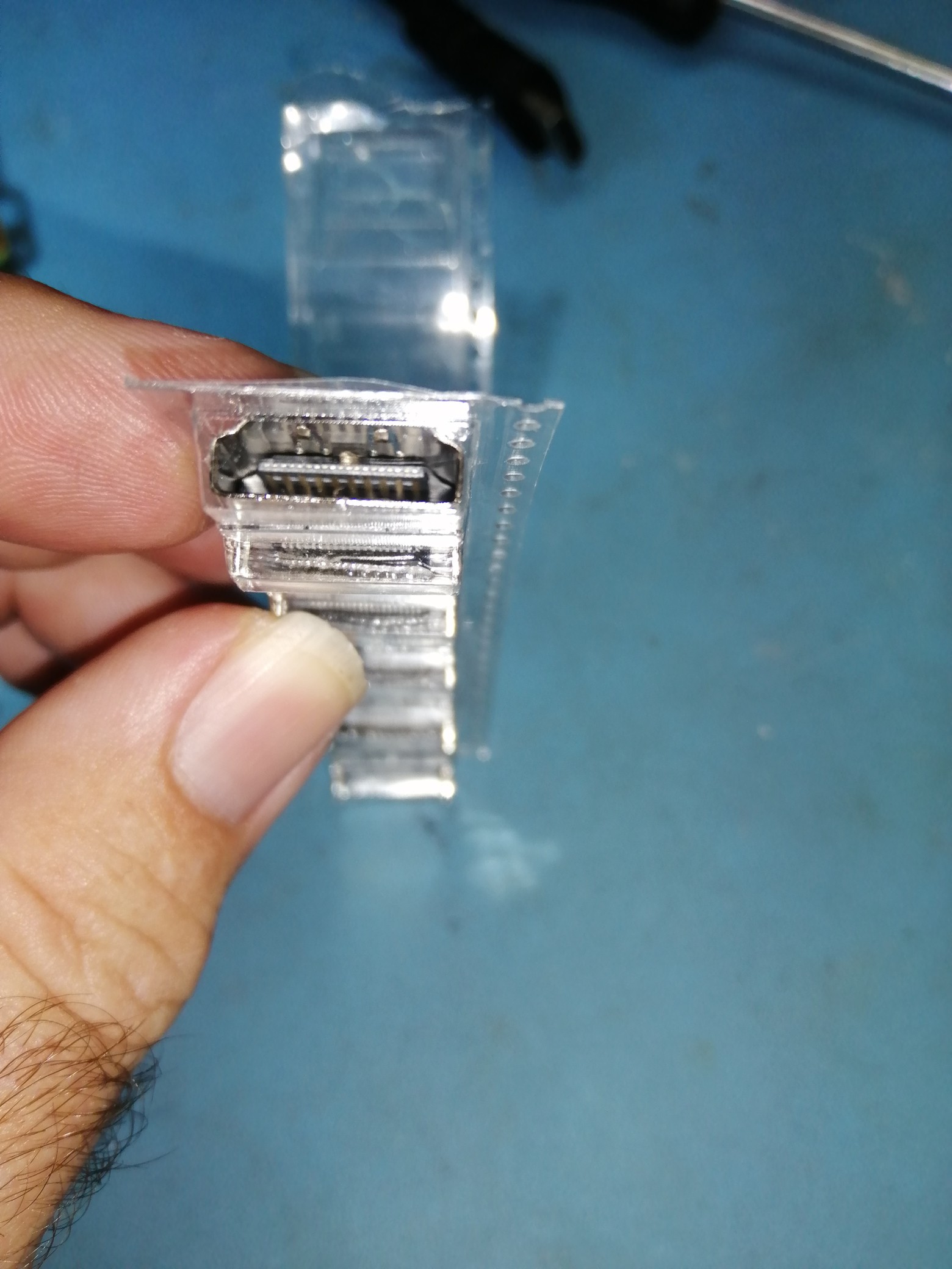

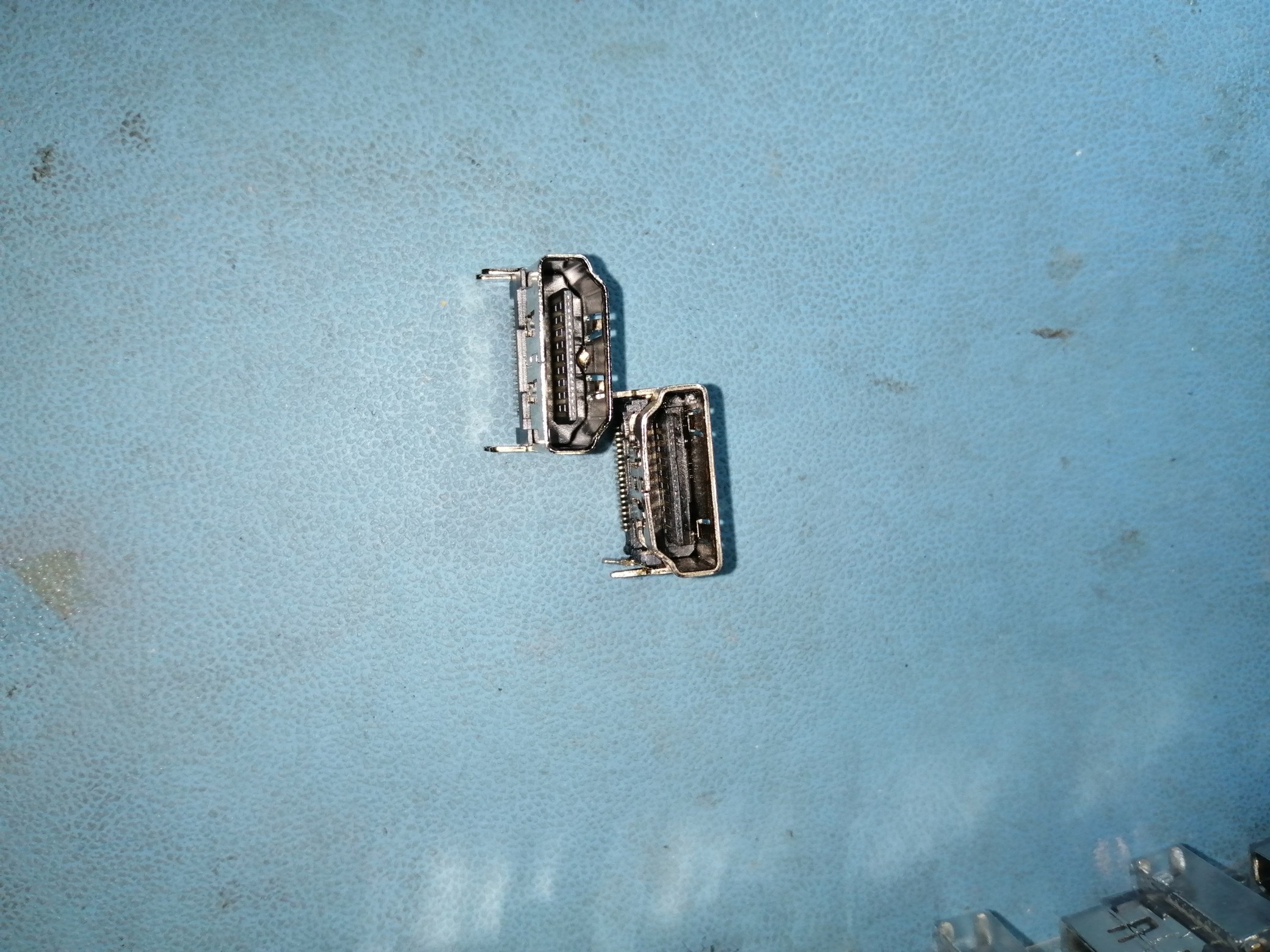

                Well this sat on my shelf for some time until eventually the owner decided she could not be bothered going back to game and asked me to look at it. At the same time the replacement HDMI connectors turned up from AliExpress for another PS4 slimline that I was looking at which had a broken connector. The results are 'interesting'
                OK so let's chat about the one with the broken HDMI connector first
                This one turned up in the middle of lockdown with a broken HDMI socket. I was able to order parts but seeing as we had no postal service it was a waste of time, so I found a connector on a scrap TV mainboard and used that.
                It was slightly different than the original connector, so I had to do a bit of work using the dremel on the HDMI connector to get the mounting pins to fit the PCB as they were too wide. It fitted OKish but I could not get the signal pins to sit properly flush to the board which made fitting it the devils own job. However I did get it to work wit ha lot of cursing and it give a picture. Unfortunately it only lasted a couple of day before some of the soldered joints gave up again so I ordered some proper PS4 slim HDMI sockets
                These ones
                https://www.aliexpress.com/item/3238...77134c4dYaZRtY

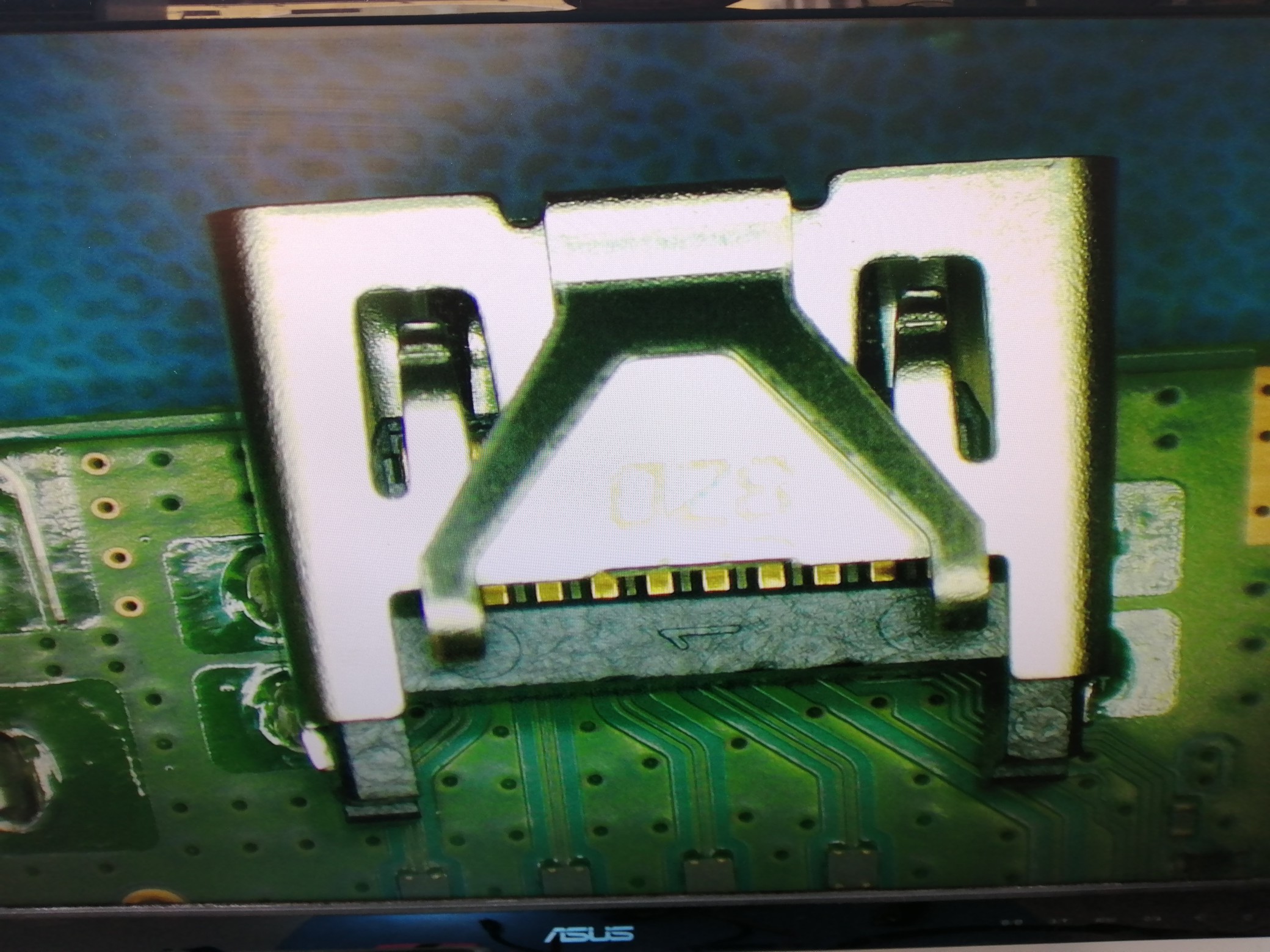

                When they arrived I fitted one of those. It did not line up with the PCB properly either, the signal pins were slightly offset so they sat directly between the pads on the PCB, but we are talking about a fraction of a millimeter,so but slightly bending the mounting pins I got it to sit right and soldered it just fine. However I no longer got a picture
                I checked all the solder joints and they were OK so I couldn't figure out what was wrong now. I ended up cutting an HDMI cable in half and making a breakout board with veroboard and header pins so I could monitor the HDMI signals with the PS4 connected to a TV. To be honest i couldn't make head nor tail of what I was seeing.
                I then decided to check continuity from the breakout board back to the HDMI connector on the PS4 board - and discovered it all looked backwards. Like the four shielded pairs of cable were at the wrong end of the socket.
                Then I finally figured out what was wrong. Comparing the two PS4 motherboards, the HDMI sockets from Ali Express - despite being sold specifically for PS4 Slim, are upside down!!! DOH! FFS!!
                I attached some pics of my lovely microsoldering and the stupid sockets!!! Guess I have to order some more sockets from another seller and do it all again,
                I'll put the other PS4 on another post with it's own pics

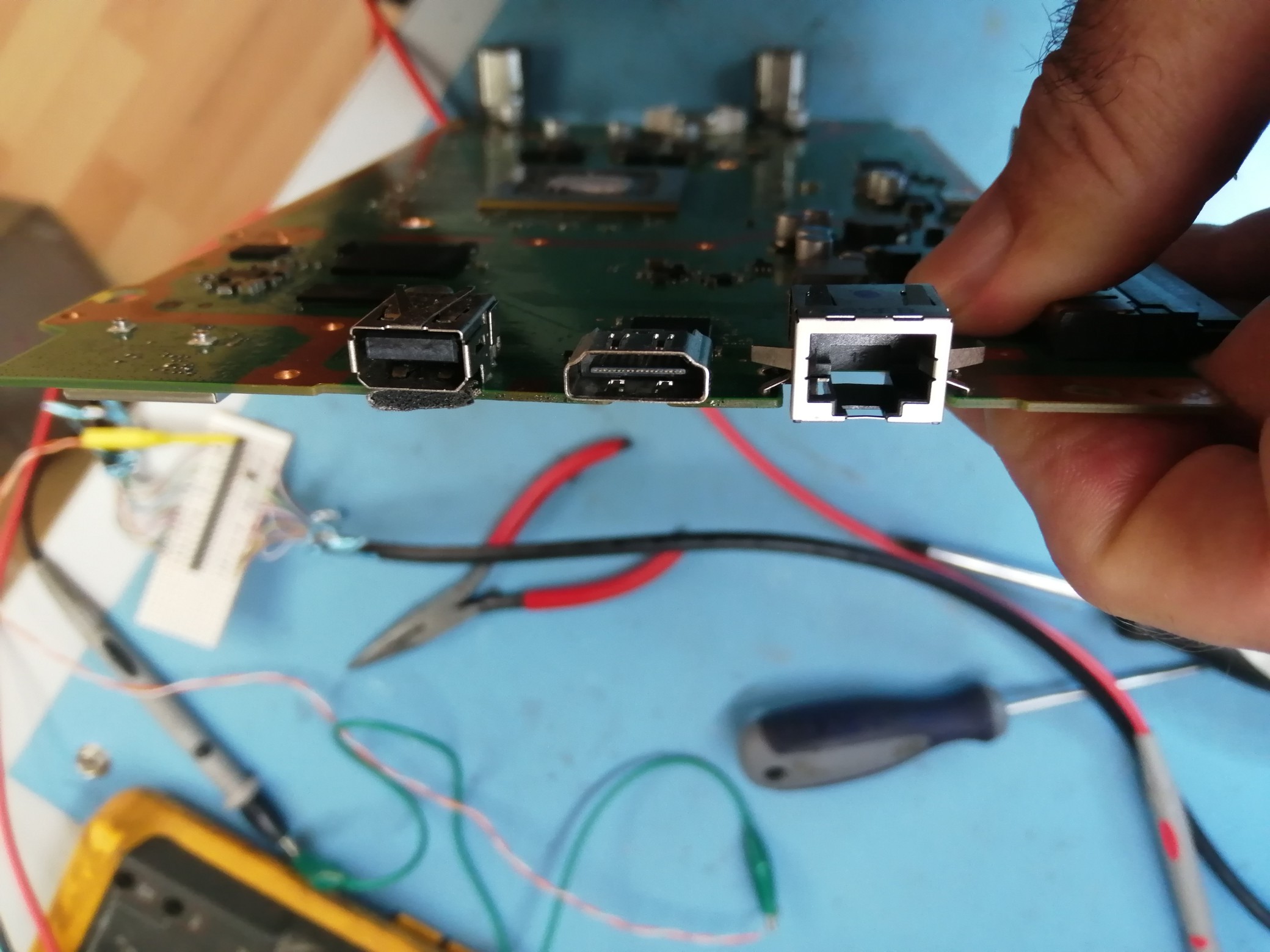

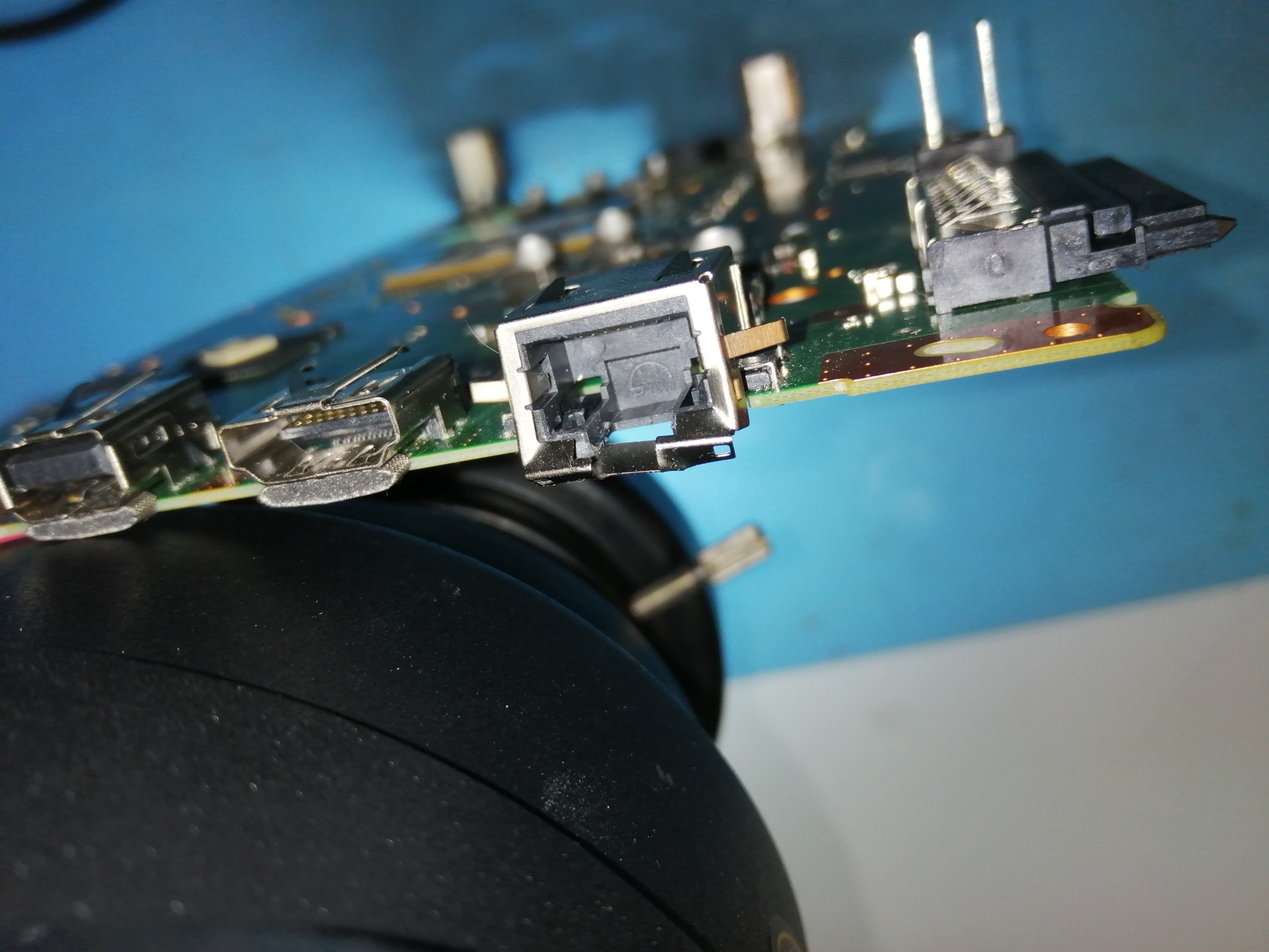

                  So onto the other one
                  This has a damaged LAN socket. It fell off the bed onto the floor. Since that incident, it poweres on, blue light goes white but no picture (exactly same symptoms as the other one I replaced the HDMI socket on)
                  So it is clearly booting up.
                  However the HDMI socket looks fine. Unfortunately it is a slightly different board to the other one and I can't check the pin continuity from the HDMI socket to the PCB, or for that matter how to fit a replacement one of the same type if needed.
                  The damage to the LAN socket looks physical, not electrical, so I am not at all sure what is wrong with this one
                  I don't have the experience wit hPS4, these are the only two I ever looked at. Are there some other known likely problems I should check for?
                        Pro and slim HDMI ports are identical.
                        Why can't you check the pin continuity ? 8 of the pins go to the filters, 3 to pads to the side of the HDMI encoder, some are ground and the last few are easy to see and trace.
                          hoho! wow... it looks like whoever made the damn sockets in china couldnt tell a land diagram on the pcb apart from a pinout diagram on the component! that explains why the connectors are upside down! they were looking at the wrong schematic when making the socket!! sigh more chinese noob phails again!
                          and when things are connected wrongly in electronics, it tends to release the magic smoke and the device no longer works... look like a hdmi chip replacement is also needed like stj said.

                            those mirror sockets are probably for xbox

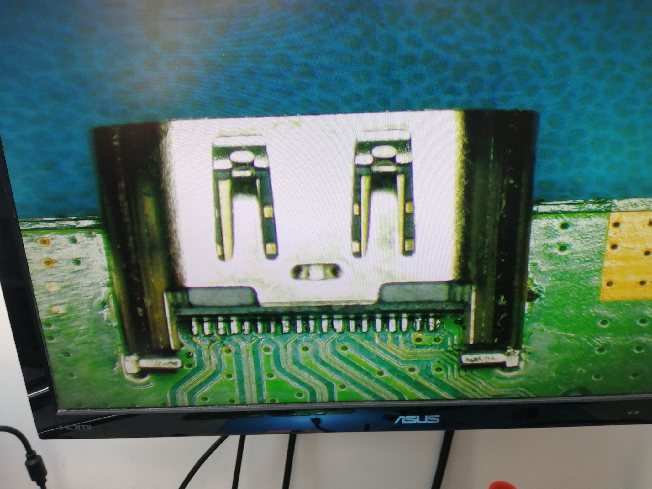

                              I know this is an old thread but nobody mentioned the HDMI port looks nackered in the pics. Looks like it was plugged in when dropped.
                                Sorry guys I forgot to reply to this one to complete the thread
                                I ended up with two PS4 slim, both with faulty HDMI sockets. The one where I thought there was a plastic cover over the pins, the socket was actually broken - like has been said it must have fallen with the lead still inserted and pushed the inner parts of the HDMI socket backwards, breaking it.
                                Once I got the correct type of socket, I fixed both of them and they are working fine this last couple of months. Fitting the upside down socket didn't actually do any damage to the PS4.
