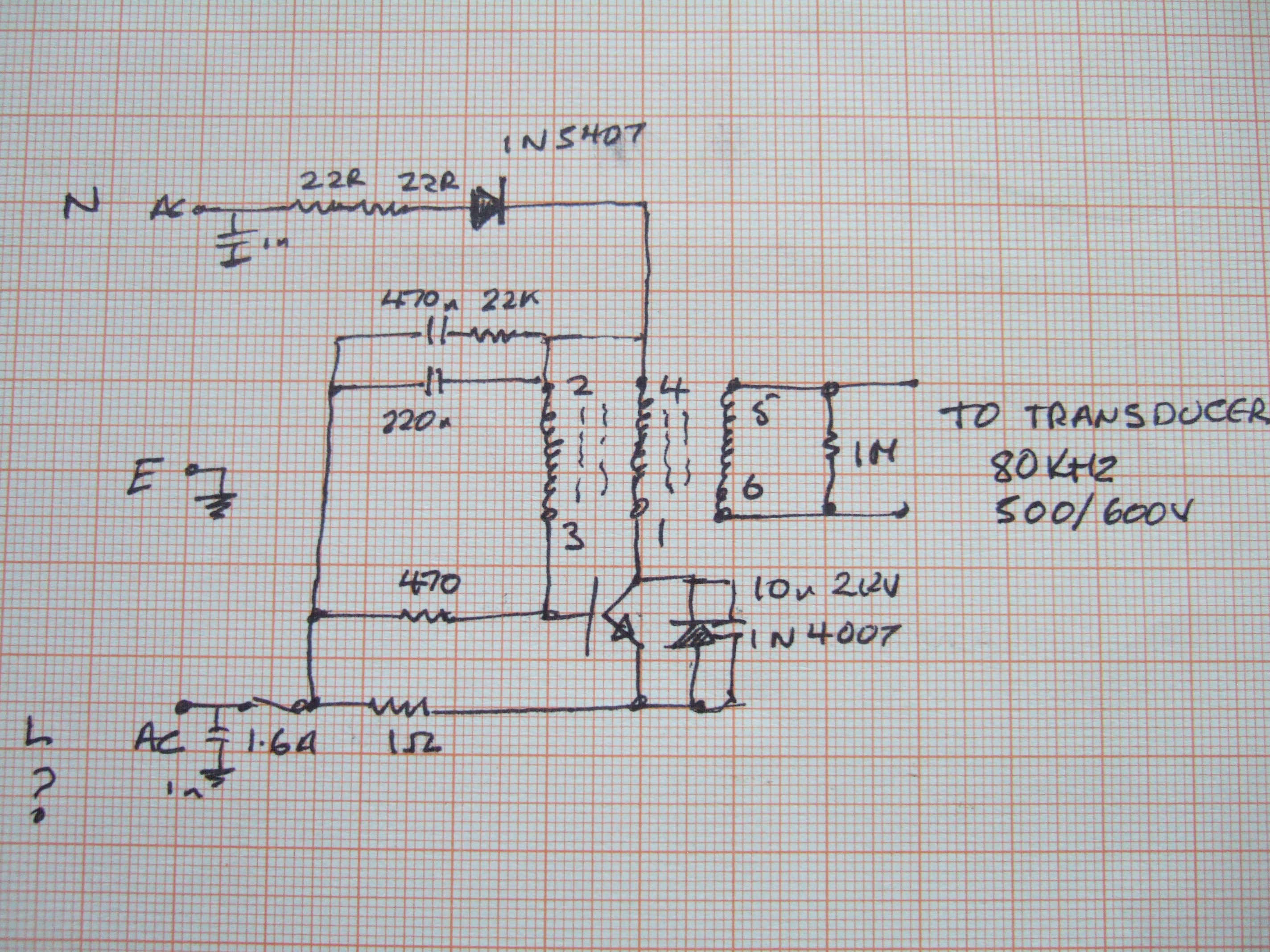

    Ultrasonic Bath
    Circuit for an Ultrawave bath ,the recovery diiode was short circuit.

    Re: Ultrasonic Bath
    check the film capacitors - i'm starting to see more and more of them dropping in value on mains circuits!
