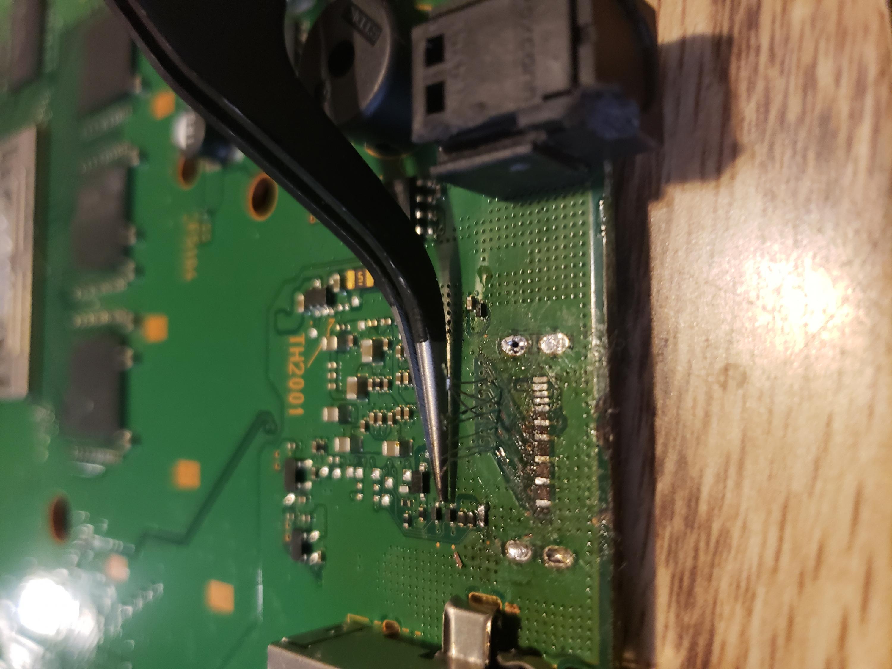

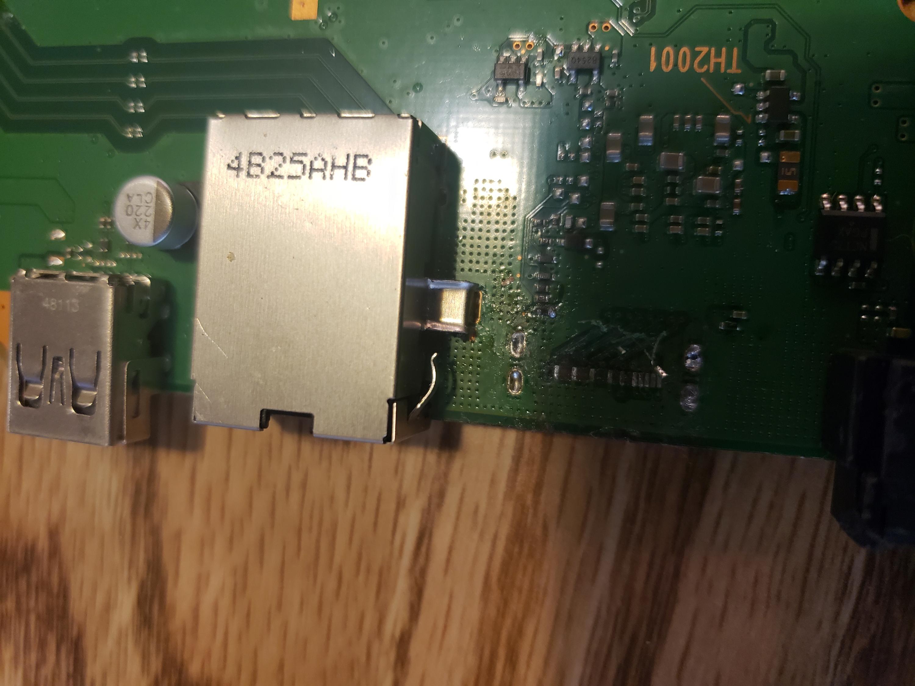

    PlayStation 4 hdmi port board wire's came off
    So long story short a buddy of mine tired to repair is ps4 hdmi port because it went out but keep missing up so he brought it to me and asked if i could fix it. When i was trying to removing the old hdmi port, i notice that the wire's where coming off of the board with the hdmi port (please see attachment). so my question is, is there anyway to fix this or is this just a parts board now, and there nothing I can do? any help is greatly appreciated. also been looking for a replacement but no one just sell's the board.

    Re: PlayStation 4 hdmi port board wire's came off
    https://www.youtube.com/watch?v=ynf3pqROHOk&t=71s
      thank you!!! well have to try this out after i get all the supplies
