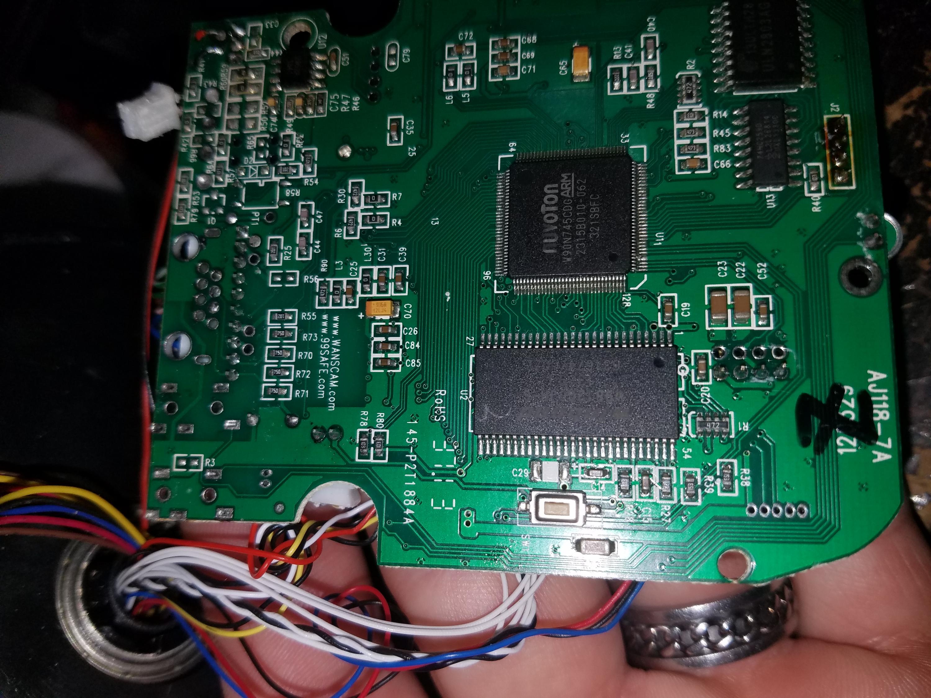

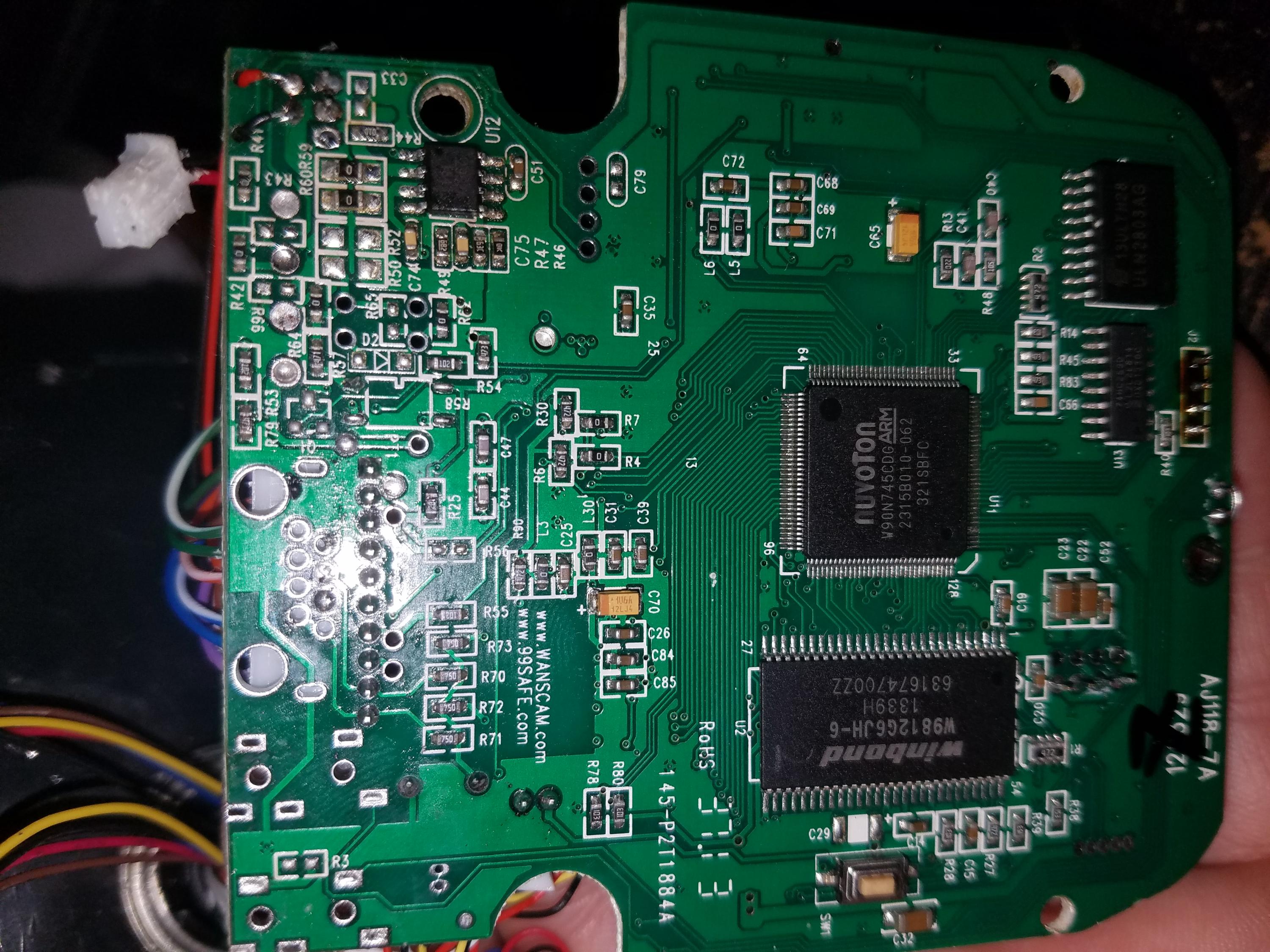

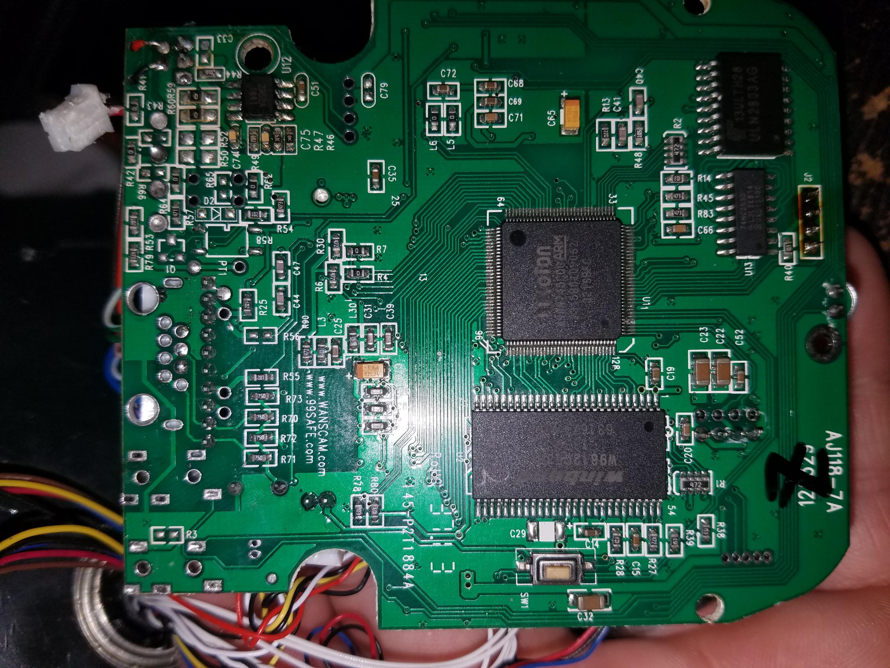

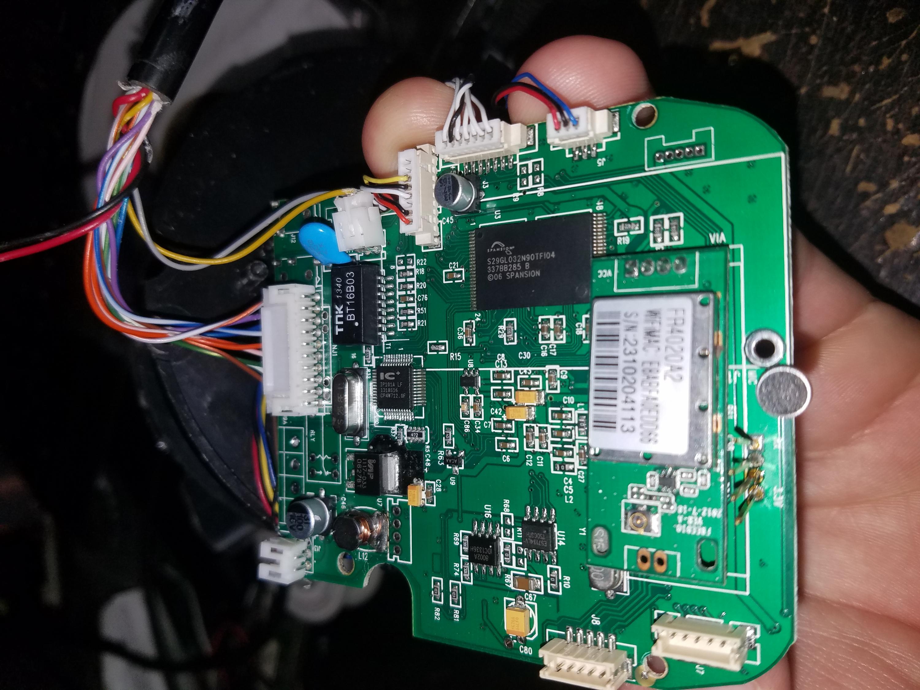

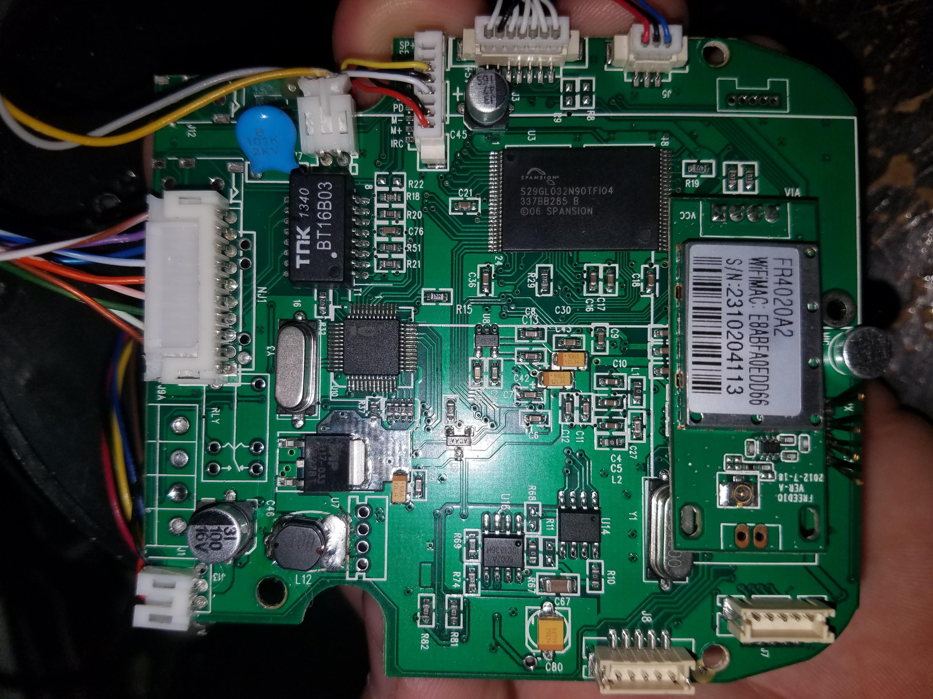

    This is an unknown IP camera. Most likely a Wanscam clone, PCB has www.wanscam.com silkscreened but board design doesn't match any known boards in the google database.
    Board ID#: AJ118-7A
    CPU: Nuvoton W90N745CDG
    RAM: Winbond W9812G6JH-6
    Flash: Spansion S29GL032N90TF104
    So this camera worked fine until I installed it on the house. Its non-POE, so I ran two cables (ethernet and power) power was terminated on each end with barrel Jack's, positive to center electrode. 200% sure it was wired correctly. Unit was powered with the same 12v 1.5A brick that it was supplied with, and what I used for bench testing/initial setup.
    The only LEDs on this unit are a red and amber on the ethernet jack on the end of the cable.
    Once installed, unit would show the Green LED, but no amber. My POE switch showed 100M HALF DUPLEX. Ethernet cable tested good, I was also able to plug my laptop into the same run and establish a connection.
    I then powered the unit locally with a mains extension cord. This time the green and amber LEDs lit, but did not request an IP from the router. A packet dump of the interface shows ZERO packets being sent from the Camera.
    Removed camera from its installation, tried again on the bench. Both LEDs light, again no ethernet packets sent.
    This unit has an unpopulated serial header. Verified the TX and RX pins on the header are connected to the UART0 pins on the SoC. Connected my TTL<->USB converter to the serial header on the board. Powered unit on. No serial output AT ALL (Tried at 115200 and 9600).
    At this point I'm out of ideas.

          Okay, so:
          The 2952A IC:
          Pin 2 (Input) - 12.23 vDC (same as wallwart output)
          Pin 3 (Output) - 5.18 vDC
          There are two 1117 regulators on this board.
          1117-D33 (TO-252):
          Pin 1 (ADJ/GND) - GND
          Pin 2 (OUT) - 3.27
          Pin 3 (IN) - 5.01
          Tab (OUT) - 3.27
          AMS1117 (SOT-223):
          Pin 1 (GND) - GND
          Pin 2 (vOUT) - 3.28
          Pin 3 (vIN) - 5.01
          Tab (OUT) - 3.28
          Also recheck the UART port whith an oscilloscope to see if the CPU is really doing something or not. You should find one pin where there is some data running.
          I don't have an oscilloscope. I do have a USB-UART board that registers on the computer as a serial port. I've used it in the past to communicate with routers.
          On this board, RX and VCC are clearly marked. Google brings up convincing pinouts for this type of camera. The only thing I'm unclear about is the RX labelling being receive for the camera, or receive for the device attached to the camera - I'm taking a leap that the USBUART TX pin should attach to the camera's RX pin.

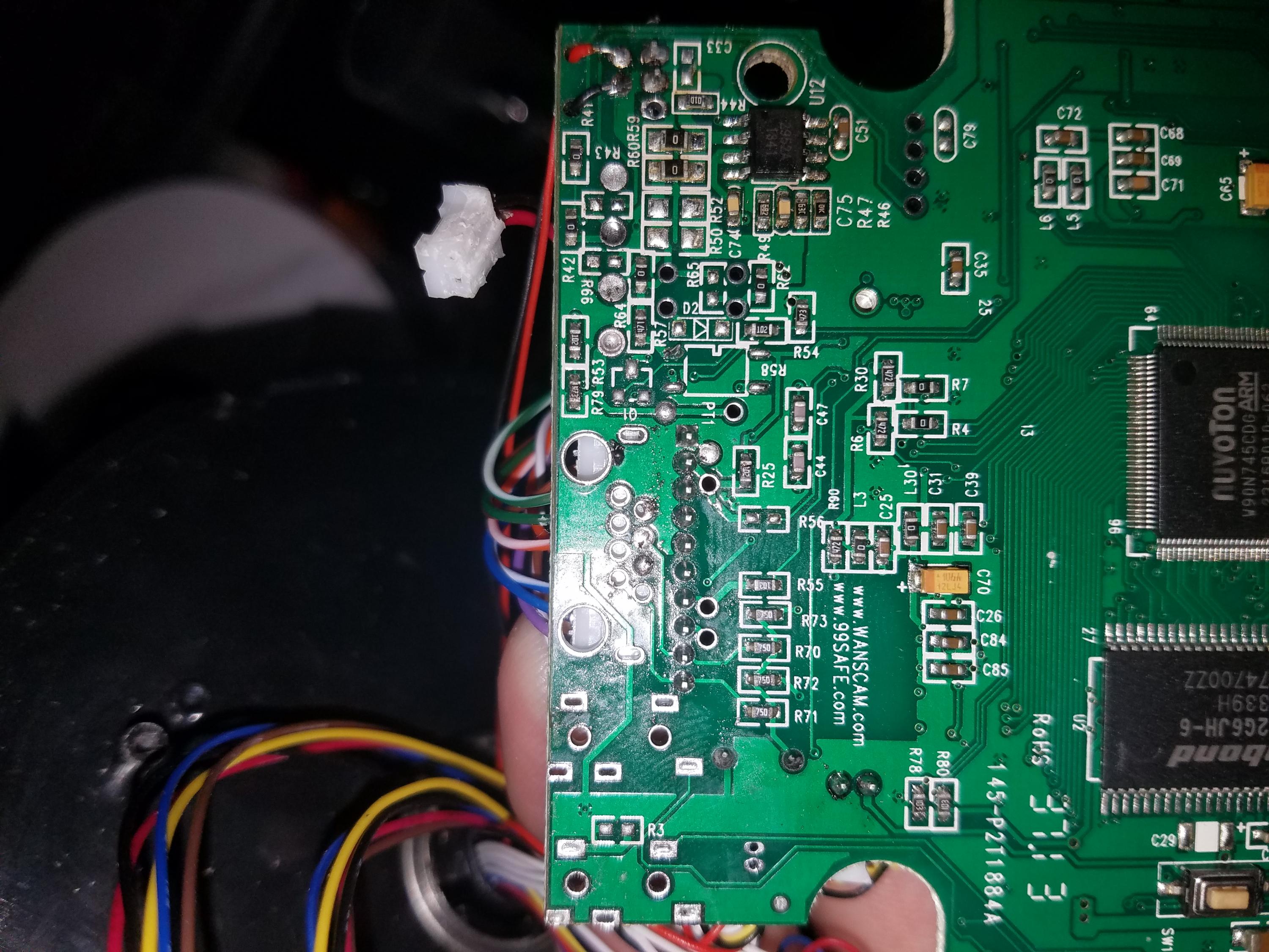

                      Decided to revisit the pinout of the UART pin header "J2".
                      I have four pins, but only two of which are labelled:
                      J2-1 is labelled 3.3V
                      J2-2
                      J2-3
                      J2-4 is labelled RX
                      The RX pin is also significant because it's got a square pin pad and the others have circular pads. Is the square pad supposed to be JP2-1, or the pin beside the "J2" silkscreen?
                      This would imply that the two unlabelled pins would be TX and GND
                      When probing the pins with a DMM attached to a known ground plane,
                      J2-1 (3.3V) - 3.27vDC
                      J2-2 (unlabelled) - 0v
                      J2-3 (unlabelled) - 0.41-0.43 vDC (fluctuating)
                      J2-4 (RX) - 3.26 vDC (steady)
                      I think it's odd that the RX would have steady voltage. Does this signify anything to you guys?

                        GND is the easiest to find. The 3.3V rail we don't need, since you power this thing externally. RX is marked and the TX is usually next to the RX pin.
                        Basically you should have RX, TX, GND, 3.3V.
                        All you'd need is RX, TX and GND.
                        I was hoping you see valid data on the RX pin, but you reported that you got rubbish at 9600 8,n,1 and @ 115200 8,n,1. No flow control.
                        To me rubbish data means that you need to reset or reflash the firmware / clear the NVRAM (if you could get the UART to work properly). Try setting the com port on the device manager, not only on the serial program.
