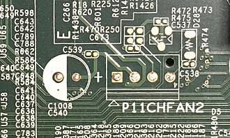

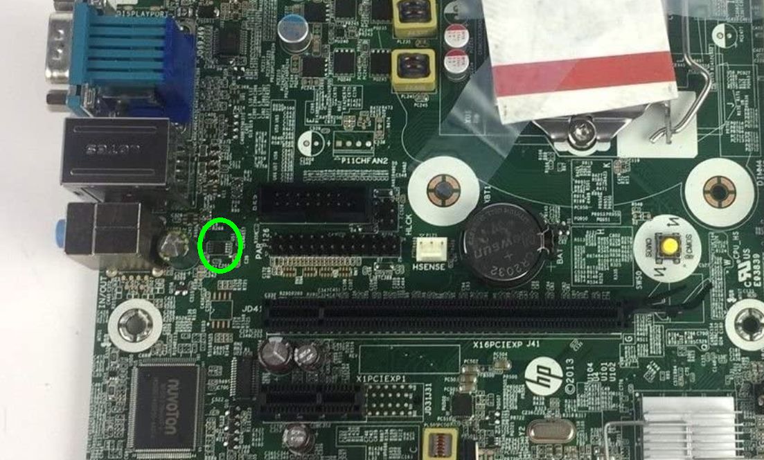

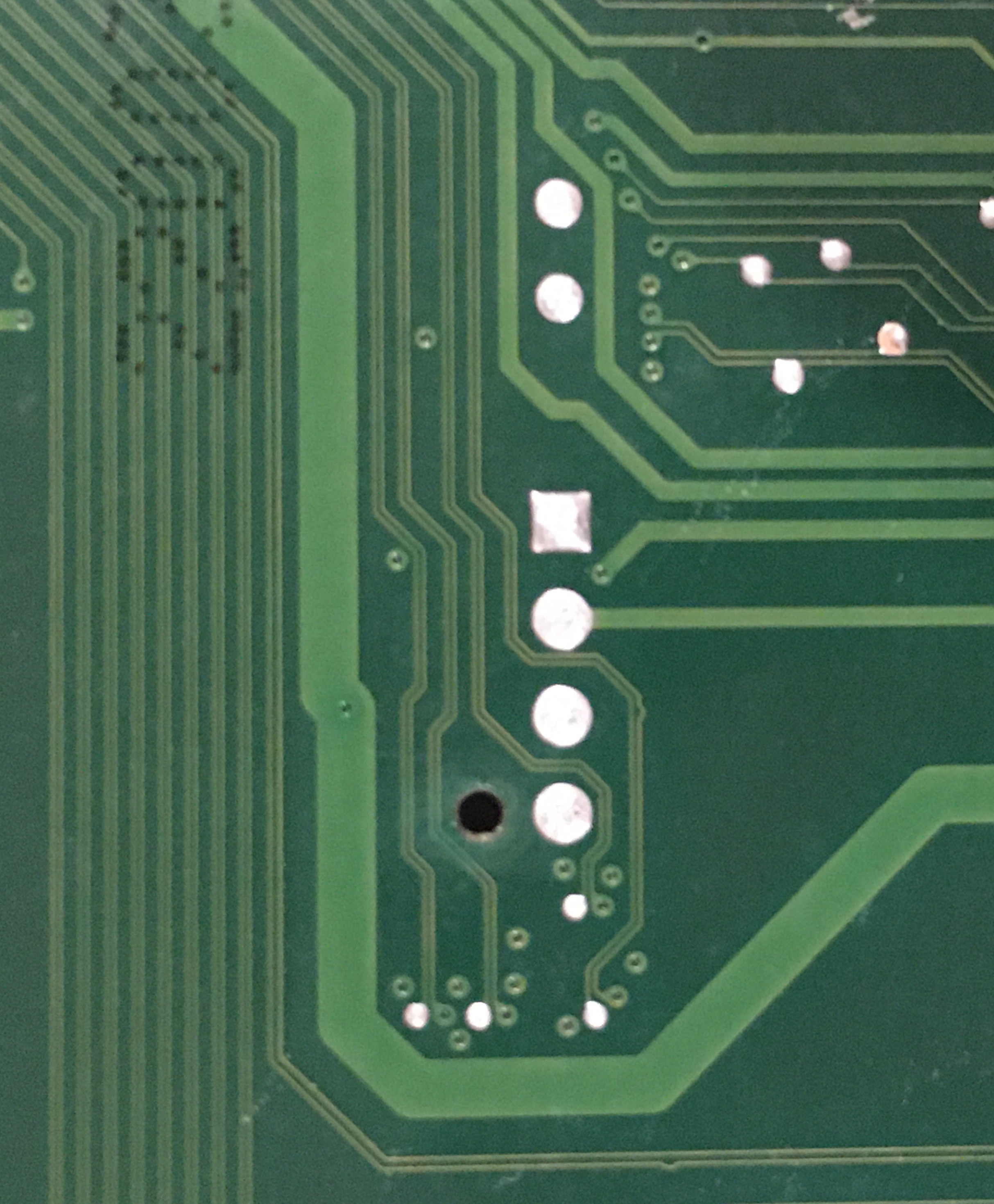

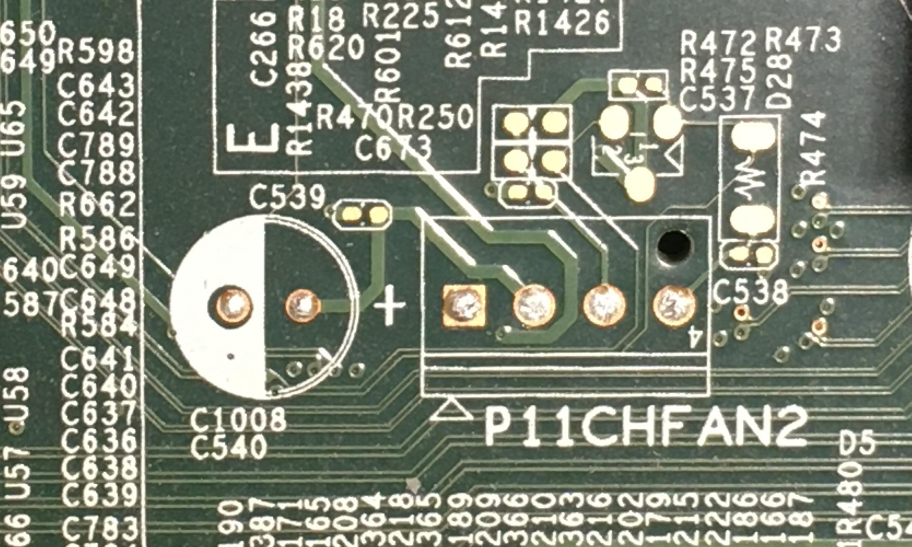

    So the HP EliteDesk 800 G1 SFF has only one fan header on the whole motherboard, a 4 pin cpu. There is a second chassis fan header, but it is not installed, there are just 4 bare through holes and some silkscreen.
    Click image for larger version  Name:	CHA FAN.jpg Views:	178 Size:	495.3 KB ID:	2245116 Click image for larger version  Name:	IMG_3265.JPG Views:	167 Size:	982.3 KB ID:	2245117
    Other models like the tower version of this computer have the chassis fan header installed, so I was wondering if it was possible to solder in a new 4 pin header.

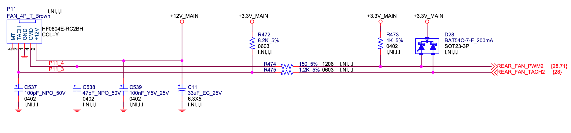

    There is some surrounding circuitry, and I think it is identical to this schematic. The CPU fan header circuitry matches exactly except for one filter(?) cap, and the chassis circuitry even has the same component numbers.
Name:	Screen Shot 2022-07-13 at 5.42.21 PM.png
    (the net REAR_FAN_PWM_2 leads to a SIO chip, so it *should* exist...)
    IF I was able to solder a spare header and the surrounding resistors/caps/diode, would this fan header even work?
    If anyone has any experience soldering to a motherboard, I'd love to hear your input!
