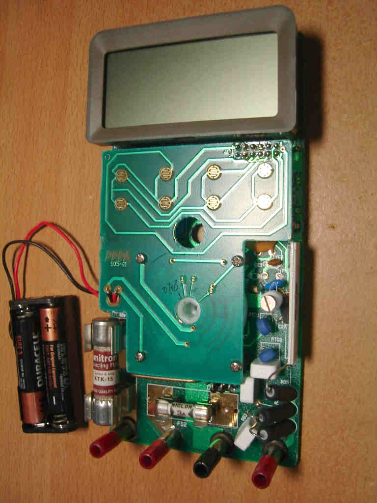

    Dear Badcap Members,
    I have Multimeter Iso-tech idm 105, it was working yesterday, I changed the battery,
    but it's not displaying anything know,
    Anyone has the same issue ? What's wrong with it ?

    Re: Multimeter Iso-tech idm 105?
    bad new battery maybe ?

      I would make sure the battery holder is not corroded, batteries OK not backwards, and power travels through the screw/spacer from the switch PCB to the main board. There's different knock-offs of this model DMM.
        battery holder is corroded,
        I put extra solder on battery and now it's working, but let's see if it's stable...
        Thanks for the message
          Clean corrosion. I think you use vinegar and baking soda to neutralise.
