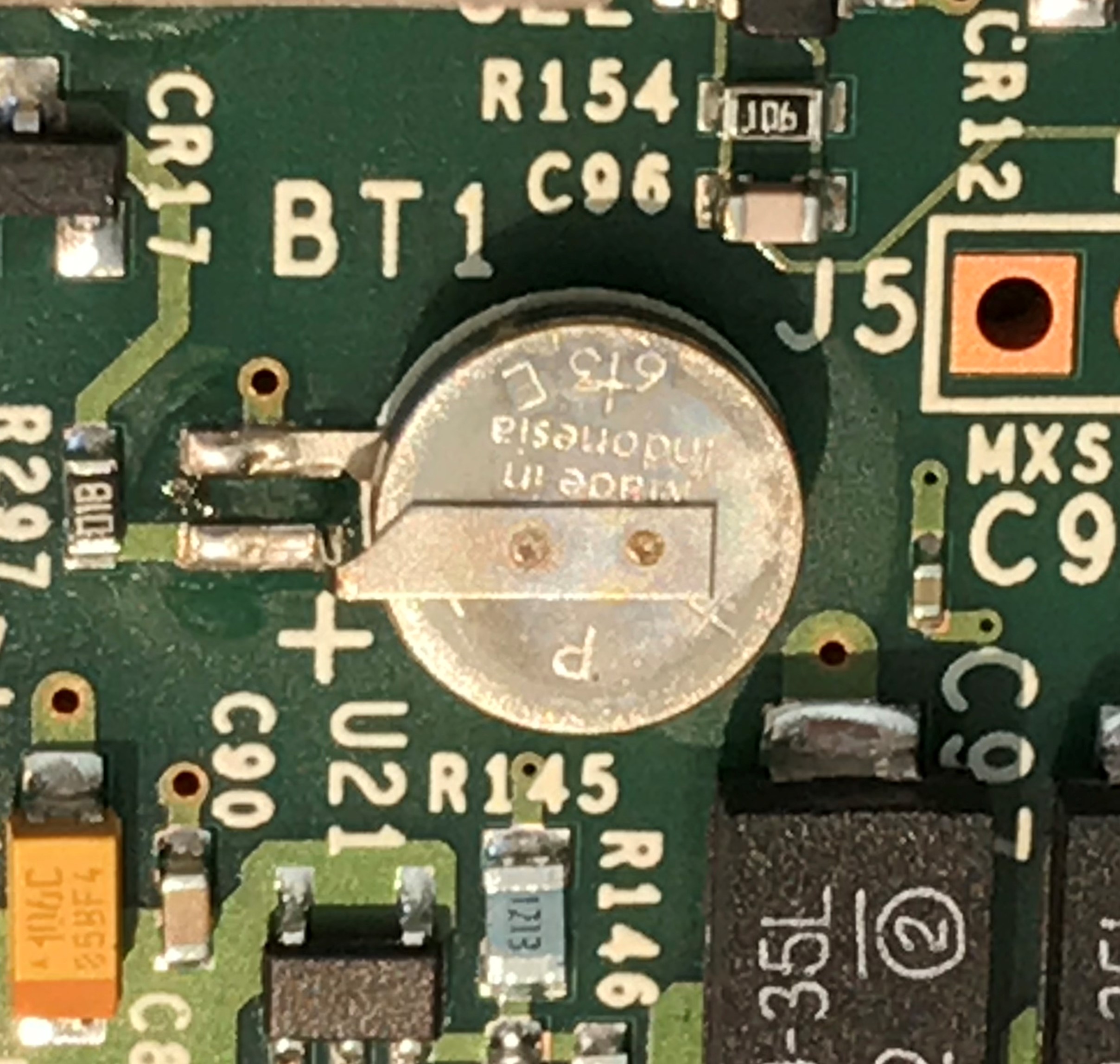

                        Re: Fluke 289 bad supercapacitor replacement repair
                        Could you help me please:
                        how long Fluke 289 should keep Date without AA bat?
                        and which another brand of supercapacitors can be used?
                        or could I put a special same size battery instead of supercap?
                          If you take the battery out, wait a minute and put the battery back in and the 289 lost time and date, good chance that the supercap is leaking physically. A new supercap held the time and date for 3 hrs no problem. As a size requirment: Everything goes as long as it can fit. The only thing to watch for is the rated voltage. For some reason most 3.3V supercaps I came across were SMD, but I surely would not use a 5V supercap in there. Swapping in a battery depends on the battery chemistry you want to use and then have to mod the circuit somehow. I see that my original solution isn't anymore available. At least not here.
                            My Fluke forgets the Date after 4-6 hrs (during I am charging 6xEneloops due to I have just 4 slots for charging AA) but it keeps Date at least for a few minutes if I just change old AA for new ones. I have not checked the exact time.
                            Are you suggesting opening Fluke for revision of supercapacitor's leakage?
                              do a test and take them batteries out for 15min, 30min, 45min and an hour... see what happens... My 289 is old. The new 289 doesn't have a supercap anymore. They changed them to a battery. I charge my 6 eneloops in one swat (bigger capacity charger).
                                I charged my batteries for one hour and I've lost the memory. Set time and date appeared again. So my supercap that I replaced in 2018 went bad again.
                                I did look at the newer 289's and they have a battery with an SMD resistor marking 01B (1k ohm) in series with the positive side of the battery. I may take my supercap out, add a 1k ohm resistor and put a small 3V coin cell battery in. That should fix that.
                                That image I borrowed is from Terry01 from eevblog. Thanks man! It saved me running to work and taking theirs apart!
                                  I measured the voltage it is about 0,9V
                                    It's done for. Well... I guess I am sitting in the same boat again and looked around to see what is suitable right now for me and didn't find anything in the supercap section as an available drop in to buy. I'll keep looking...
