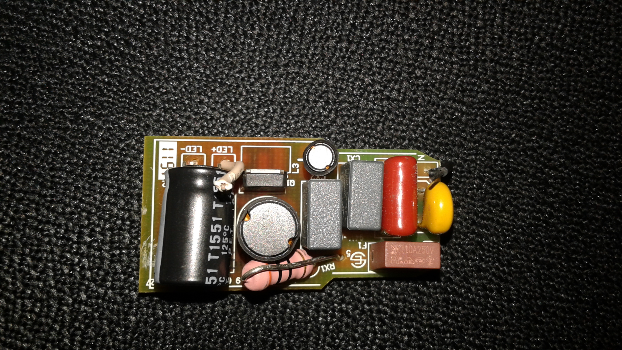

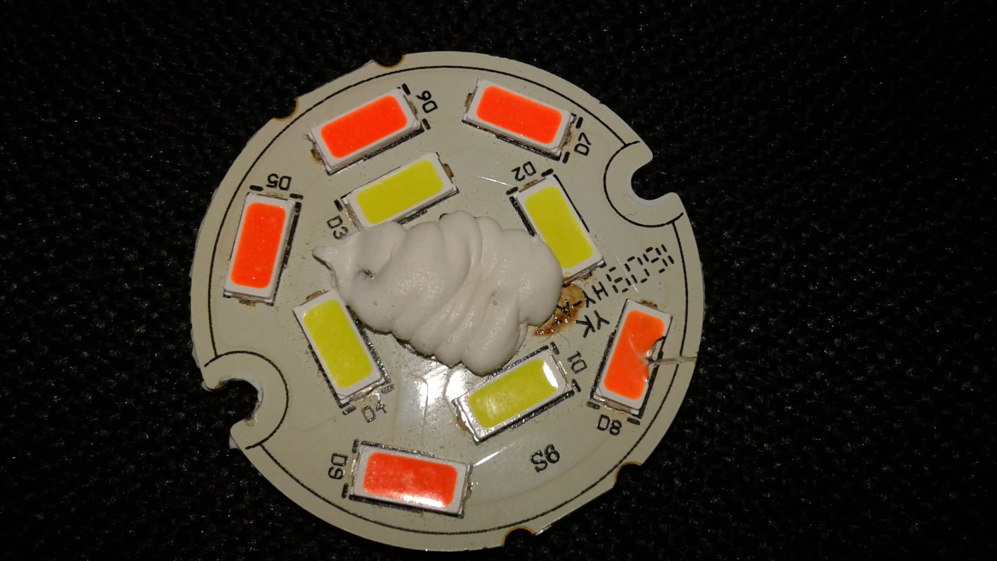

    Hello, i have a dead feit LED lamp and looking at it, it looks like the LEDs had failed which is not that much of a surprise since the lamps were 2 dollars a piece.
    But it's the driver board that surprise me because i was expecting 0ne of three things either...
    One: The manufacturer cheaping out on some parts.
    Two: The output cap being something cheap [like samwha]
    Three: The driver board having completely blown to bits.
    None of that seems to be the case as the board has a fuse to prevent it from blowing up.

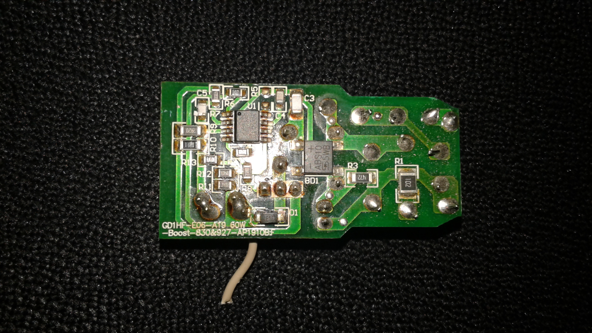

    2 Of the capacitors are X2 capacitors which i'm pretty sure makes them safety capacitors.
    The output capacitor is a 18uf 250v capacitor and it's a rubycon capacitor
    The rubycon cap is part of the LEX series of capacitors.
    The driver chip is an AP1910 'Universal High Brightness LED Driver Controller'
    You can look at some pictures that i took of the driver board.
    I'm not a expert, I'm just doing my best.

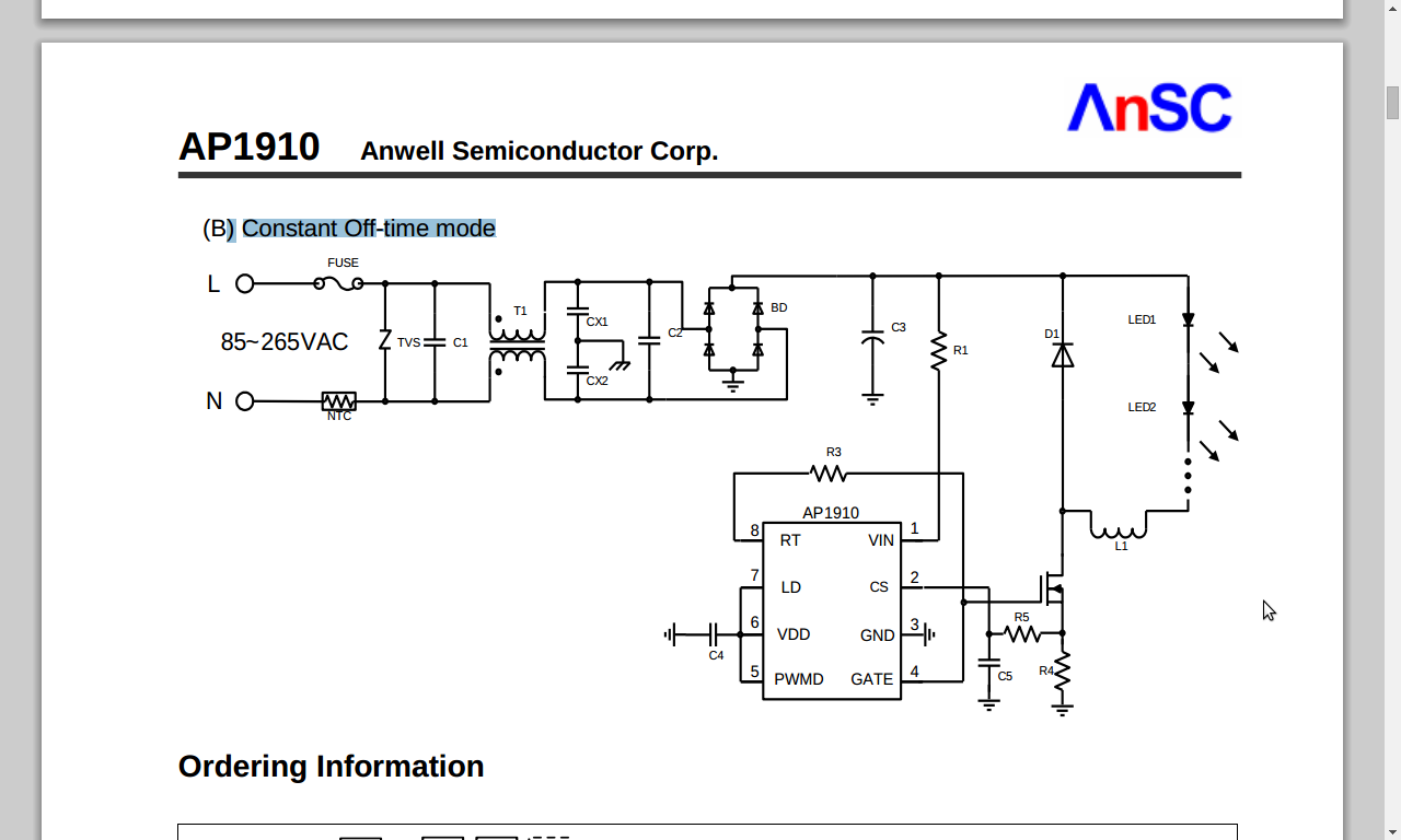

        Thank you ruky con: from your autopsy. I've found AP1910 is good for building A poorman LED tester II, or to be drive LEDs.
        The AP1910 is a high-efficiency LED driver control IC. It drives LEDs with constant current and uses
        fewer components. The AP1910 is an open loop, current mode control IC.
        The AP1910 is a low-cost buck, boost or buck-boost converter controller specifically designed for driving multi LED strings or arrays. It can be operated from either universal 90~264Vac or DC voltage between 20 and 450Vdc. The AP1910 can also drive multiple strings of High-Brightness (HB) LEDs. The AP1910 could regulate constant current to ensure controlled brightness and spectrum of the LEDs. Constant current driving method can also improve LEDs lifetime. The AP1910 supports soft start function to reduce inrush current.
        What's the advantage of constant off-time mode.
        PWM is the basic standard control method. Constant on-time has the advantage over PWM that switching frequency is reduced under light loads, which improves efficiency because the switching loss is lessened. Constant off-time has the advantage that it helps keep the converter in continuous conduction mode, which reduces ripple amplitude and noise.

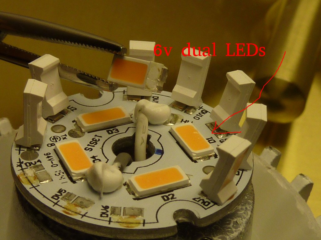

                No worry( No preocupación), We're gonna find it all over the dumpster, the landfill in the future.
                The lamp has The 14 LEDs are in series. Those are 6v dual LEDs, they also be used in edge LED TV. Saved those for the future. 6v x 14 LEDs= DC 84v to drive...........

                  The lamp has The 14 LEDs are in series. Those are 6v dual LEDs, it also used in edge LED TV. Saved for the future. 6v x 14 LEDs= DC 84v to drive it............
                  Mine has 9 LEDs in series similar type to the LEDs in the picture.
                  Note: i accidentally damaged an LED opening this which i later realized was the faulty LED.
                  And i think this type of LED is a 5050 LED.
                    I was wrong it's a 5630 LED.

                        6v x 14 LEDs= DC 84v to drive...........:
                        5630 LEDs have a operating voltage between 2.8 to 3.4VDC. So if you run them all off 6VDC you will kill them pretty quickly.
                        2.8 X 14 = 39.2 or 3.4 X 14 = 47.6

                          Can you please test them see what operating voltage are? But over here, this Feit lamp is driven by constant current. (......Constant current driving method can also improve LEDs lifetime......)
                          Theoretically AP1910 can drives any number of LEDs by change MOSFET and different kind of LEDS by changing R4. We can make it to drive whole LED panel or 1000 series LEDS. I am gonna collecting them to drive my junk led panel as a LED fluorescent light tube with Dimming function. Why? because Ap1910 wholesale only no retail.
                          AP1910 is made by Anwell Semiconductor Corp.(Taiwan)

                            For some reason the LEDs would not turn on no matter how many volts i put through them but i did have a other LED lamp that had the same type of LED and i did get them to light up at 3 volts.

                                      I want to see how the driver board works...
