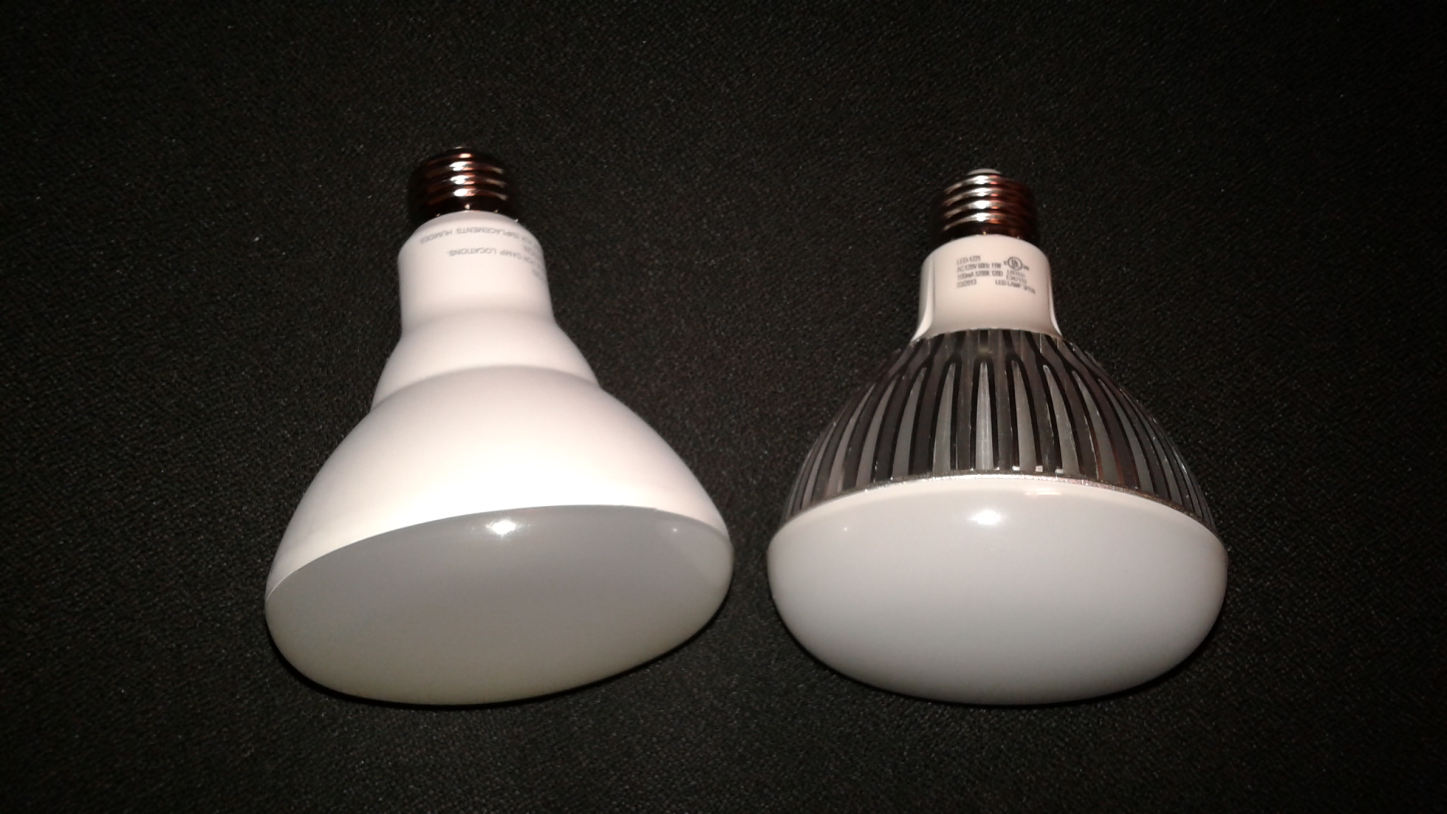

            I have a older LED floodlight that you can tell is made to last.
            Here it is next to a newer feit floodlight.
            The one on the left is the feit lamp.
            The one on the right is a 'Light Efficient Design' brand lamp.

                  For the feit floodlight i have the body of it is 100% plastic.
                  But for my A19 lamp the body was made of aluminum.

                      The feit floodlight i was showing you feels too light to have any heatsinking at all.

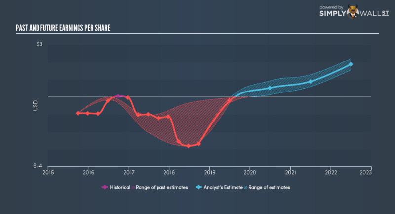

                                  Cree seem to have bailed on residential light bulbs, I can't find them for sale in town. It's too bad they don't stay in a market and keep bouncing around.
                                  Cree has never been profitable Forecasts are for them to make lots of money in a few years, but.. competition.
