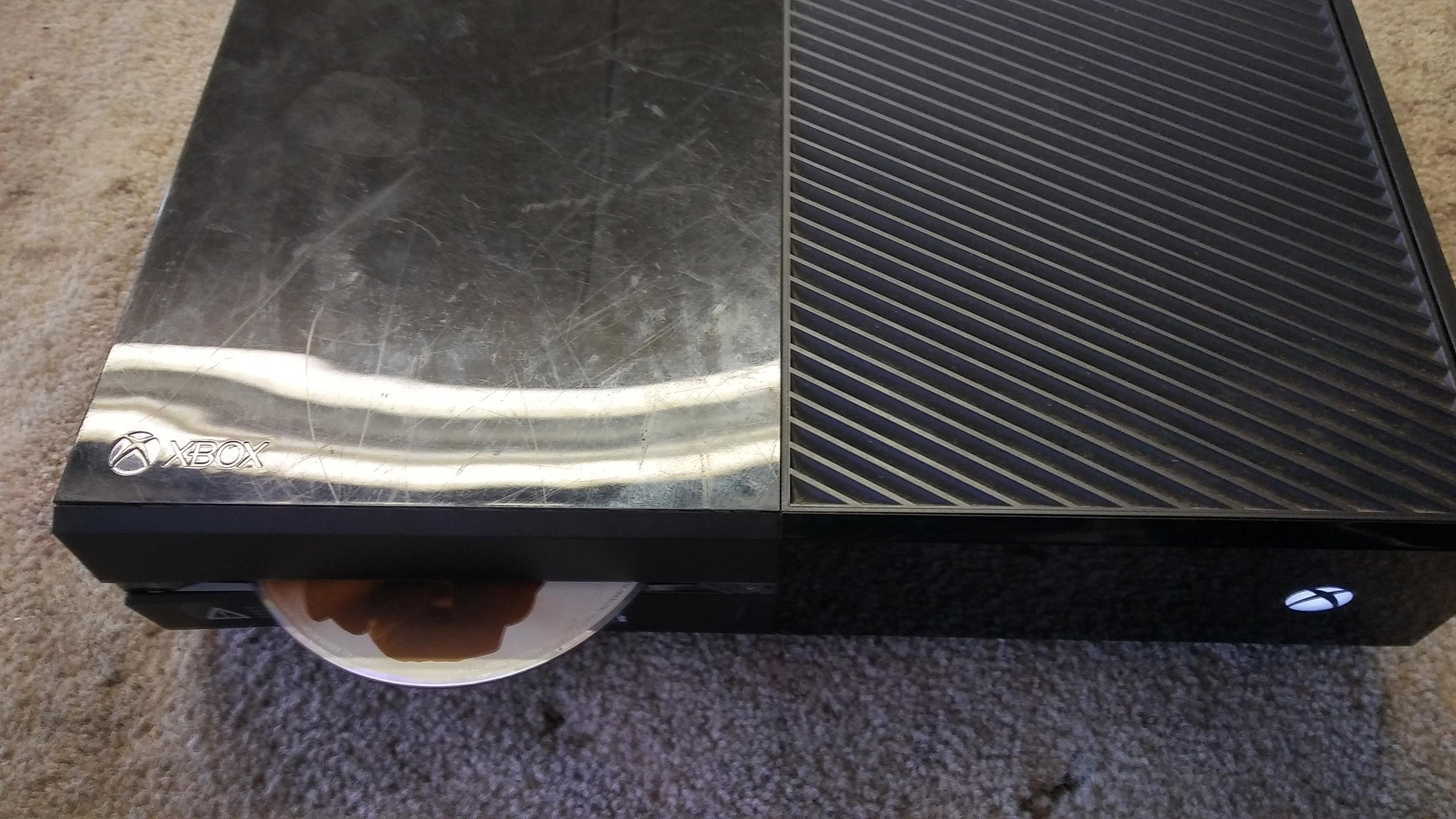

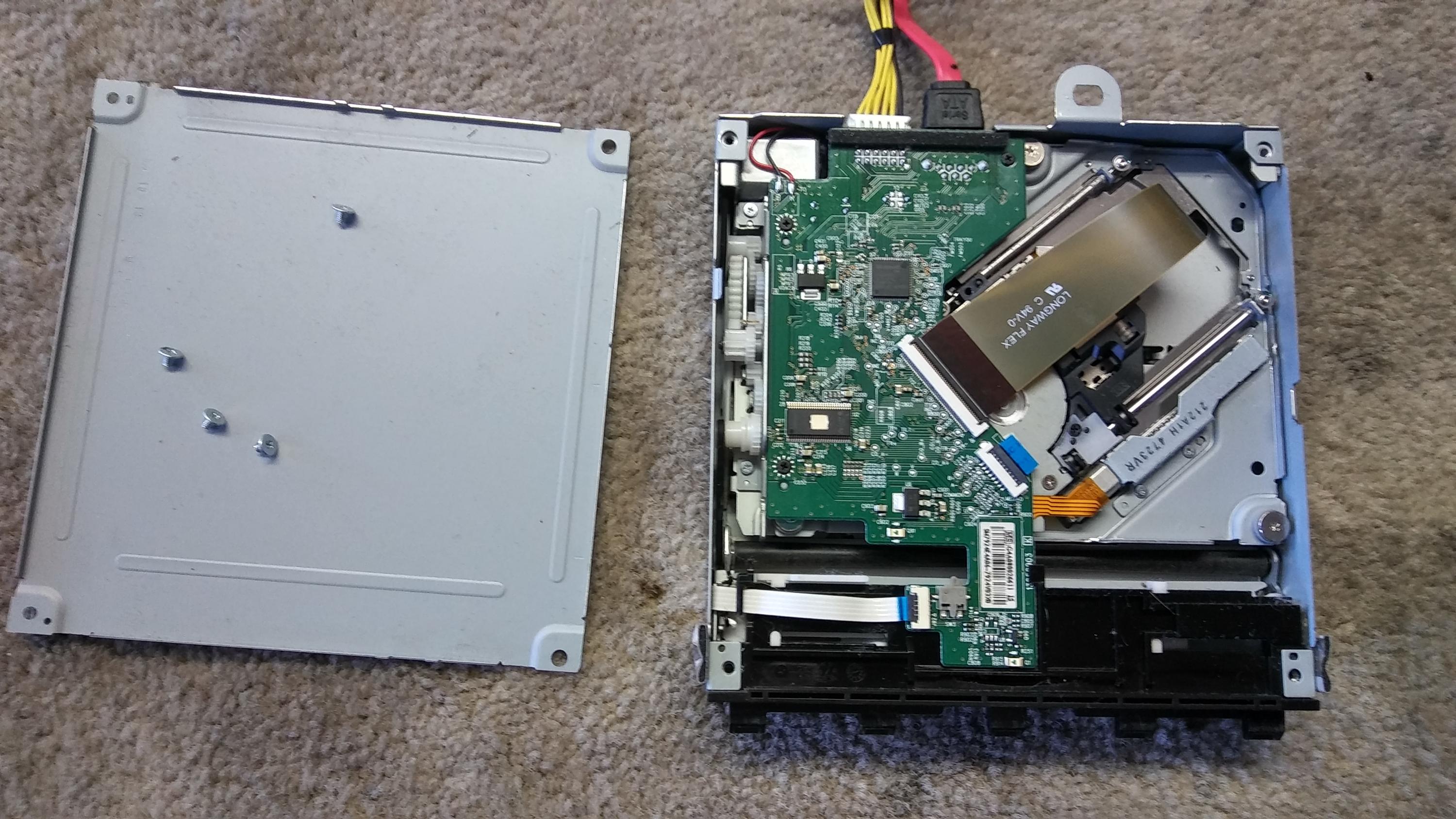

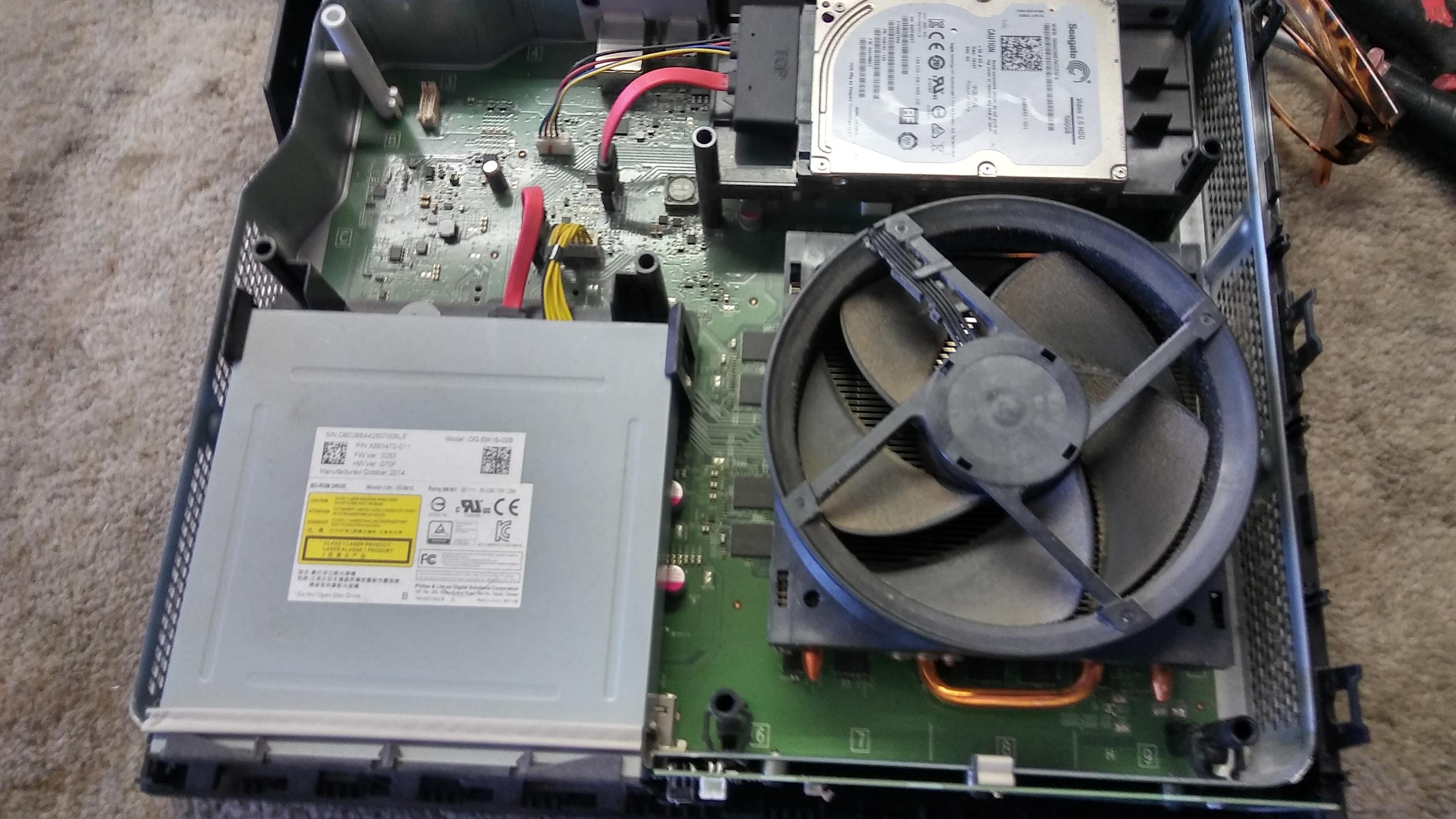

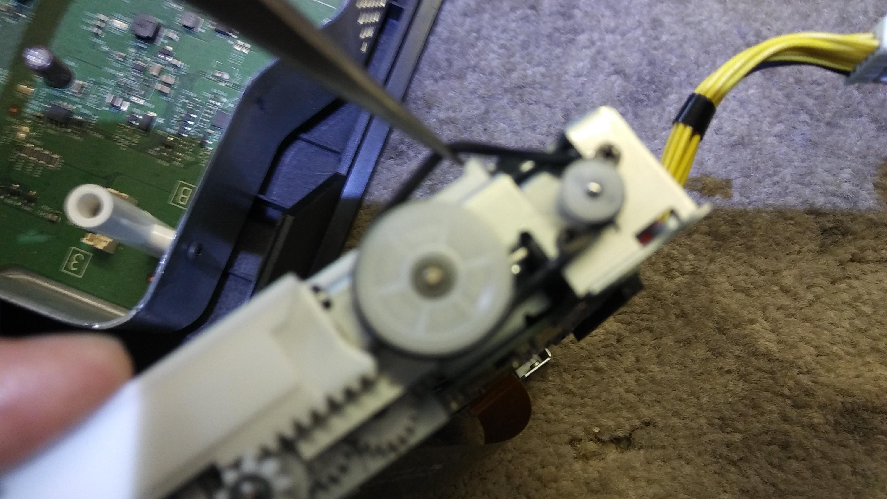

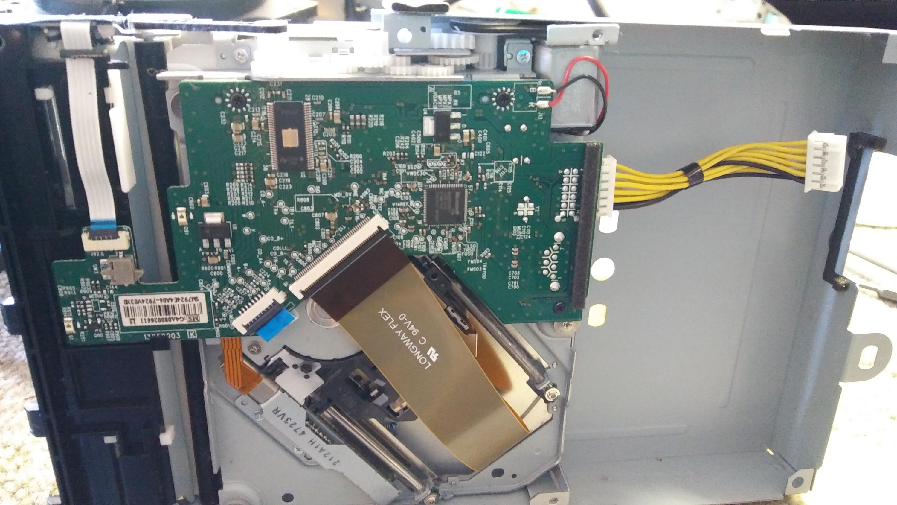

    Xbox one CD stuck repair expirence
    Xbox one CD stuck repair experience: change the belt. for neighbor's kid Free of charge
    Try googling it, you will not find this tips. I don't why nobody mention about this easy fix (belt)!!! Next time you DIY yourself. I am thinking make a video put on youtube.
