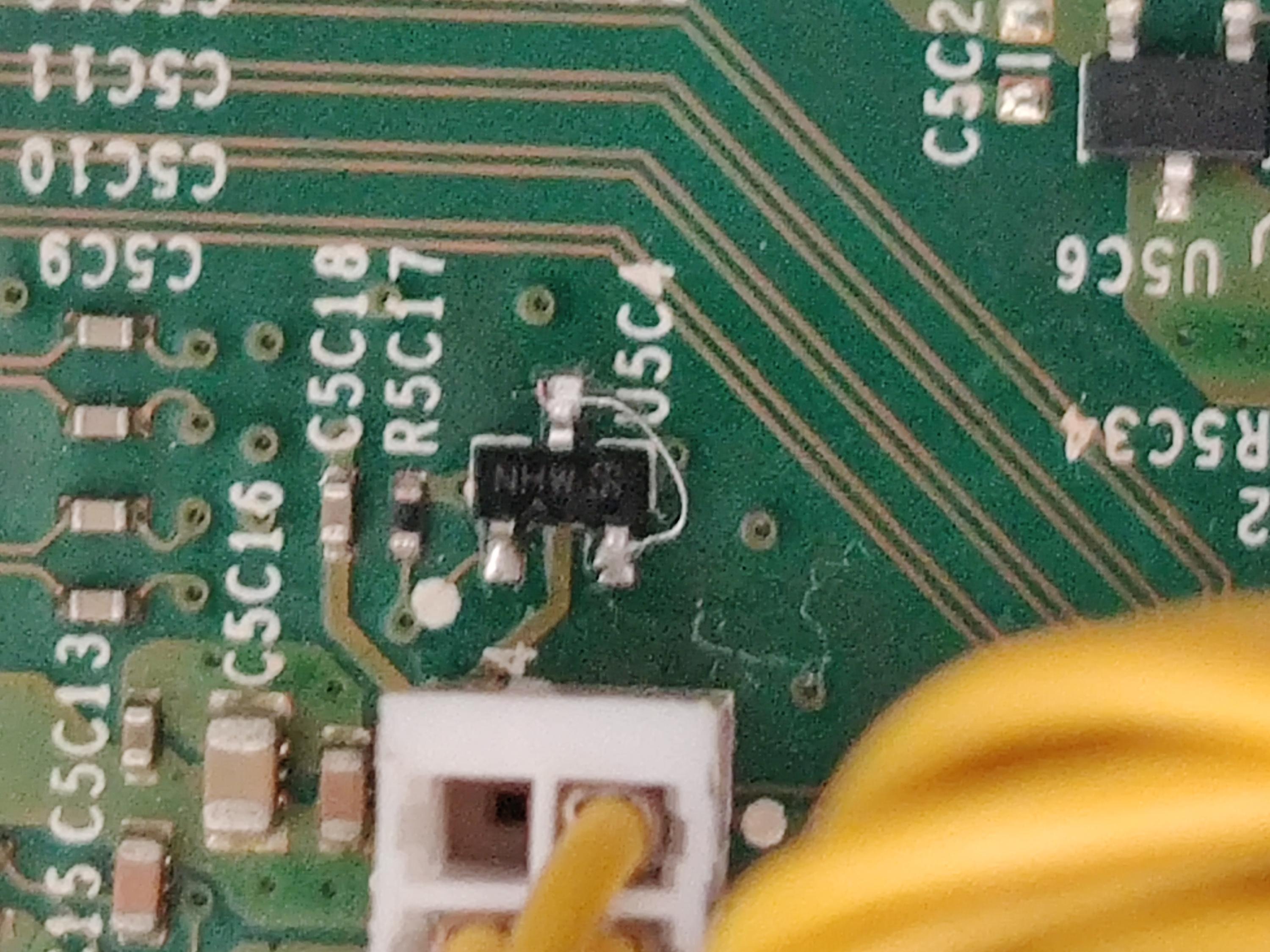

    My Xbox one has stopped taking discs. Sometimes it will trip the power supply and no orange light neither.
    If I'm lucky it will randomly take it after about 10 power reboots.
    I got a new drive, swapped over the board but same thing.
    So I swapped over the motor driver IC, but still same problem.
    Is this turning into a motherboard problem rather than the drive or PCB itself ?
    Help please.

      It works perfectly with the drive disconnected though.

        I've also replaced the 4 caps inside the PSU, even though they weren't bulging.

                      Re: Xbox one 1540 not taking disc
                      So I reballed the Southbridge, but did not resolve the issue.
                      What I found is that U5C2 is not getting ODD_3P3V_STBY_EN signal, or it's being pulled down. ODD_3P3V_STBY_EN is generated by the Southbridge.
                      Any idea's whats going on ?
                        Ok another test. Unit off, disc half inserted, turn in unit with button and the drive takes the disc in, also ilejects when button is pressed.
                        BUT, if unit is already turned on and I try insert disc, it won't accept it.
                        I'm totally baffled.
                        Anyone else know how to fix this ?

                          • gurj1979

                            Yep, tried 2 drives, swapped over the married PCB. But same thing.
                            Opto sensors only work if I perform the procedure of half disc insert then power on. Otherwise they have no voltage.
                              So I finally found a way of fixing the issue. It not ideal but works everytime for disc insert and eject.
                              U5C2 transistor wasn't giving output. So I bridged 2 pins together. Works a treat.
                              See the picture.
