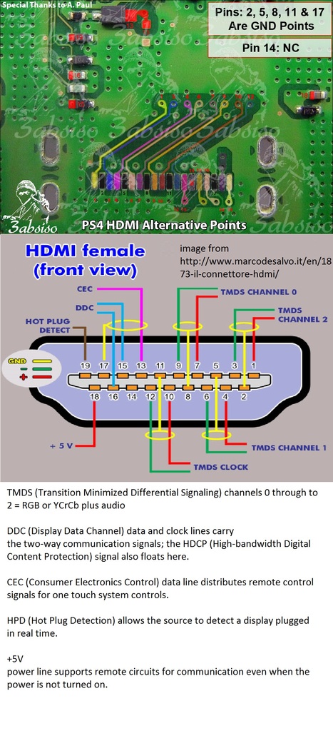

Ps4 HDMI Tracks
11-04-2016, 04:30 AM
Got this from a site hope they don't mind me putting it here.
