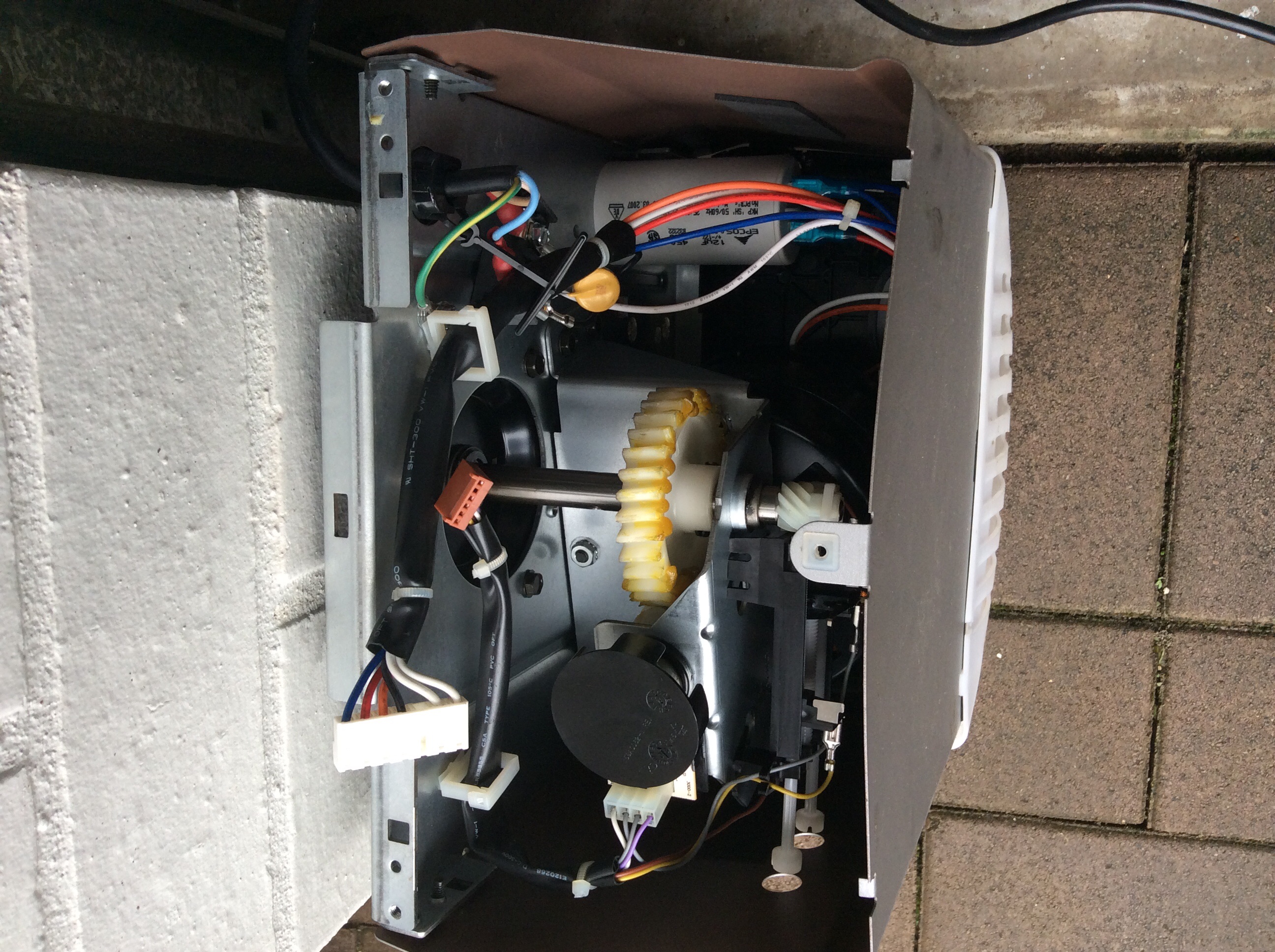

    Hope its ok to start thread on this topic here.
    We went away on holiday for 2 weeks and not return there is no response when remote button is pressed.

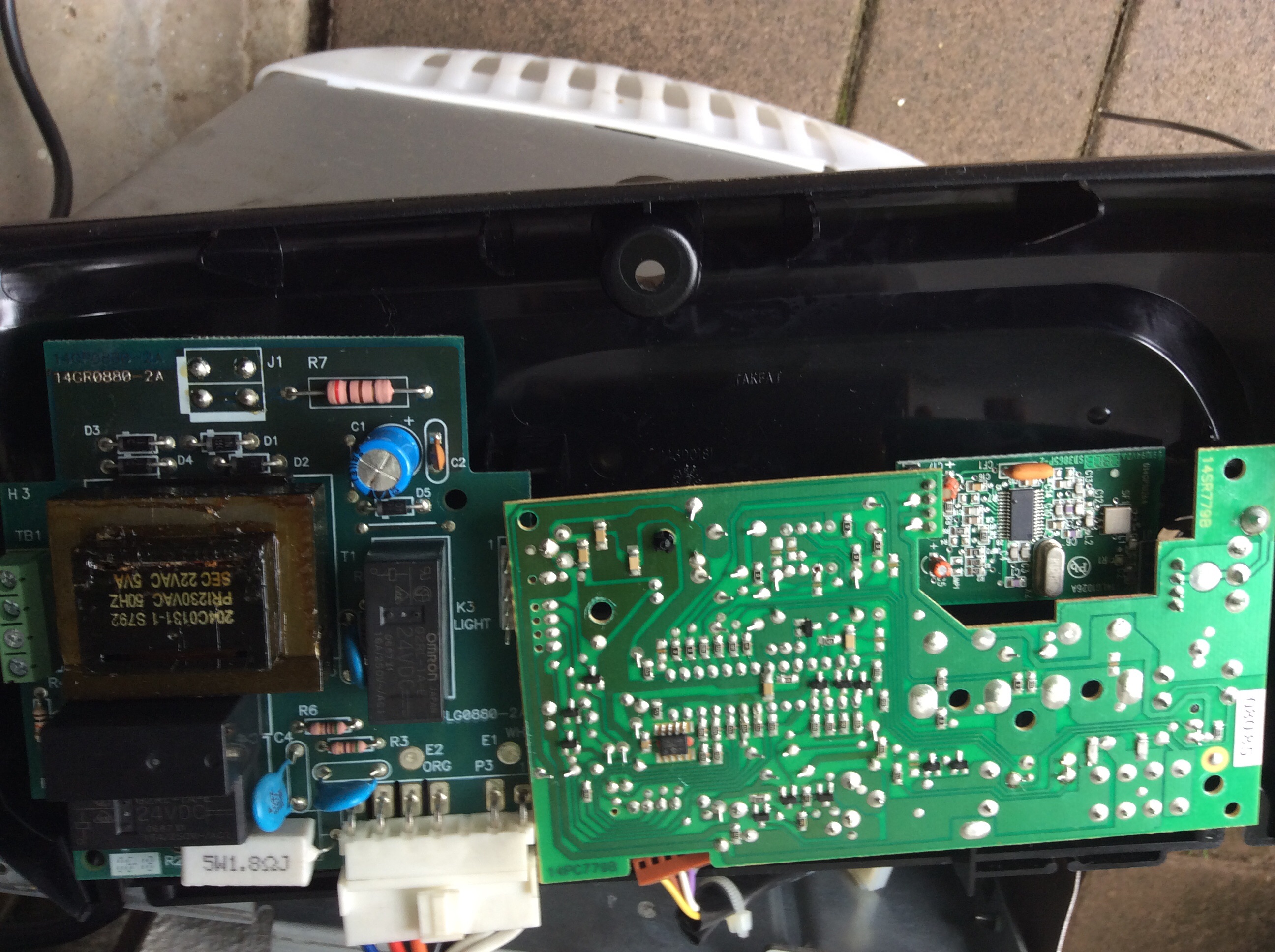

    Attached are photos of the internal guts and the main board and power board.
    There does seem to be any obvious failed components
    I'm wondering where to begin troubleshooting.

      Could only attach 1 photo earlier so photo of boards attached here.

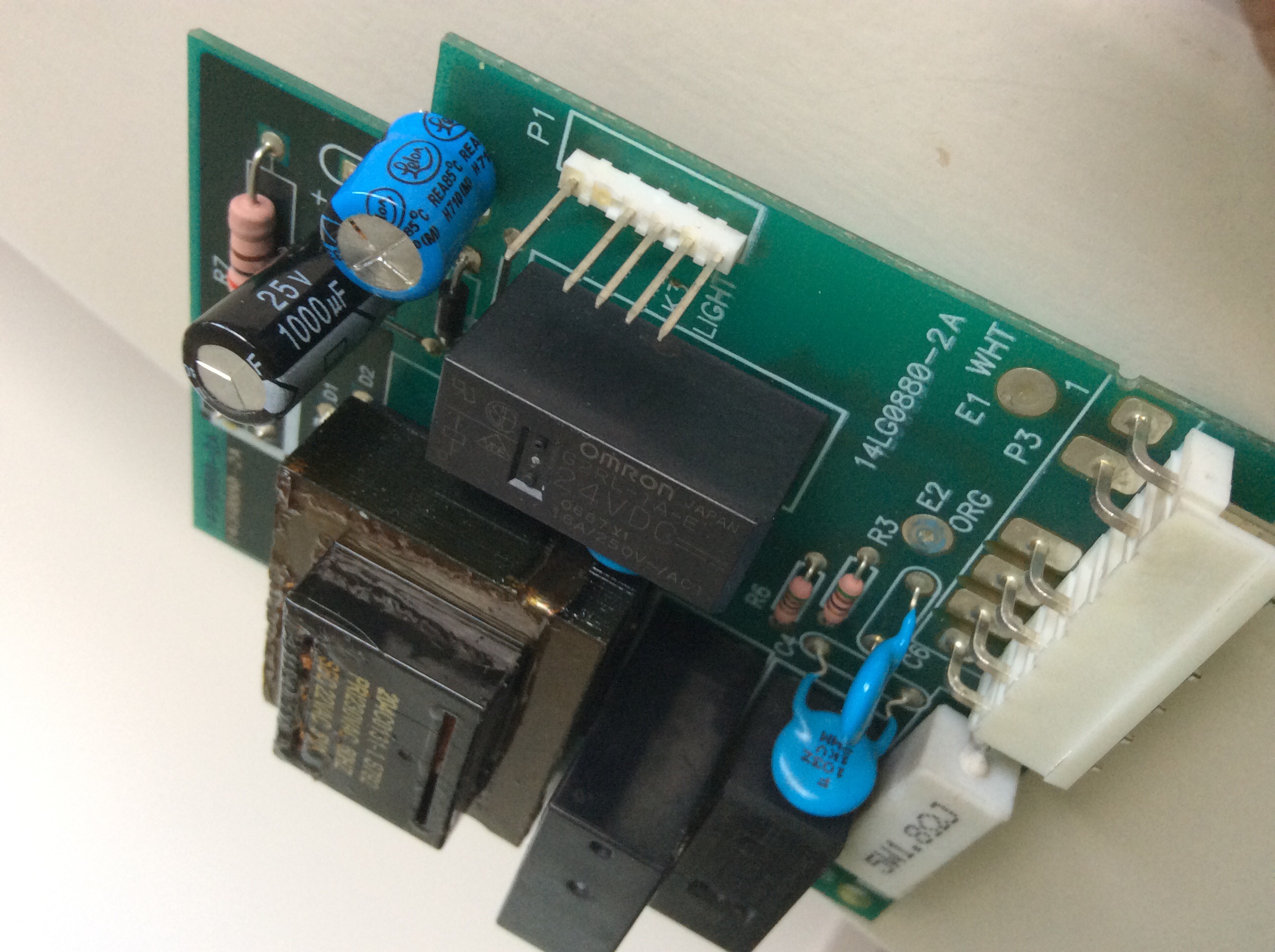

          What a surprise! There was one capacitor that had slight bulge on top, so decided to replace it. Only had 1000 mF leftover from previous Samsung repair so put that in and guess what? It worked.
          The opener responds to remotes perfectly! The blue Lelon is the defective cap in the attached photo.
