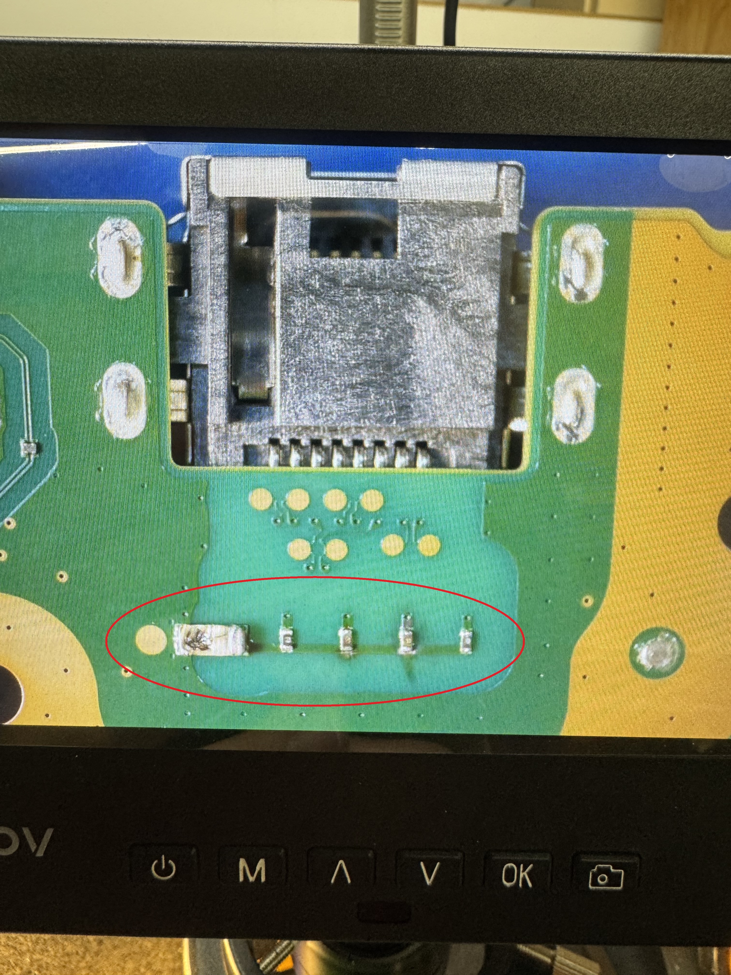

    PS5 Component identification EDM-010
    EDM-010 motherboard, can anyone identify the circled components on the backside of ​the LAN port?
  • LaPCon_IT
    • Sep 2022
    • 82
    • Malta
    4x Resistor 75K 5% 1/16W
    1x Ceramic capacitor 1000pF X7R 10% 2kV
    • 2067739
      • Jan 2025
      • 6
      Client decided not to have me order the parts, but after quite a bit back and forth with mouser, they did point me to these based on what you said:
      https://www.mouser.com/ProductDetail...rrencyCode=USD
      • LaPCon_IT
        • Sep 2022
        • 82
        • Malta
        Yes, these are good.
