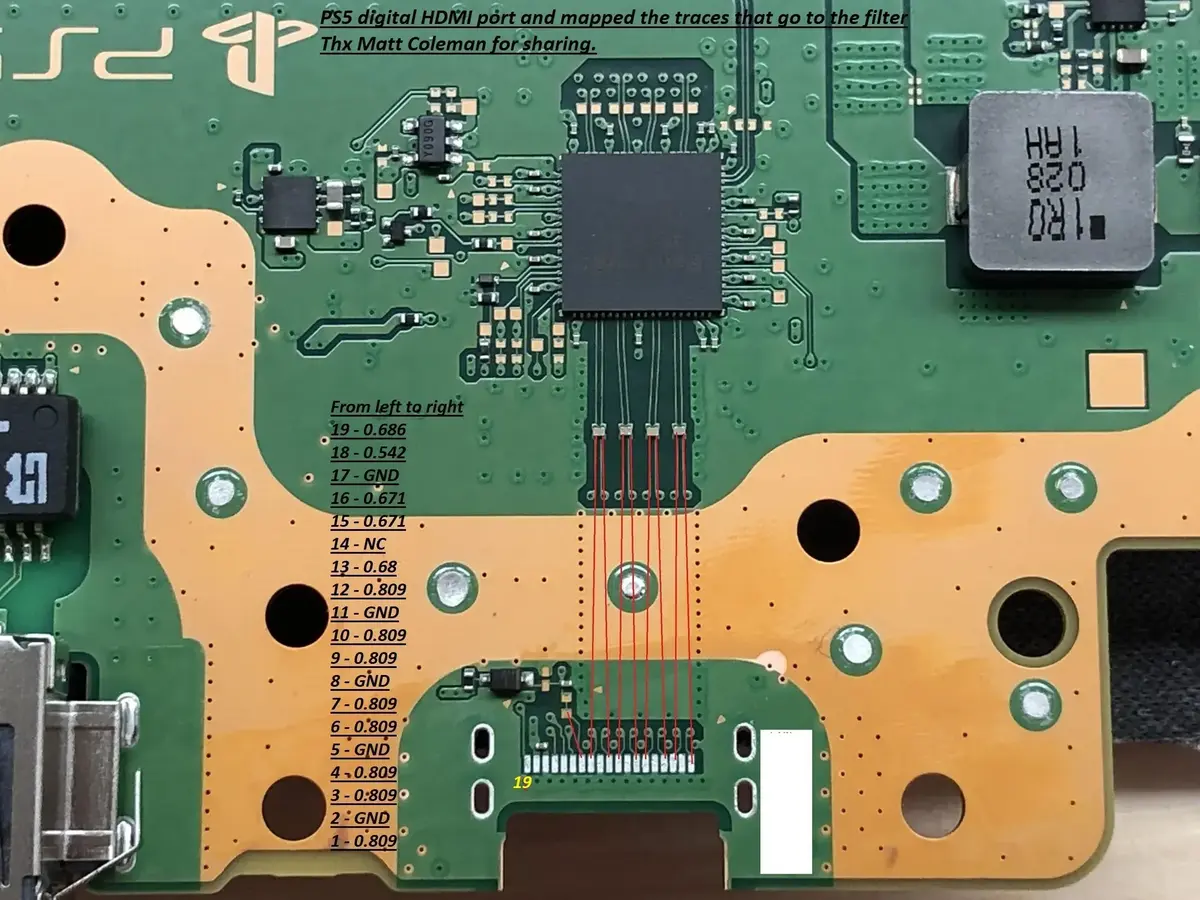

pin 16 of playstaton 5 hdmi port is shorted to ground
  • kjchatman
    • Dec 2012
    • 213
    • united states
    Click image for larger version  Name:	hdmi pinout.webp Views:	0 Size:	91.4 KB ID:	3328710 i replaced the encoder which was defective and replaced the hdmi port but pin 16 is shorted to ground. it's obviously a data bus signal because it's paired with pin 15 but where does it lead? southbridge?
