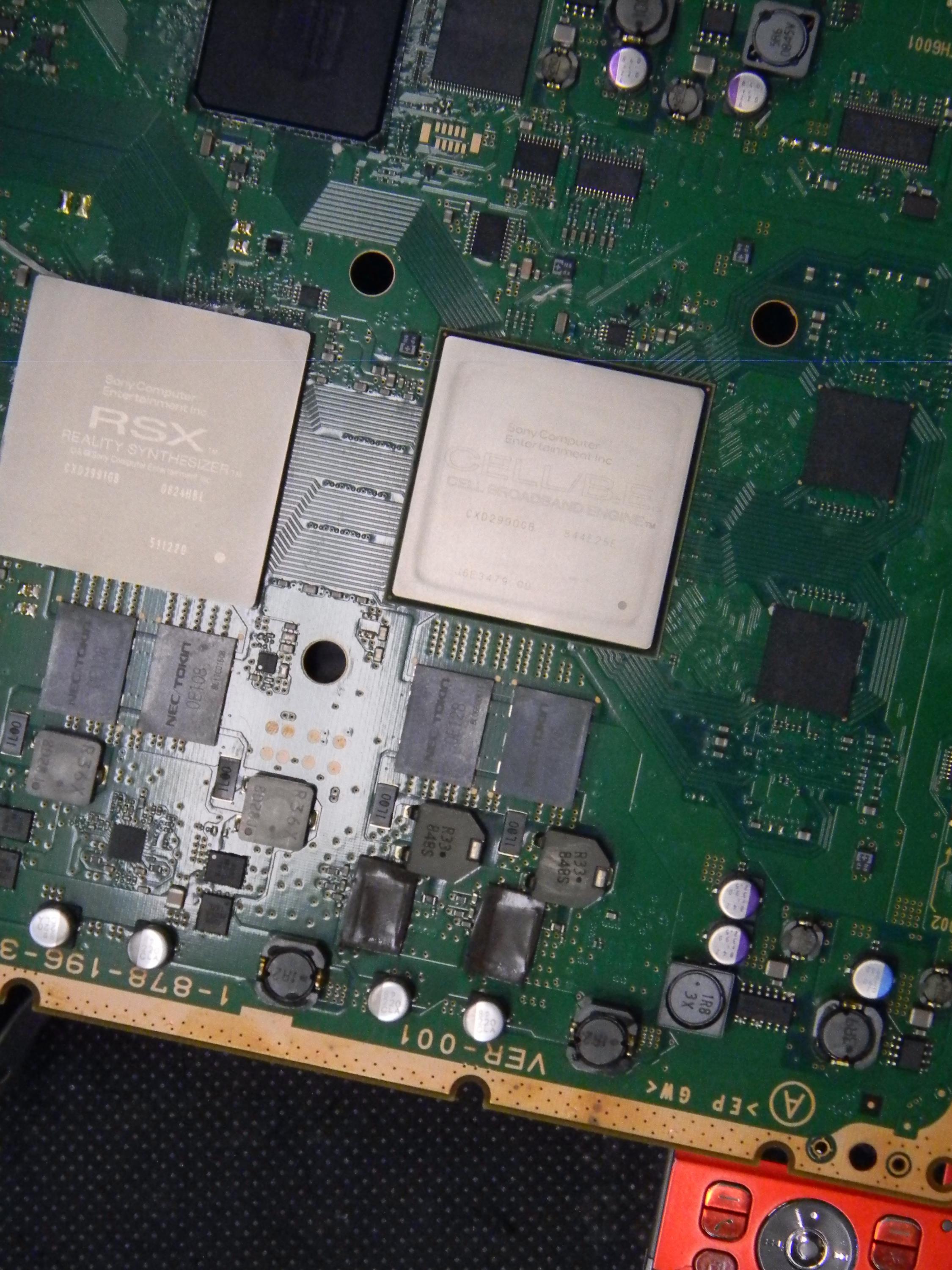

    hy guys
    i was running away from those consoles but fate just bit my ass and give me one to fix.
    so my first one but i don`t have the luxury of reballing and i saw many ppl haveing problems with those tokin capacitor(is there a topic how to measure them?)
    i don`t even know witch one its the gpu
    Those tokin fail like in the notebooks?
    any advice where to start its welcome TY

    Yellow light of death? or any light of death?

      ty for reply no no no. its green and it stay like that but nothing on screen.
      those two cpu or gpu get hot
      when i press the sensor from red it goes green but 0

          ty for reply ,i got only a tv with hdmi where the tech guys that repairs cellphones is.
          today i ordered a bios programmer ; can i rewrite the bios on it?
          i`ll go in the storege room they say they got a lot of ps3 dead i wanna see some values of those nec-tokin capacitor maybe its replated to those

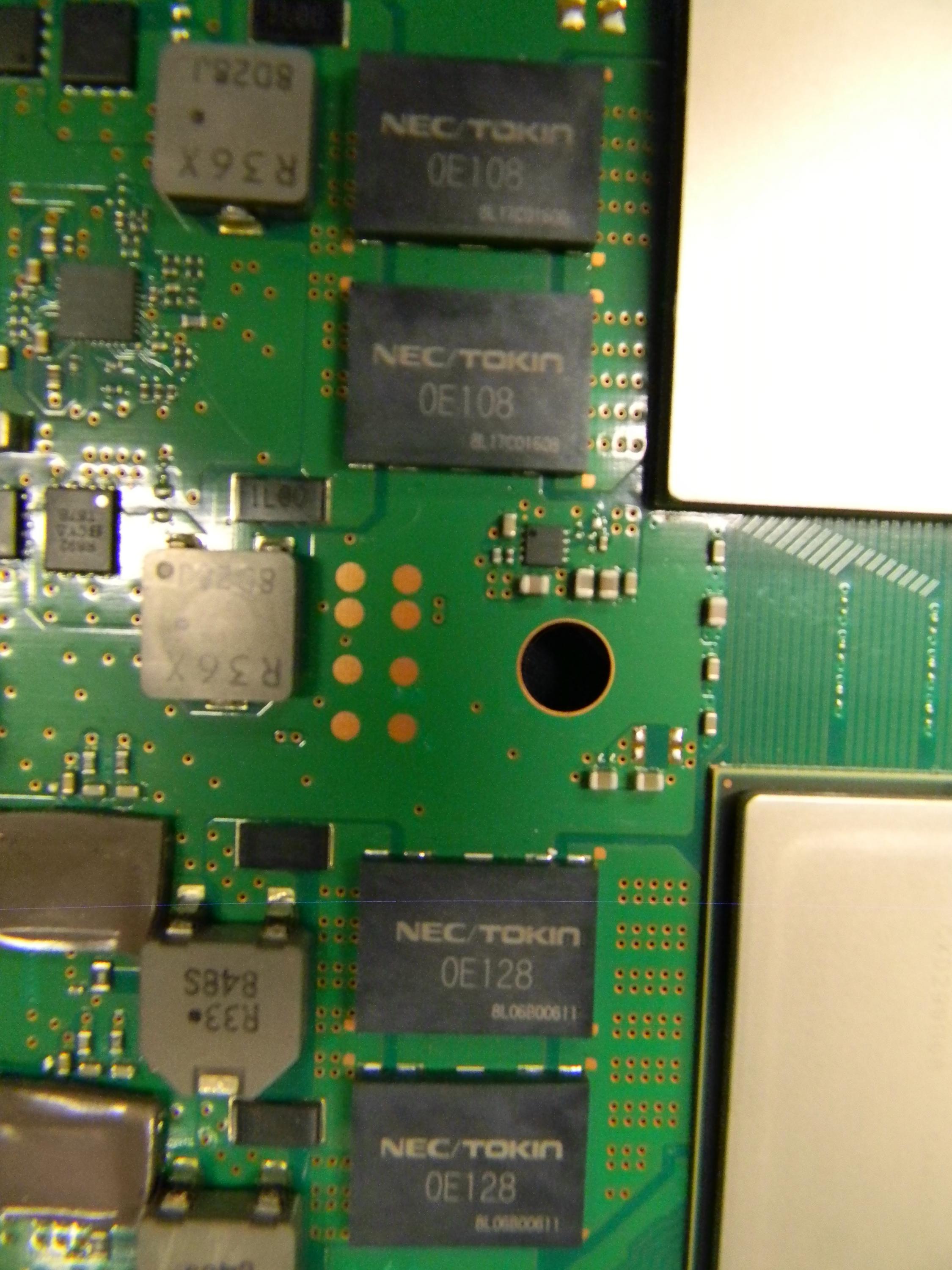

              i did ask if someone knows how to mesasure those nec-tokin; they have the same value like the ones from the notebook... i have a toshiba with a tokin i`ll open it so i can see the value on it.
              "polies" sry i don`t understand
                yes i did try that reset by holding nothing
                check this out, seems to be 1200uf

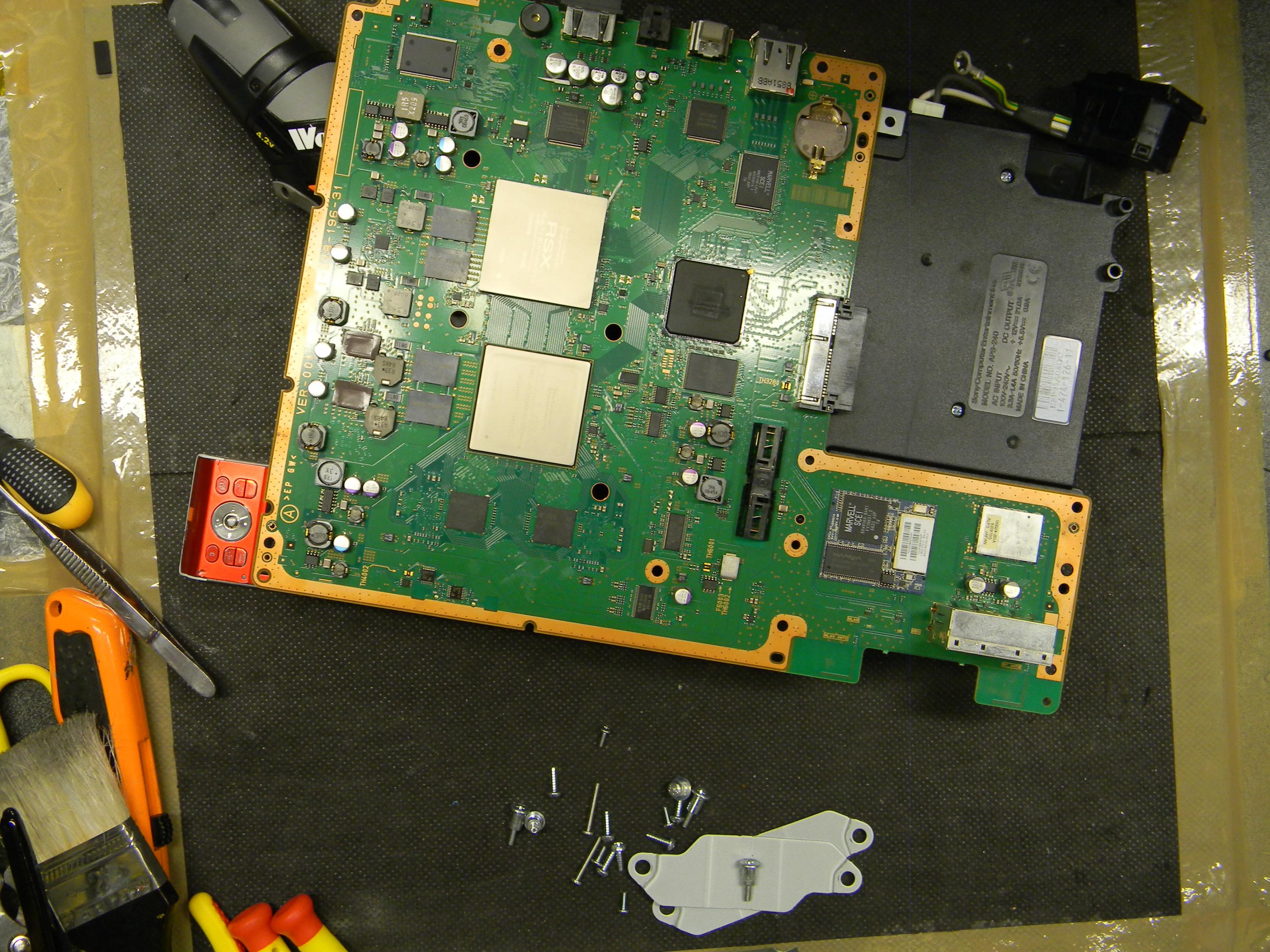

                          no no no they all got problems similar like this.
                          its like a faulty/spare depo
                          i`ll open today 3 ps3 maybe i will find 3 differant results
