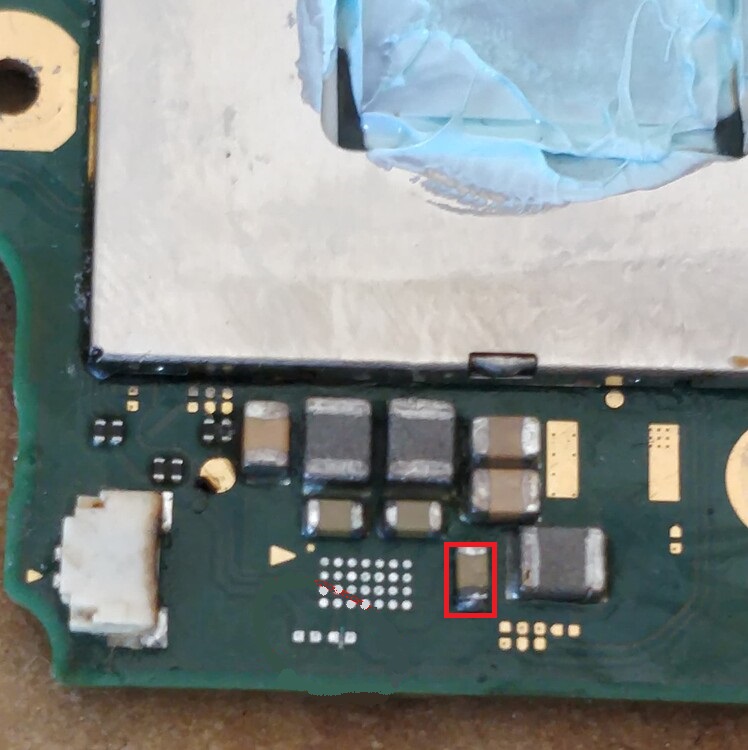

Need Value of capacitor Nintendo switch
  • jeangonbay
    • Jun 2021
    • 22
    • La Réunion
    someone would know the value of the capacitor, circled in red,please ?
  • LaPCon_IT
    • Sep 2022
    • 81
    • Malta
    Re: Need Value of capacitor Nintendo switch
    Check those two above the dots. Probably all three are the same.
