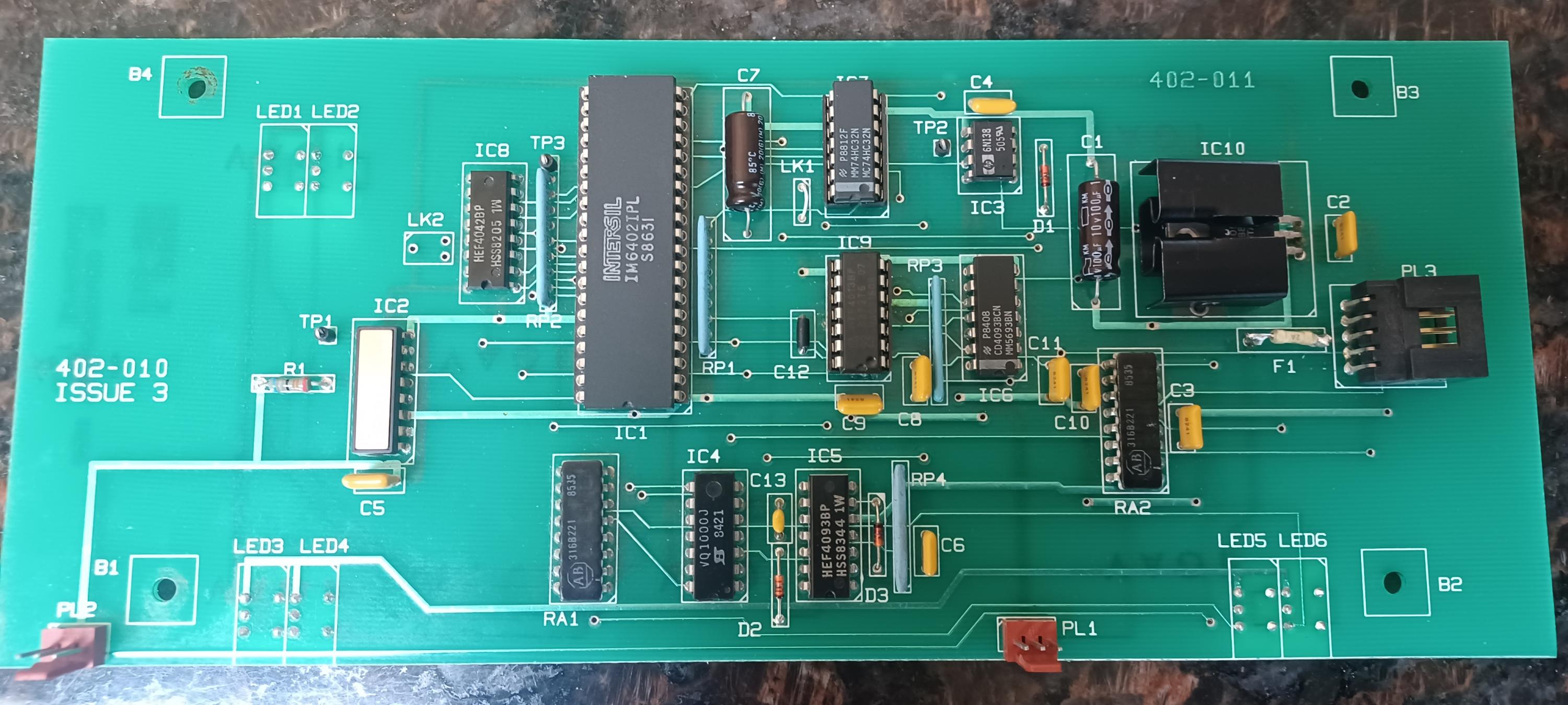

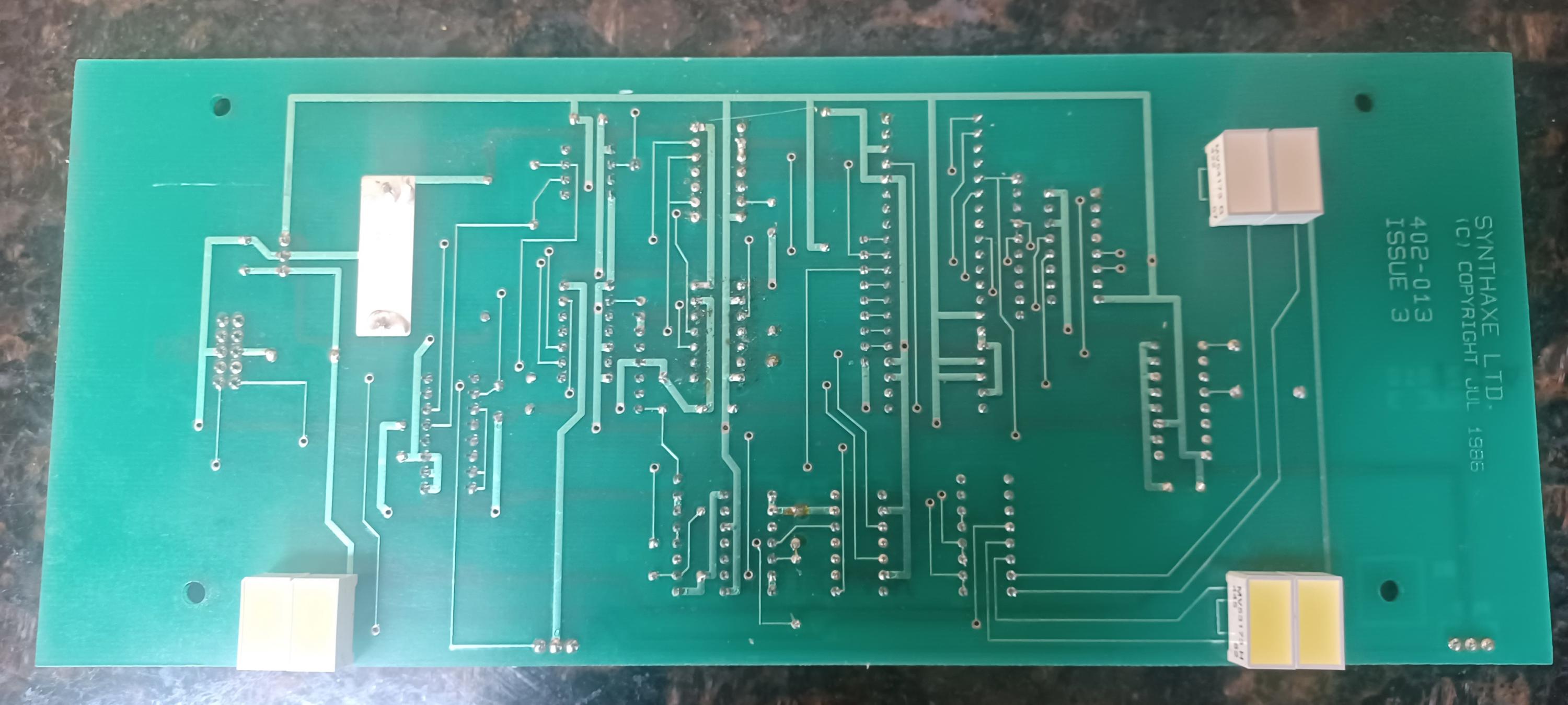

    Hey all! I have this midi controller called a "Synthaxe" which is pretty rare. It was made around 1986 and the company only made about 100. I was told less than 25 still work today. Theres a guitar player I love that is known for using this and to play his material you basically need one of them because it does things no other midi-guitar controller can do. So since I got it, ive been trying to learn about it so I can extend its live as long as possible.
    The one that I bought has 2 issues. One I'll cover another time but I think this one is easier and simpler to fix.
    This is the step pedal. The way that it works is, it allows you to scroll thru your saved banks by foot, without having to push a button on the console.
    Theres a - and + button on the console and that does work.

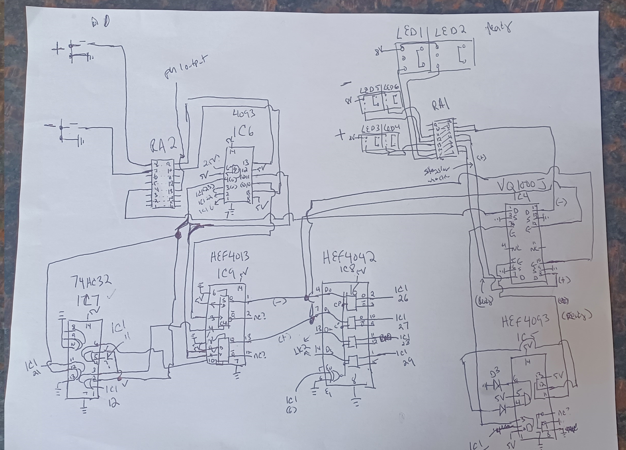

    The issue is, when using the foot pedal, the - direction works, but the + direction doesnt. It doesn't move forward and the + light gets stuck. I swapped the pedals and I got the same issue so it wasn't the physical switch, its on the board.
    I also don't have an actual schematic for the one I have, but I have one similar which I'll attach beacuse it may be of some help. So I made my own little one, so I know where everything is connected to. Its pretty rudimentary so, sorry about that.
    The way the unit works, is the floor unit has the power supply, and it supplies power to the controller, console, and this step pedal. For the step pedal, it takes 8V in, and transfers it to 5V which supplies all the chips. The 8V goes to the LEDs. All that stuff works fine. Also the output works fine because again, I can move the banks backwards, and I think it only transmits from one line.
    In my diagram I made using my multimeters continuity function, I've isolated the issue but I'm unsure where to go from here. I traced both + and - signals working fine to IC9, which is an HEF4013. On the output, Pin 1 goes high then low when - is pressed but pin 13 stays high when + is pressed. I replaced that chip and same issue. Notice how Pin 13's trace is tapped to go to IC4s VQ1000J Pin 10, so the LED stays high because that line doesnt go low. All the other pins are fine in that HEF4013, including Pin 11, which is the data line (goes high and low). So it must be Pin 10, which clears the signal. Thats controlled by IC7 74HC32. Replaced that and still the same issue.
    It was at this point where I traced everything and I saw that for IC7, Pin 6 doesn't clear, but Pin 1 does (Pin 4 of IC9). Both Pin 2 and 5 are tapped to IC6 4093 Pin 4, so thats not the issue. But they both come from IC1 pin 12 and 11.

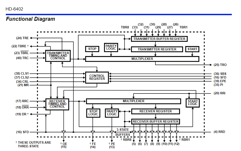

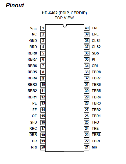

    IC1 is a 6402. Pin 12 is what is needed for the - line clear, but Pin 11 goes to the + line clear. Is the 6402 actually whats bad? Theres a SIP resistor package that connects to Pin 5-12 (RBR8-1) and it seems to not be faulty, so all I can think of is that its the actual 6402 itself. I just don't know how to test to see if thats the issue aside from just buying another one and putting it in.
    TL;DR - One of the pedals doesn't work and I traced it back to the 6402, should I replace it?

      This doesn't have a microcontroller, it's somehow parallel loading the UART directly to spew out MIDI messages, is that right? Or is it proprietary serial data the pedal interface uses.
      I find pedals and jacks get hit with ESD so I would check all IC's connected there. It looks like the CD4093 would get nailed but you've replaced it.
      I look with a scope at the signals to see if they are properly swinging from 0V to 5V, a shorted/damaged gate or mosfet will leave oddball logic levels.
      Any troubles with IC5 shorted gate input like pin 10, 5, 3 would also affect the pedal latches/TX packet as the lines are shared.

        Thanks for the reply! I'm not entirely sure TBH about the midi messages. The foot-switch only moves forward and backwards within the saved banks in the console. That feature is also included as buttons ON the console that work fine, but I don't know what other data is being transmitted between the foot-switch and console.
        I think you may have mis-read what I wrote. Remember the handwritten crappy schematic that I did is the ACTUAL schematic to my unit (REV 3), the more professional one is the original concept (REV 1) that barely is the same, but it at least shows the input and output connections.
        In my schematic, the issue is pin 13 on the HEF4013 stays high after the "=" is pressed. I traced the working and not working signals to that chip with an oscilloscope as well. Pin 1 on the HEF4013 is the output for the "-" signal which works. Pin 13 stays high, and that line goes to VQ1000J which controls the LED lights, and when that pin stays high, so does the LED for "+" and it stays lit and doesn't clear until power is turned off and then back on. I then saw that pin 10 on the HEF4013 clears the signal thats controlled by the 7432, that I replaced and didnt work. Then THAT 7432 gets signals from the 6402, and I replaced THAT and that didn't work. Thats all the ICs that could control the "+" line at the point it stops working.
        Poking around with the continuity function to what all the caps are connected to (not included in my diagram). Out of the 13, 9 of them are ceramic 104's and one of them is connected to the cathode of the diode on the HEF4093 and also a resistor array thats connected to IC1 Pin 11, which was one of the things that controlled the "+" signal. In any case, I removed that cap and it seemed bad. The caps are a bit too small to read in my multimeter, but I pulled 2 out and they read the right capacity after fiddling with it, where as the one that was connected to the IC1 Pin 11 didn't seem to register or show any value, which after mapping out the caps, is the one I would suspect to be bad. So I ordered a bunch of caps and am gonna replace them all.
        In my diagram, I'm unsure what the purpose of the 4093 is. I know that Pin 2 gets the Tx signal from the 6402, and the output of that, pin 3, goes to the VQ1000J, which then goes to the output of the footswitch, which goes to the console. Again the "-" signal works and travels thru that line, its only the "+" that gets stuck high.
        Pin 11 on the 4093 is what helps control the "ready" LED, which lets the user know the unit is working properly.
        Apologies for the wall of text and possibly unimportant info! Im putting out everything I can in order to paint a clearer picture.

                How it seems to work... a bit weird.
                It looks like either pedal press gets latched/debounced and held into the 4013 flip-flops. They later get reset by a special packet received by the UART from the main board.
                So they (4103) would hold or latch any pedal getting pressed, forever until the clear command comes in.
                As well, the pedal status and compared to previous status gets transmitted serially out of the 6402.
                It transmits a read of the pedals and compared to its previous state (IC7 74HC32), back. 4-bits of data. A state change for each pedal i.e. if the pedal was latched on and now it's off gets transmitted serially out of the 6402. It's saying "hey a pedal was pressed (or released), this is new".
                If pin 13 4013 Q output goes stuck after a pedal is pressed, it needs a reset command from the main controller you would see at D3.
                If the LED driver VQ1000J was shorted an LED would always stay on and possible jam the 4013 outputs that connect to the IC's gates.
                The schematic has a bunch of mistakes too. IC7 pin 12,13,11 seem to do nothing, the READY LED's are only setup to blink, IC6 pin 3/4, 10/11 not used. It's strange.

                  Correct. Ive replaced IC1 which is a 6402, and IC7 (74HC32) and IC9 (HEF4013), all with identical ICs.
                  All the other ICs aren't associated with the pedal.
                  IC2 is a PX01000 crystal set at 500kHz, in order to get the 31.25 baud rate for midi data
                  IC3 is a 6N138 octocoupler, somehow connected to the input of whats being transmitted to the foot controller
                  and IC10 is an L4805 Voltage regulator to knock down the 8Vs coming in to 5Vs to feed the chips. But the 8V line is needed for the LEDs. All those things work.

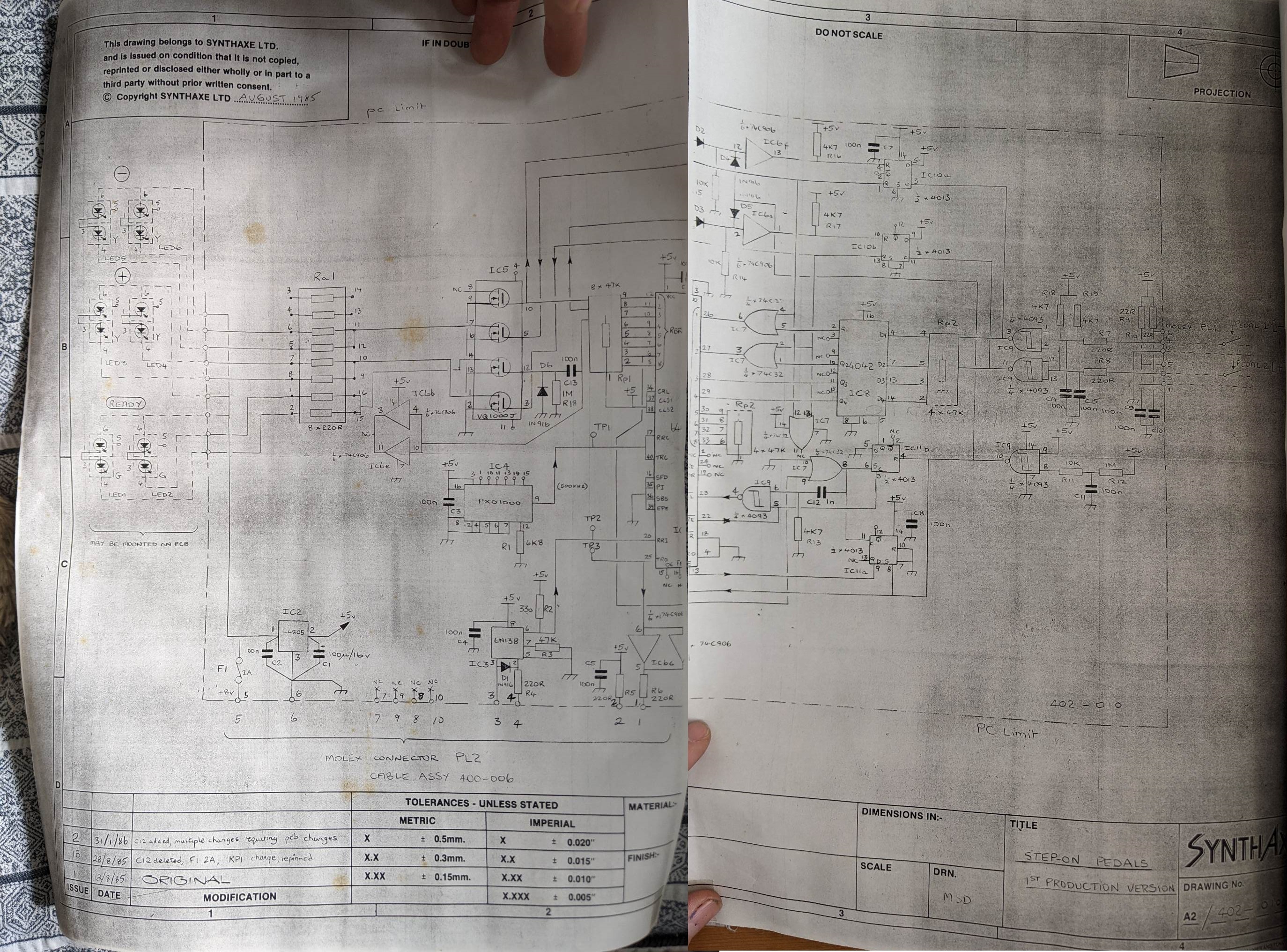

                    I think you're still looking at the wrong schematic. The one that looks photocopied is one I received but is the 1st revision. I have revision 3, so in order to map out whats going on, I had to make my own rough diagram to see where the chips were connected to. The issue is IC9s pin 13 gets stuck high and doesn't get reset. I replaced that IC, as well as IC7 (7432) and the 6402. But again I think the issue is a capacitor that's attached to that line that controls the "+" function. Once I get that, replace it and still have the same issue (hopefully not) i'll get more info.
                    IC1 is a 6402.

                      Sorry it's just there is no 6402 UART on your schematic and it's hard to follow so I went with the rev 1 that shows it.

                          Yeah, sorry about that. It was just too big for me to put in the diagram and I didn't think that was going to be the issue. Thats why I just wrote "IC1 Pinx" when something was connected to it.
