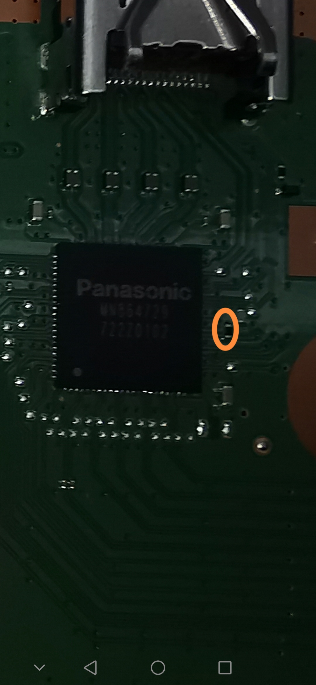

        Hey, guess I'll just abuse your thread.
        Does anybody have a clue about the value of this resistor, PS4 slim. I'm going to replace it, but I lack a donor board:

          Re: value on resistor ps4 pro
          Seems to be 22ohm on my donor bord
            Thanks a lot. I'm going to keep you updated, whether it worked. ;-P
