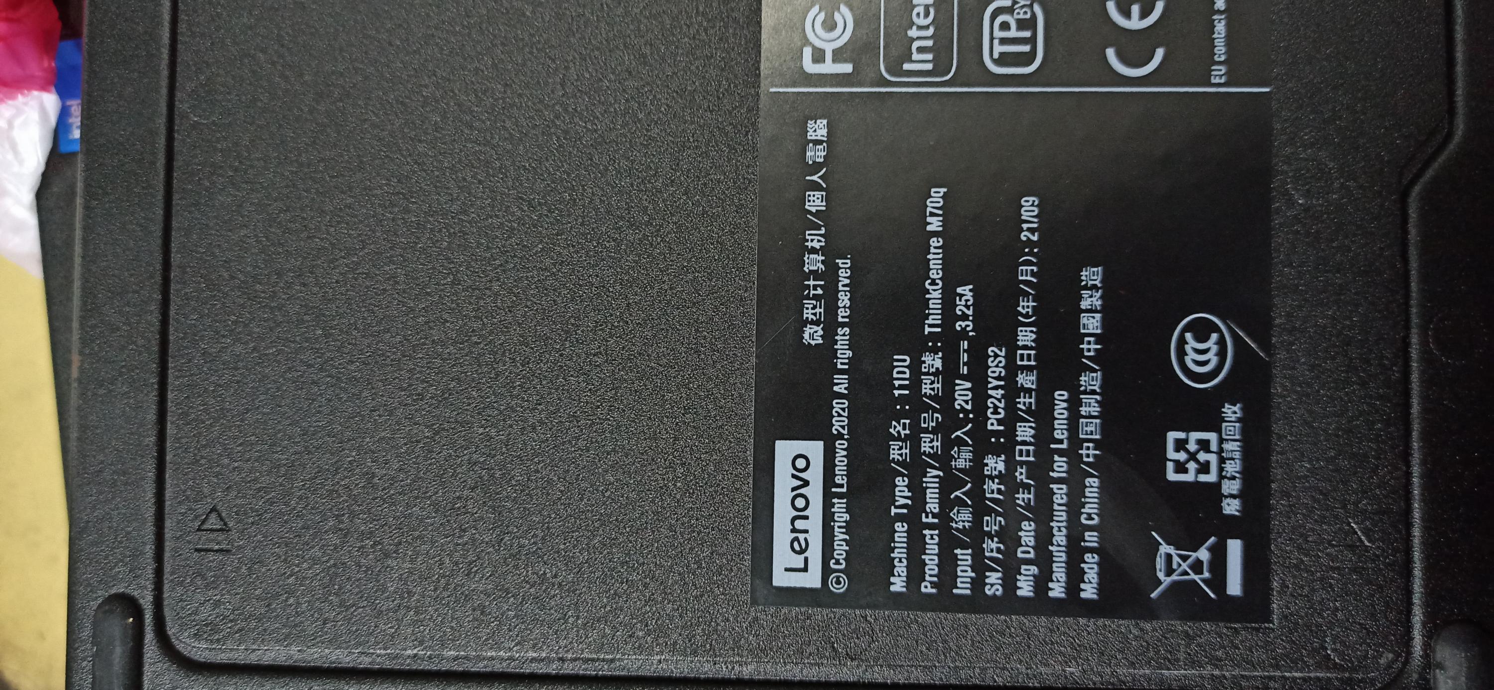

            Re: Lenovo ThinkCentre M710q corrupted BIOS, password
            Master help to remove password pls..🙏 more thanks & Merry Christmas 😊
