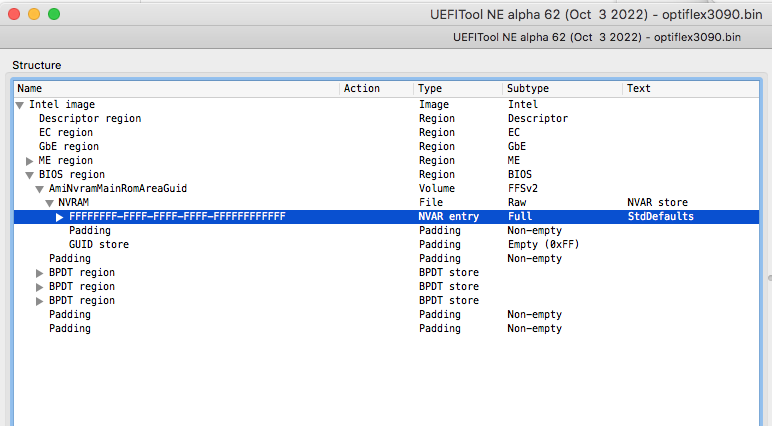

                        • osman68i
                          • May 2015
                          • 359
                          • The Netherlands
                          #52
                          Re: dell optiplex 3090 bios issue please help!!
                          Hi
                          i want to unlock optiplex 3090 micro
                          SVCTAG 244K2L3 - 8FC8
                          • hoaca388
                            Badcaps
                            • Jan 2022
                            • 12521
                            #53
                            Originally posted by osman68i
                            Hi
                            Unlock bit not found on this bios.
                            • osman68i
                              • May 2015
                              • 359
                              • The Netherlands
                              #54
                              thats very strange.
                              I will reprogram the oiginal bios and check again. I will take a photo. thanks in advance.

                                        • ademkotiloglu
                                          • Sep 2021
                                          • 11
                                          • tr
                                          #60
                                          What ? What help ?
                                          I forgot my bios password. I added my original bios file. I request the unencrypted version.
