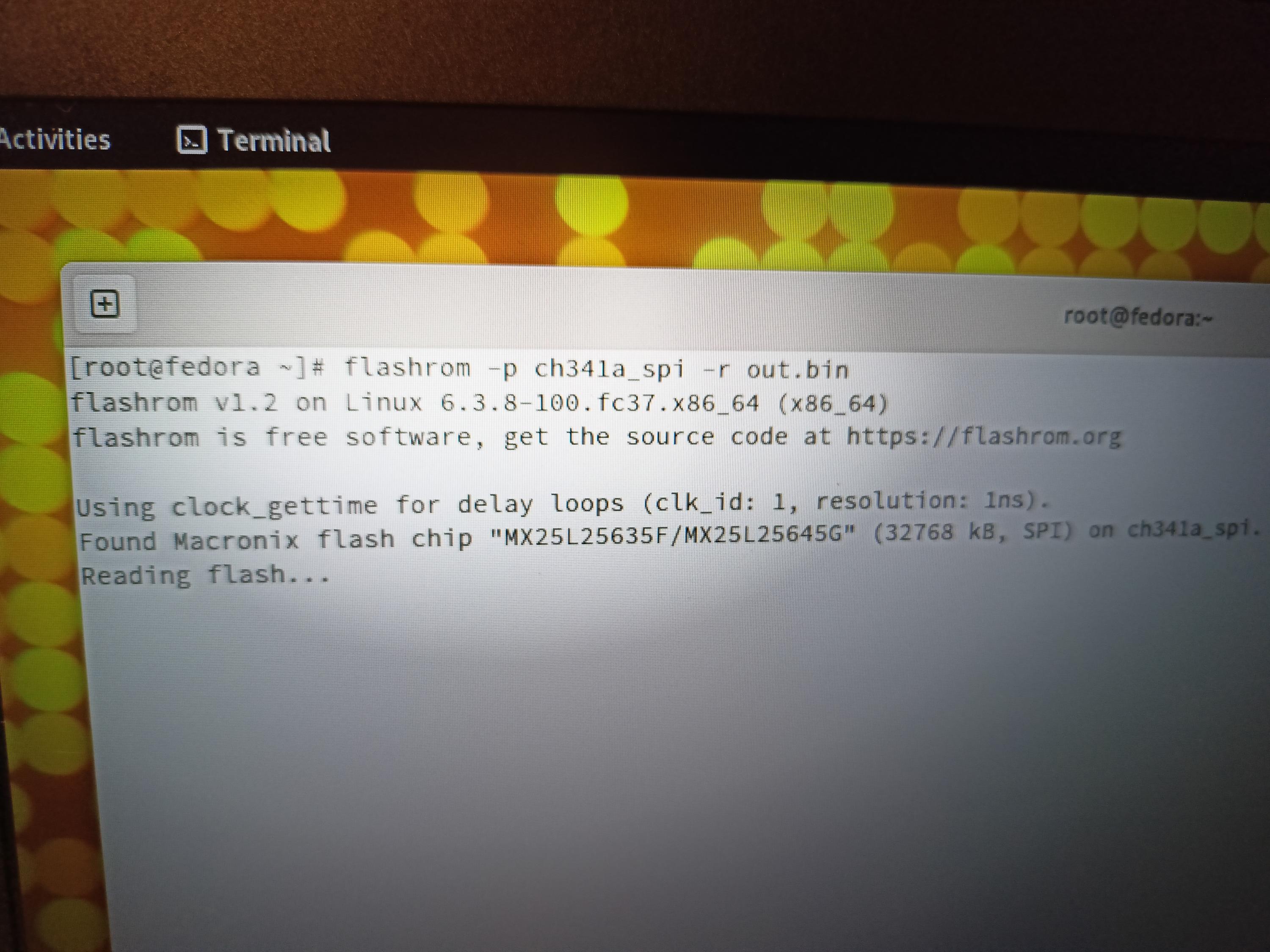

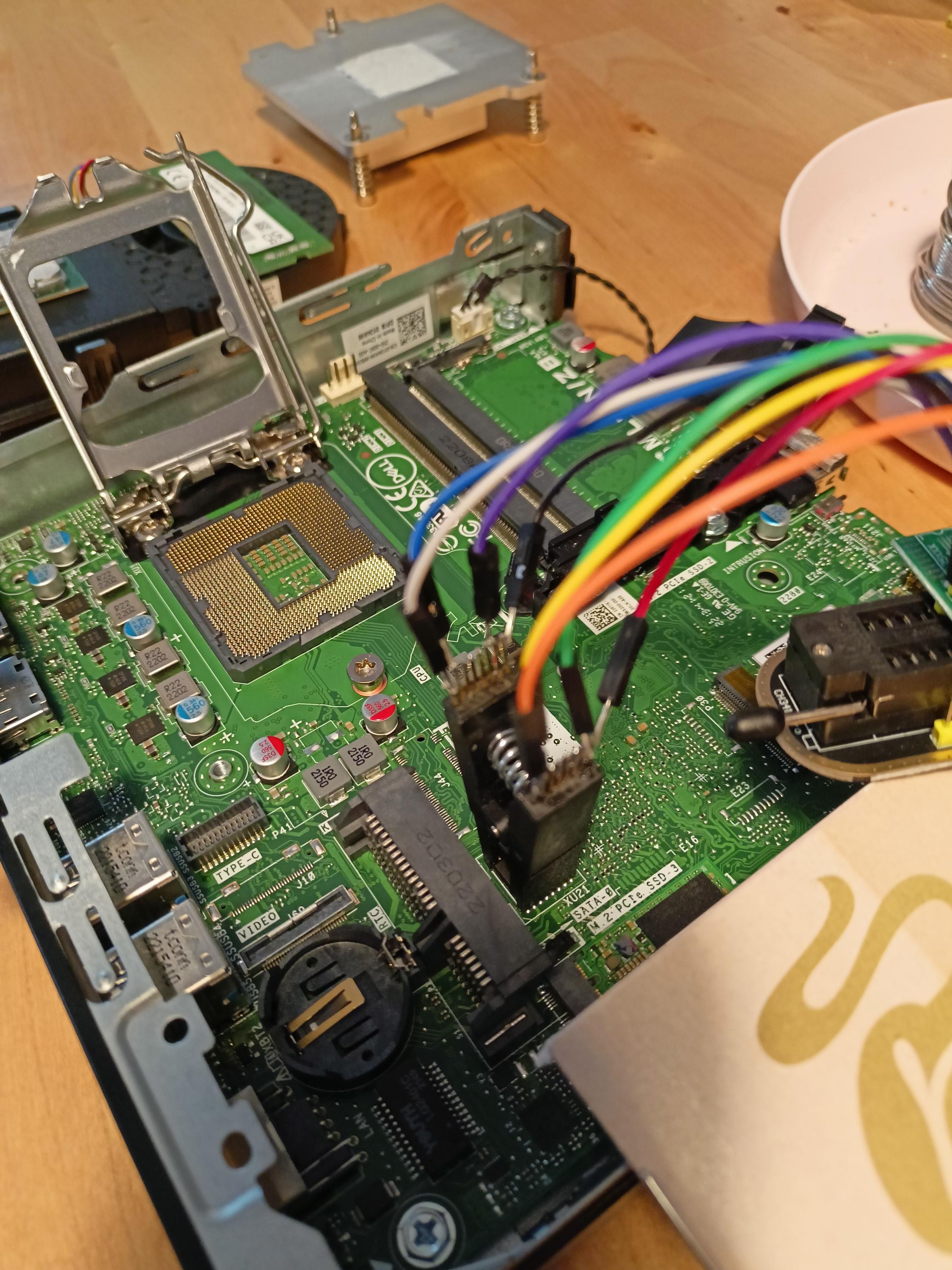

                                          Just a short summary what worked for for my dump. I purchased a SOP16 test clip and soldered the eight wires to it. Actually I purchased another one pre-wired that did not create a stable dump.
                                          With an CH341a Pro set to 3.3V I was able to create a dump with flashrom on Linux and write the patched one. I had to remove all components from the board.
                                          The wiring was simply taken from the chips datasheet:
                                          https://www.badcaps.net/download/?id=1cbeb985
