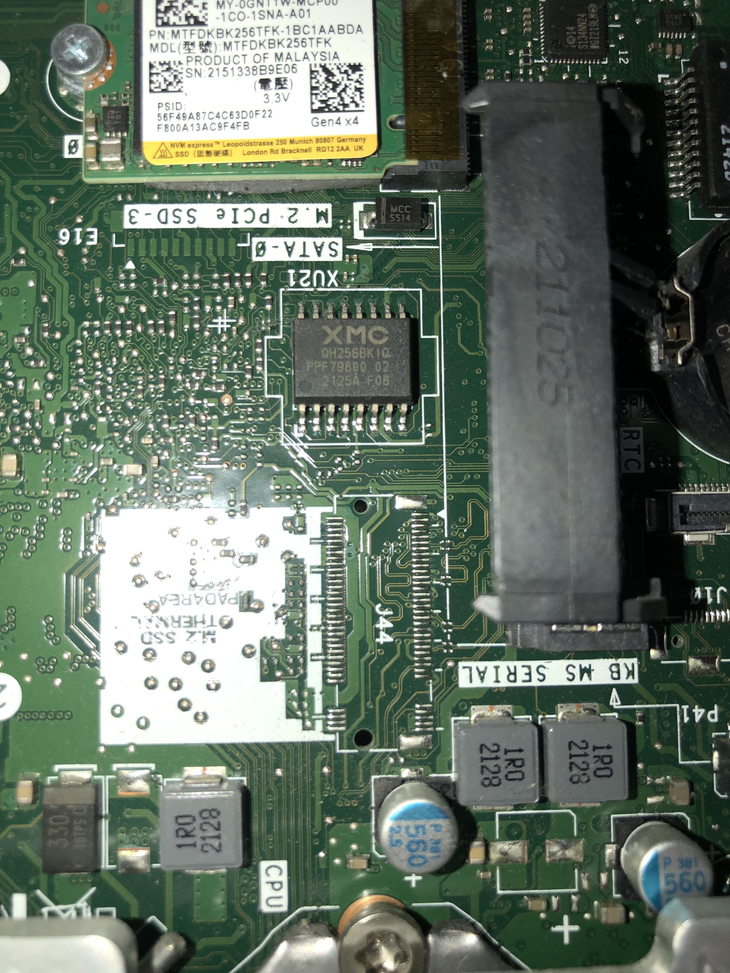

      Click image for larger version  Name:	IMG_4712.jpg Views:	0 Size:	61.8 KB ID:	3755461
      Originally posted by misiozol
      dont have account there, its asking for login.
      hi misiozol,

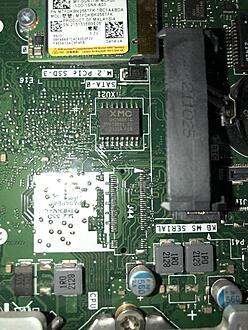

      Im a newbie here and i dont have any idea how to flash or get the data from the bios. i do have a problem with admin password security in the bios with this chip on the dell optiplex 3090 mini pc. Would be grateful if you could help me. Please see reference image below. Thank you!
      Click image for larger version  Name:	IMG_4256.jpg Views:	0 Size:	3.43 MB ID:	3755458
      And for the tools, will this suffice ? The programmer is located above sorry im in mobile. Im looking to go for solderless route if possible. Again thanks very much!

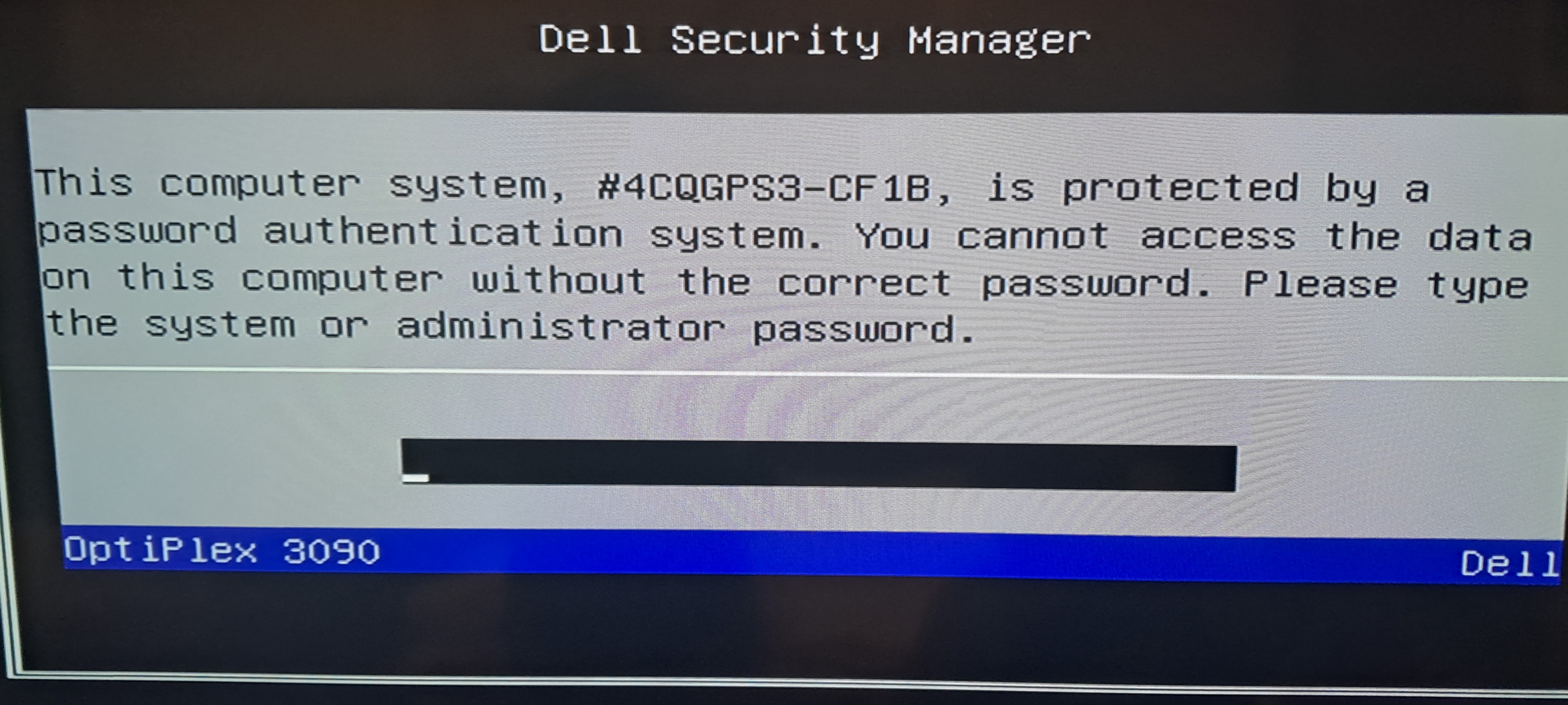

        Hi ! please help !
        service tag: FVTHYP3
        Please help me remove this ! Thanks !

          Originally posted by opy
          Hi ! please help !
          post the original contents of the bios chip..

              Originally posted by jrlmerchandise
              hi misiozol,
              I'm afraid that's difficult, it's a 16-pin chip and if you don't remove it from the motherboard it can't be read.
              The bios chip must be unsoldered from the board before writing or reading..
              do not use the clip, you may have errors..if you do not have anything to unsolder it with,
              solder wires between the programmer and the bios chip..
