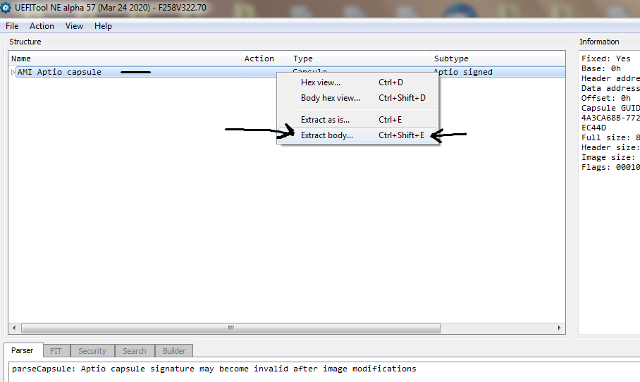

    Hi... i need asrock fm2a58m-vg3+ bios .bin, please help

      Re: ASROCK fm2a58m-vg3+
      thanks for reply.. is it for FM2A58M-VG3+ R2.0 , bios version P2.70?
        You didn`t say your board is R2.0 .Download the Instant flash bios version from the support site (R2.0 board) https://www.asrock.com/mb/amd/fm2a58m-vg3+%20r2.0/#BIOS and extract the zip folder
        The bios is 8,196KB ,it should be 8,192KB ,it needs a 4KB part of it deleting. Open the bios with UEFITool ,right click on "AMI Aptio capsule" and select "Extract body" ,that will remove the 4KB leaving the proper size bios. It will be saved as a rom file, you can rename it to *.bin if you prefer.
          Hi SMDFlea
          I need to flash a FM2A58M-VG3+ Rev 2.01, & i'm very confused 'cause Asrock does not mention in their webpages nothing about different revisions of their motherboards. Should i use your provided .rom?, or may i cut the FM2A58M-VG3+ R2.0 .rom and flash this mobo with the modified one?
            Originally posted by AvenocturnO
            Hi SMDFlea
            Thx a lot for your valuable time.
            Try the R2.0 bios,but make a backup first.
            • AvenocturnO
              • Jan 2023
              • 3
              • Argentina
              I'm sorry, Master, didn't receive any notification about your answer. It worked, thx a lot!
