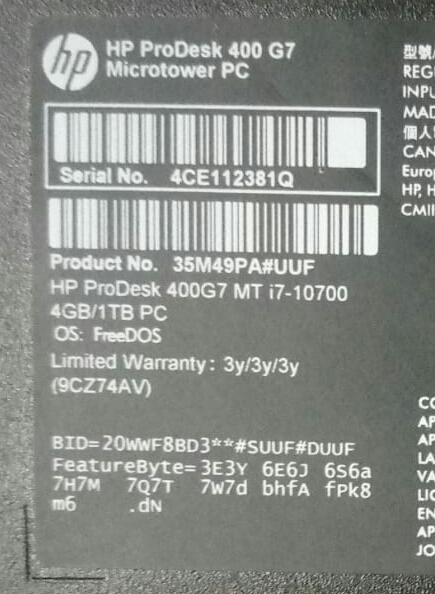

    I have 2 motherboards of hp 400g7 mt for repair. One has power on password problem while the other bios is corrupt. I tried to repair/ modify the bios but didn't succeed. Please help to solve both issues. Thanks in advance.

        Someone, please help. I need these bios. Here is the serial no of one CPU, don't know which one because I only recieved motherboards. If possible, provide me just one bios with clean ME. Thanks.

          Re: Request for hp 400g7 mt password removal and bios repair.
          Try for " no display " first
          HP ProDesk 400 G7 Microtower PC (9CY16AV)
            Thank you so much Hoaca388 . I'll check it tomorrow and let you know.
              My endless thanks Hoaca388. It worked . Can you please remove the password from other bios?

                    Originally posted by SMDFlea
                    I tried RCUnlocker and HPUnlocker. RCUnlocker doesn't support this file while HPUnlocker created a new file but didn't remove/ unlock the password.
                      Try
                      Password removed . So many thanks for your help and support.
