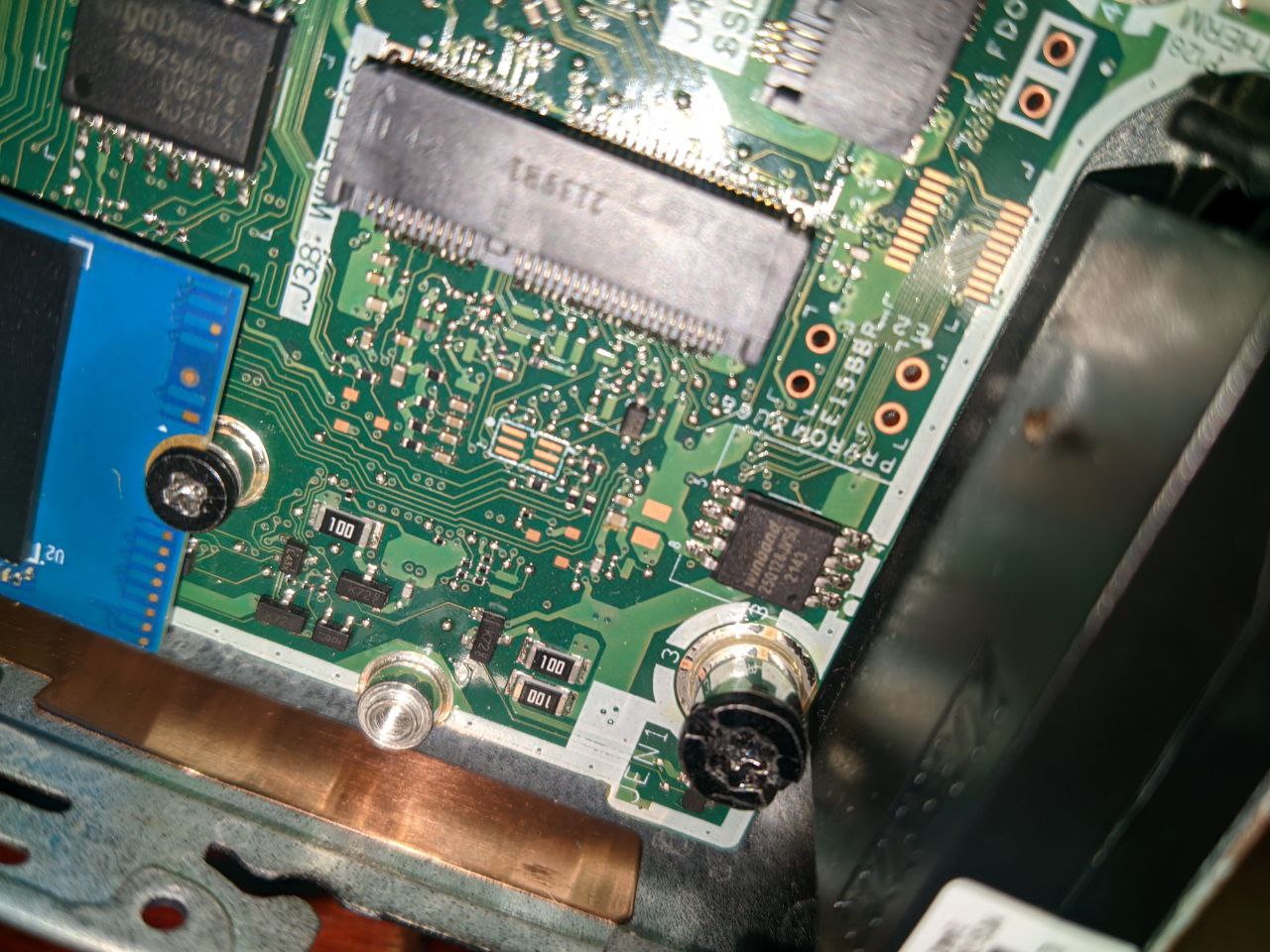

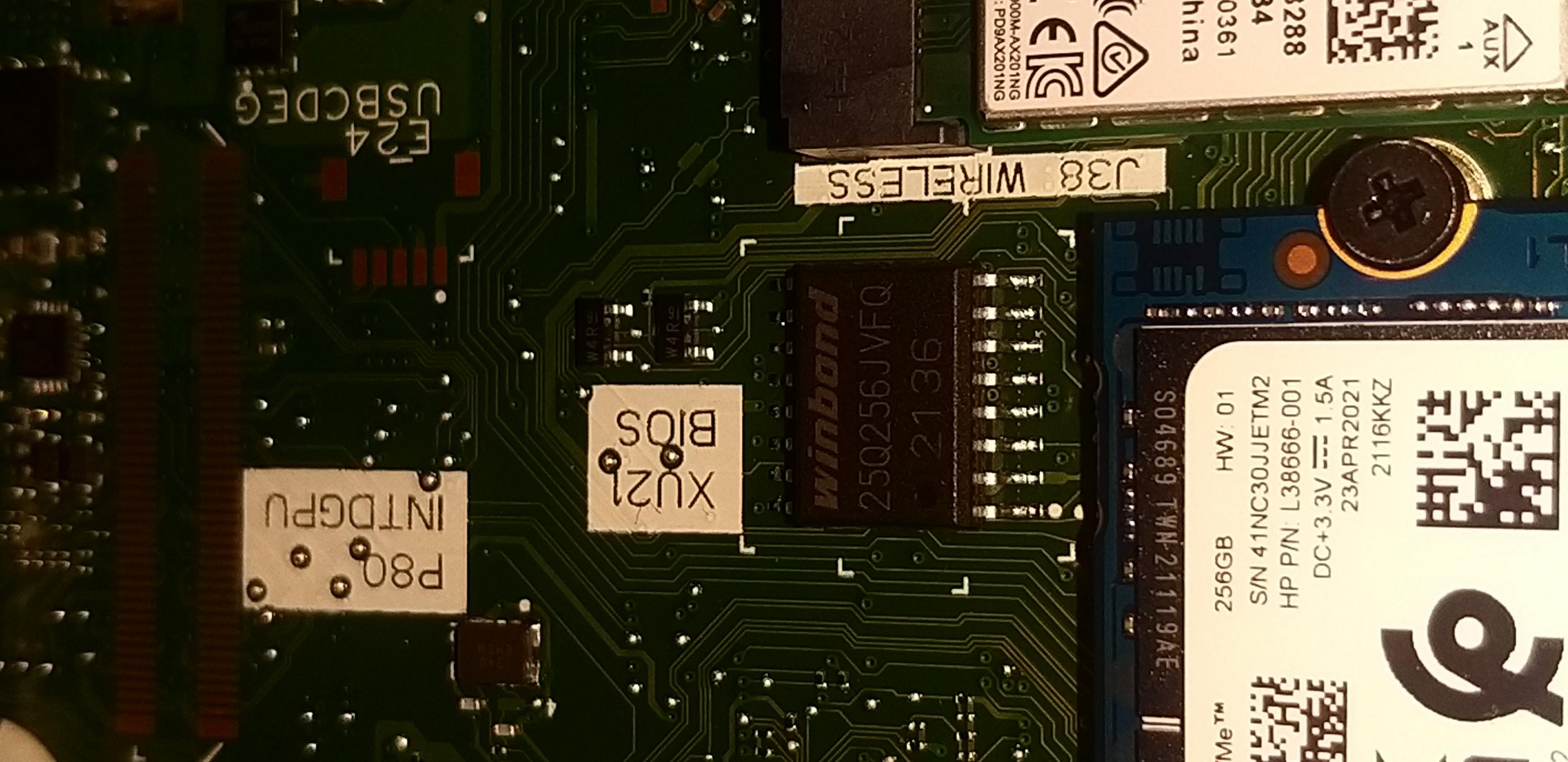

    I cant unlocked bios with jumper
    Can enyone help me...i try everything
    This is picture of jumper and winbond bios chip
    Probably,i must desolder chip and reprogram

    Yes you`ll have to desolder it,unless you have a sop16 clip. Make a few backups and compare them to make sure the backups are the same,then post one of the backups here.
    Edit: did it give you a code on the screen like i12345

      Re: HP ProDesk 600 G6 Mini PC LOCKED BIOS (can't unlocked with Jumper)
      No, without a code...this bios is just like at laptop elitebook G6, 3 mistakes and power off
