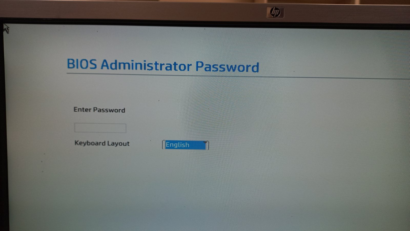

        Re: Help HP PRODESK 600 g6 mini bios file
        Clear my bios pass please!
        • hoaca388
          Badcaps
          • Jan 2022
          • 12318
          Your rar file corrupted, check it.
                    Please excuse the newb questions...
                    What software and hardware are people using on these HP computers?
                    I have an HP 600 G6 SFF that I need to clear the BIOS password. I've tried an EZP2019+ and that wont read the MX25L25673g BIOS chip. I just ordered a CH341a v1.7 with the voltage switch and hoping I have better luck with it.
                    Yes I have the correct 16 pin clip to hopefully do in circuit programming (hopefully).
                    Also any good guide to this whole process? I want to learn to do this, not just ask for someone to unlock my "stuff".
                    Again sorry for the newb questions and slightly (kind of) off topic. I think this is the same chip as the 600g6 mini in this thread and the closest I've found through many sessions of google searches.
                    • Greg_E
                      • Apr 2023
                      • 6
                      #30
                      Doesn't look like I can edit the above post... I finally spent enough time reading around to realize that the main BIOS chip above was not what I needed. I looked under the processor fan shroud and found a Winbond 16MB BIOS 8 pin chip, that one worked with my EZP2019+ and RCUnlocker.
                      I did run into a problem where I had to run the unlocker as admin, so I had to use command line to make it work. In an admin level CMD, navigate to the where unlocker is stored and also where you copied your .bin, and type:
                      rcunlocker.exe yourBIOS.bin
                      Replace yourBIOS.bin with the file name you used and it should work.

                              Hey guys,
                              can someone give me clean Bios and EC file? I unlocked password on EC with RCUnlocker but got the "HP Endpoint Security Controller Problem" Error after. Reset didn´t work and i tried BIOS update with HP software. now im stuck in Update loop and error still exists.
                              Attached is the EC file i read with password.
                              SN: 8CC2230687
                              I also did a second device that worked fine at first attempt.
                              Thank you
                              • hoaca388
                                Badcaps
                                • Jan 2022
                                • 12318
                                #35
                                Originally posted by highping0r
                                Hey guys,
                                SN: 8CC2230687
                                Thank you
                                Upload bios file .

                                  #36
                                  Originally posted by hoaca388
                                  Upload bios file .
                                  Both files that are flashed right now. There might be a mismatch. If you need i can also upload the two chips from the other device that workes. maybe just change the SN and so there?
                                  • hoaca388
                                    Badcaps
                                    • Jan 2022
                                    • 12318
                                    #37
                                    HP ProDesk 600 G6 Desktop Mini PC (5S1F0EC)
                                    • highping0r
                                      • Nov 2019
                                      • 15
                                      #38
                                      worked! thanks a lot
