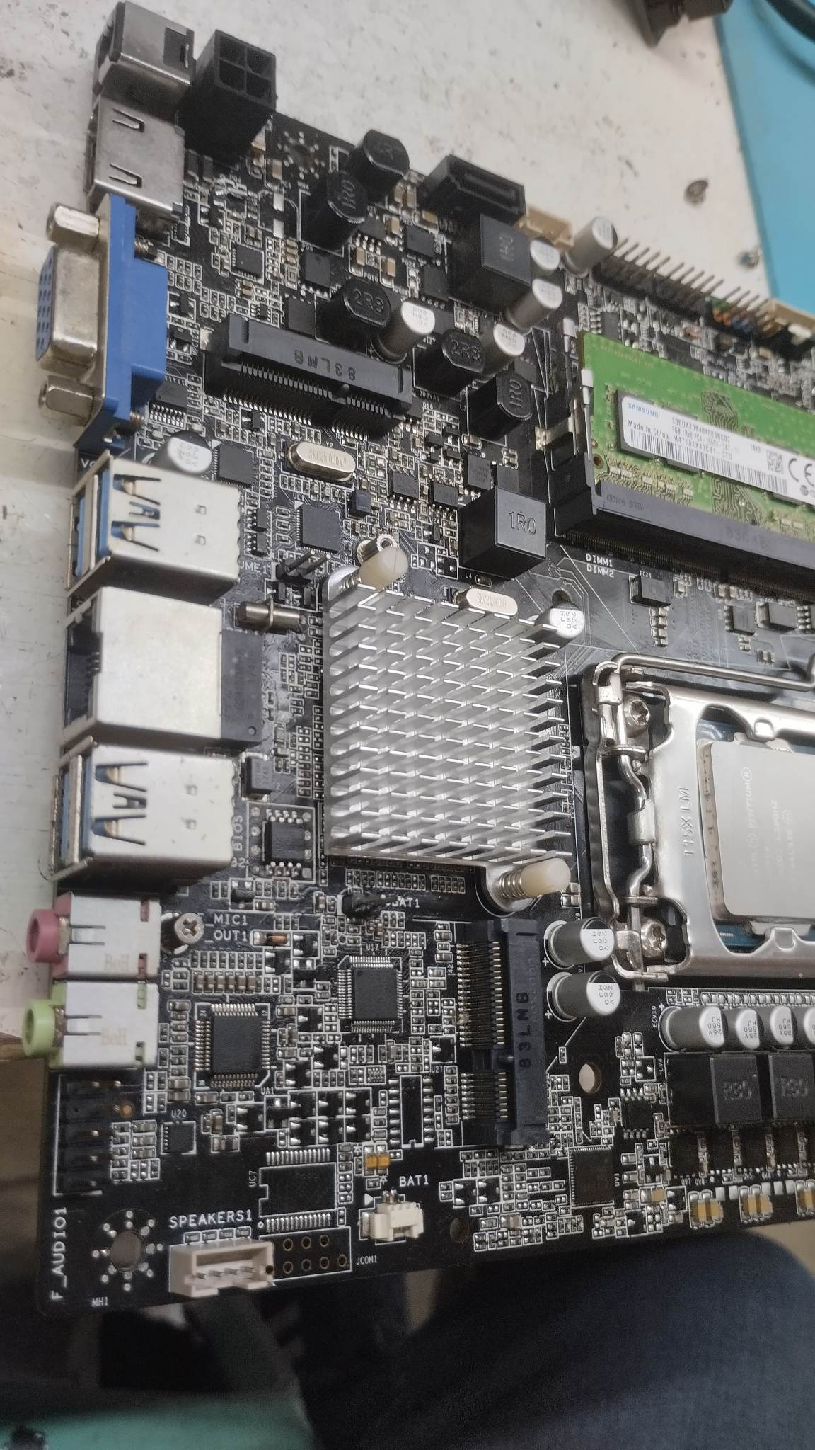

          please help no display bios . there is nothing else to see like this

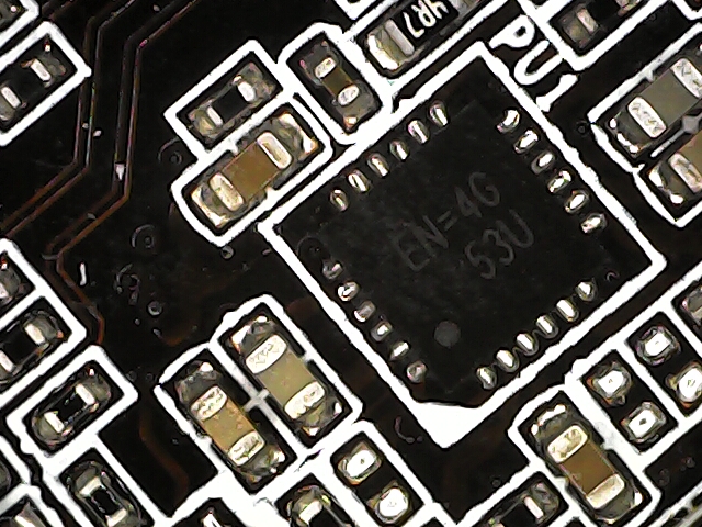

            can you take a picture of the pwm ic on the back side of the HDMI, it is a 18 pins

                Engster, please if you have h110i motherboard, could you please tell me the identification number of the pwm ic Wich is in the back side of the HDMI connector? It is a 18 pins ic,
                I have this motherboard and on the ic is labeled EN=4G then 53U, but there is any information about this IC.

                  Re: hailan all in one desktop pc bios request
                  RT8205MGQW
                    Originally posted by piernov
                    thanks I will buy it, then I will comment
