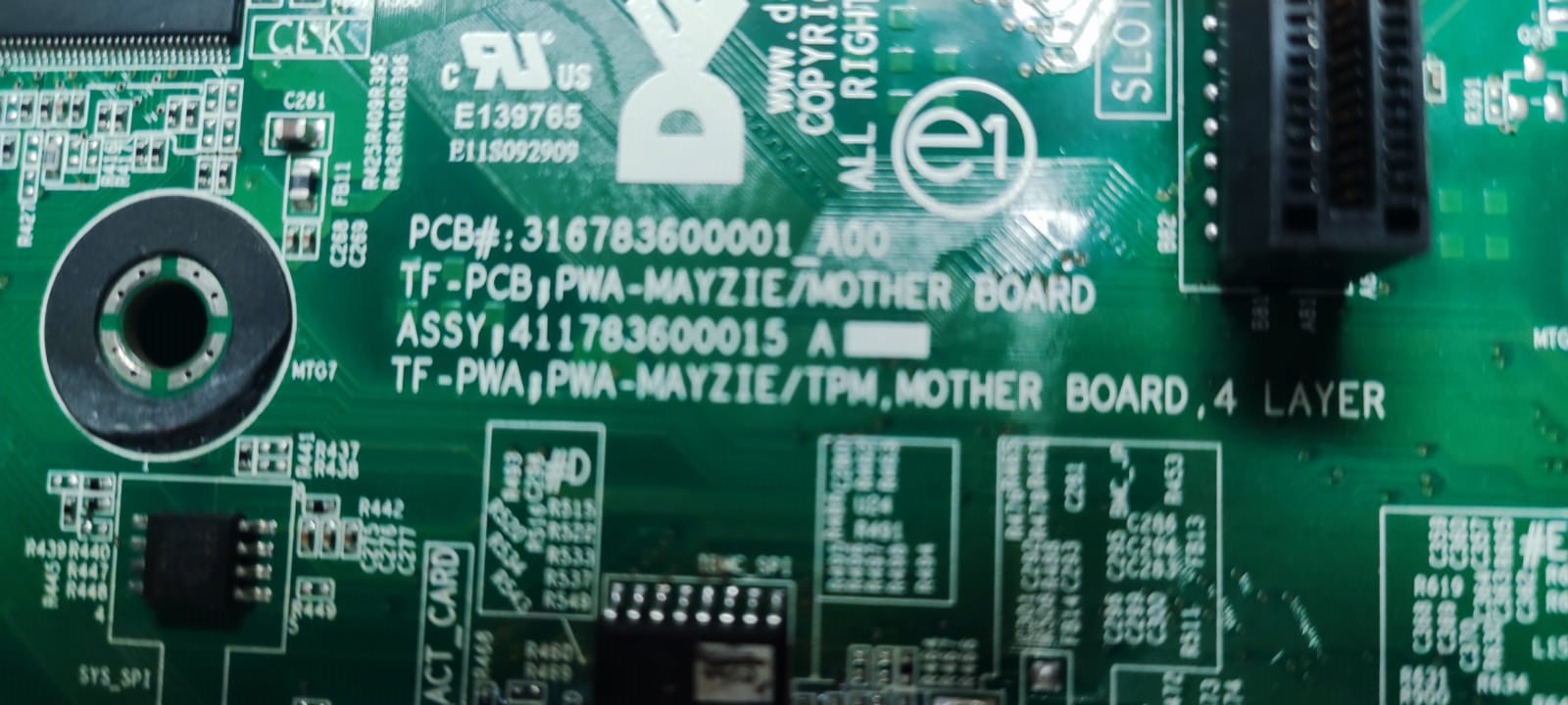

    Re: PowerEdge T110 NEED BIOS
    Board id pic

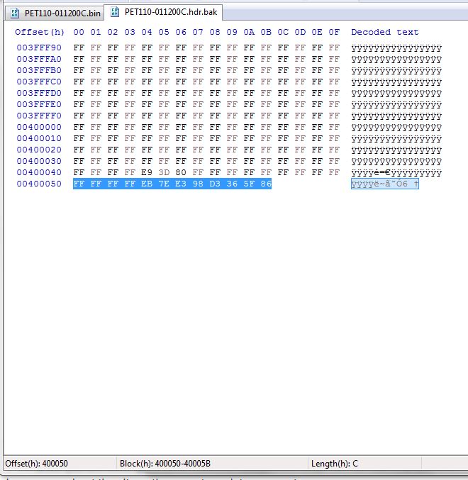

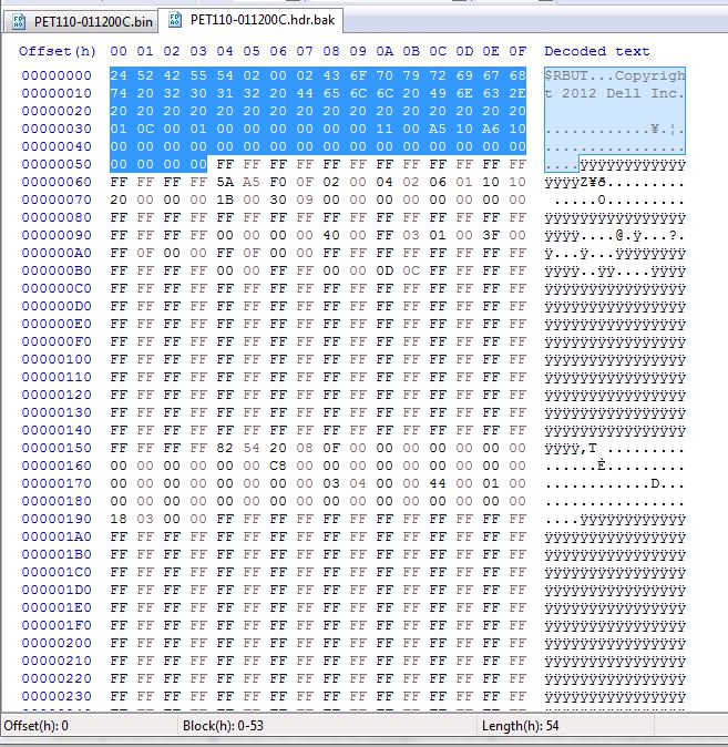

          Download the bios from the support site https://dl.dell.com/FOLDER05075574M/..._1.12.0_01.EXE
          Extract the exe using 7-zip or winrar
          The bios is in the payload folder named PET110-011200C.hdr .It has a hdr header and footer that needs removing
          Download HxD hex editor and open PET110-011200C.hdr https://mh-nexus.de/en/downloads.php?product=HxD20
          Select block 0-53 (length 54) and delete it.
          Scroll all the way to the bottom of the file, select block 400050-40005B (length C) and delete it
          Select save .Close HxD ,rename PET110-011200C.hdr to any name you want,with a bin extension *.bin
          Flash the bios.

                                    i have done alll of this, but i dont understand this line
                                    Especially length c
                                    and in yours given picture why u select only 004000050 line ?????
