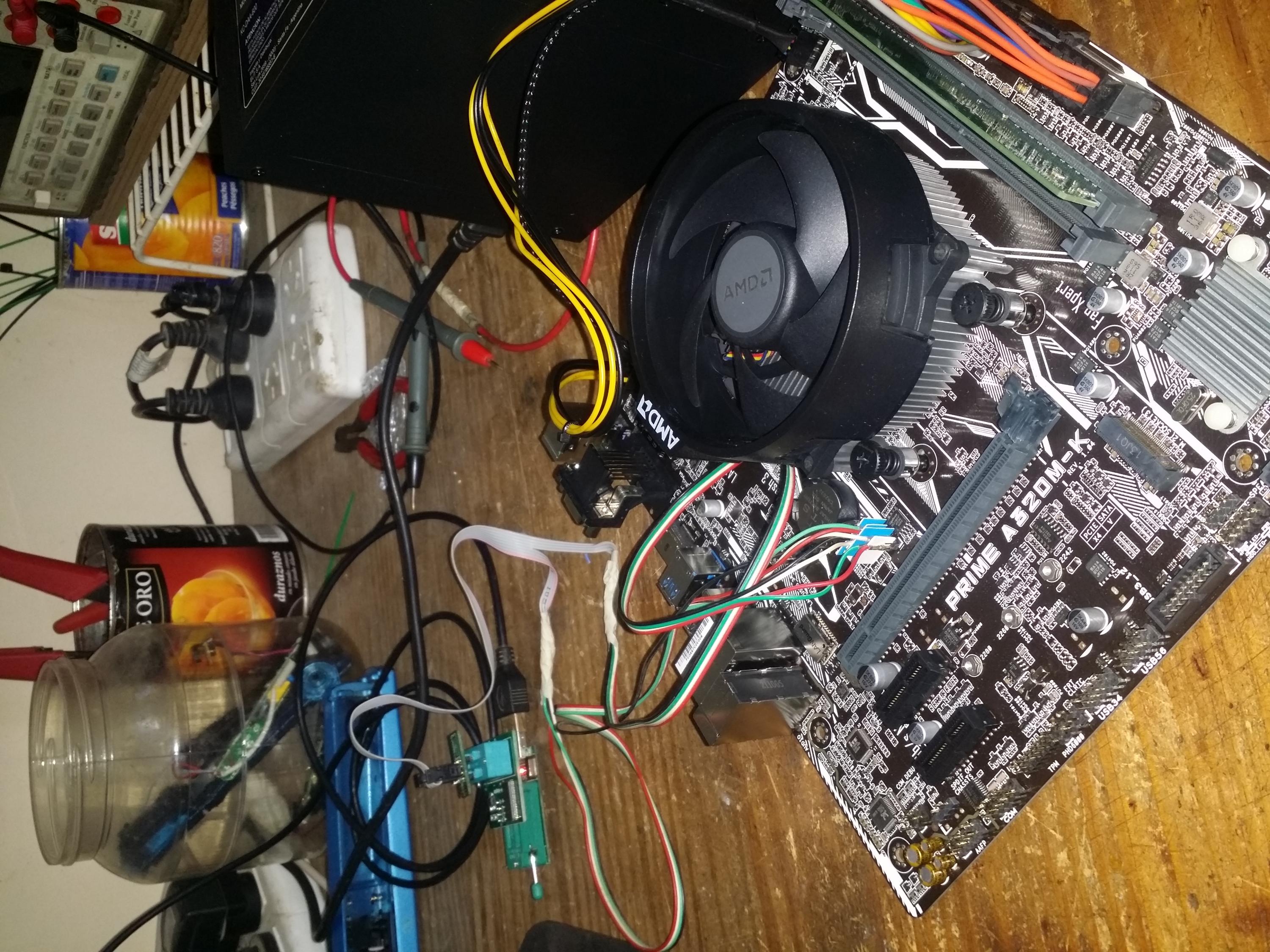

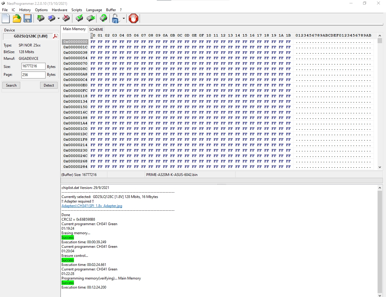

        Re: [Request] Asus A320M-k updated BIOS Dump
        According to Asus CPU support for this board, a Ryzen 5 4600G is supported or validated since BIOS Ver. 5862 so I downloaded latest version 6402…
        I connected my CH341A (Green) programmer with 1.8V adapter to the board.
        I identified pins as follows…
        Then I fired up NeoProgrammer V2.2.0.10, identified chip as Gigadevice GD25LQ128C [1.8V] and read data successfully and saved backup…
        OK so then I opened the updated BIOS CAP with UEFITool NE Alpha 59 , then - right-click onto the listed “AMI Aptio capsule”, choose the option “Extract body…” and save it as *.ROM file. (File size 16,384 KB)
        I then erased and verified blank chip with NeoProgrammer successfuly, then opened new *.ROM file and flashed, Successfully… I removed programmer cables, installed CPU and powered up… :frowning_face:
        It didn´t POST, boot or display anything (Fans running)
        I also have tried with no luck, manually editing *.CAP file with HxD and removing first 2048 bytes and saving as *.ROM, I also tried Asus CAP to Bin Tool to create *.ROM file, I tried flashing with CH341 programmer original soft, with AsProgrammer I even flashed with Flashrom for windows, in all cases no errors where displayed… yet Mother Board refuses to POST…
        SOOO! What am I doing wrong!
        what is the proper way to do it…
        Any help would be greatly appreciated…

          Take the CMOS battery out before programming ,and use the clear cmos jumper afterwards. UEFITool has removed the CAP header ok 0 - 7FF (LENGTH 800)
            Not Quite sure what you mean by (LENGTH 800) but I believe so....

                  Well I reflashed everything as instructed and no luck!
                  No video, post, beeep nothing just amber LED and CPU come on...
