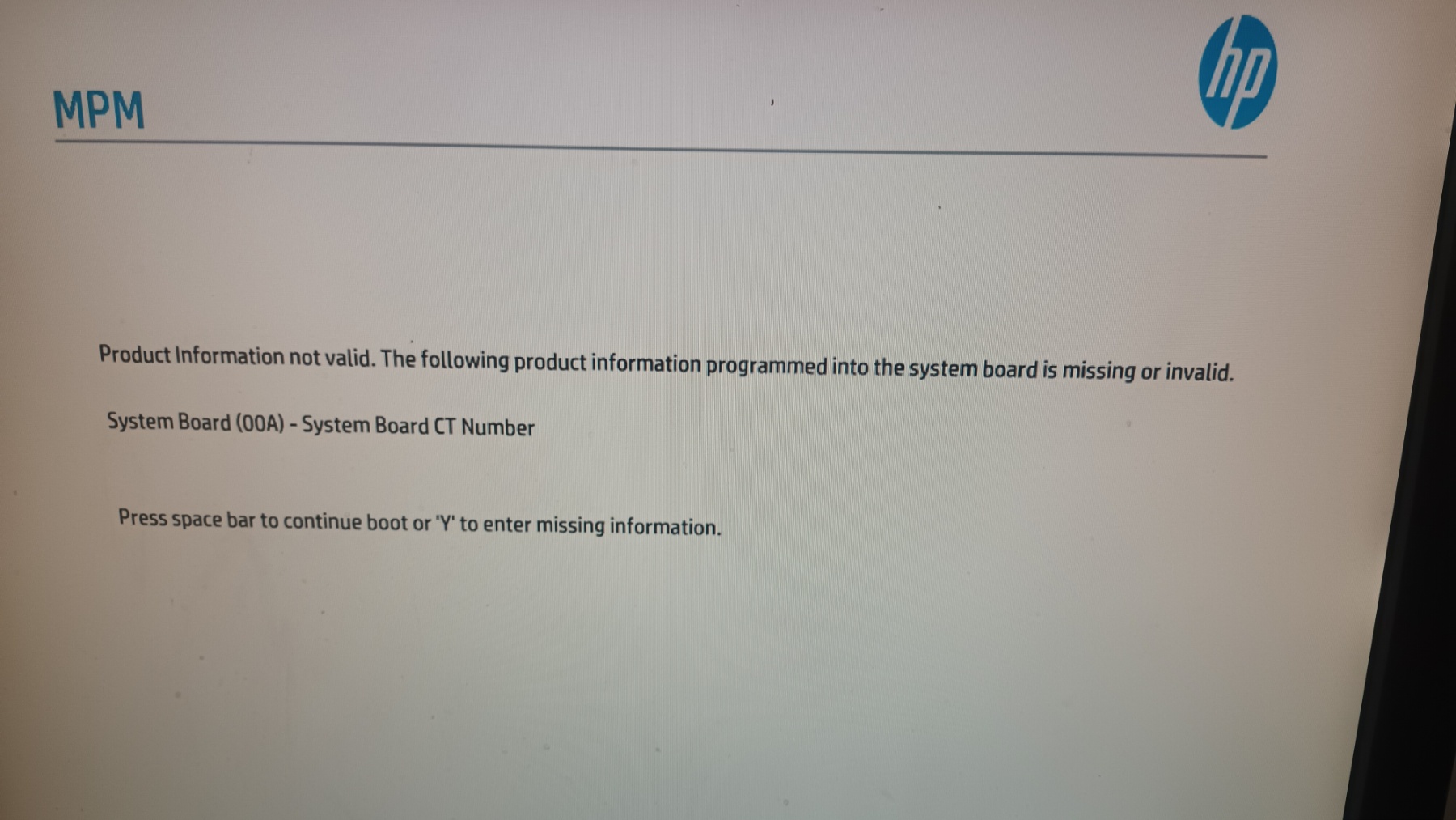

                    I programmed the BIOS with this file.
                    At startup I have inscriptions:
                    "WARNING Machine is not in committed state.
                    System is booting in manufacturing program mode 28"
                    Then it loads normally.
                    How can I fix this?

                        Re: ms-7957 ver 1.0 HP ProDesk 490 G3 bios
                        I can't find this tool. I see it is for specific laptops.
                        My system is as follows:
                        HP ProDesk 490 G3 MT Business PC
                        SN: CZC61498SM
                        Prod.N: P5K11EA#AKS
                        motherboard ms-7957 ver 1.0
                        I used a file
                        MX25L12805D@HP ProDesk 400 G3_ME_Cleared.rar
                        by "abdnassar" #3
                        The inscriptions
                        I can't remove them.
                        Please help!

                            • hoaca388
                              Badcaps
                              • Jan 2022
                              • 11813
                              Originally posted by vank
                              This is the original BIOS.
                              But with it the computer stopped working (black screen)
                              So I had to program it.
                              HP ProDesk 490 G3 Microtower PC
                                    Hi hoaca388!
                                    I tried your BIOS and it works.
                                    Only at startup I get a message:
                                    "Product Information not valid. The following product information programmed into system boards is missing or invalid.
                                    System Board (00A) - System Board CT Number
                                    Press space bar to continue boot or 'Y' to enter missing information."
                                    I have nowhere to get this CT Number.
                                    What would you advise me to do?
                                    • hoaca388
                                      Badcaps
                                      • Jan 2022
                                      • 11813
                                      hi hoaca388!
                                      I tried your bios and it works.
                                      Only at startup i get a message:
                                      "product information not valid. The following product information programmed into system boards is missing or invalid.
                                      System board (00a) - system board ct number
                                      press space bar to continue boot or 'y' to enter missing information."
                                      i have nowhere to get this ct number.
                                      DMI supplement
                                      • vank
                                        • Feb 2012
                                        • 11
                                        • Bulgaria
                                        DMI supplement
                                        Hi hoaca388!
                                        Many thanks for the latest BIOS!
                                        Works perfectly!
                                        Congratulations on a wonderful job!!!
                                        I have the following question regarding the BIOS:
                                        In the original BIOS, I have an OEM Windows 10 serial number.
                                        Can I get it into this new BIOS?
