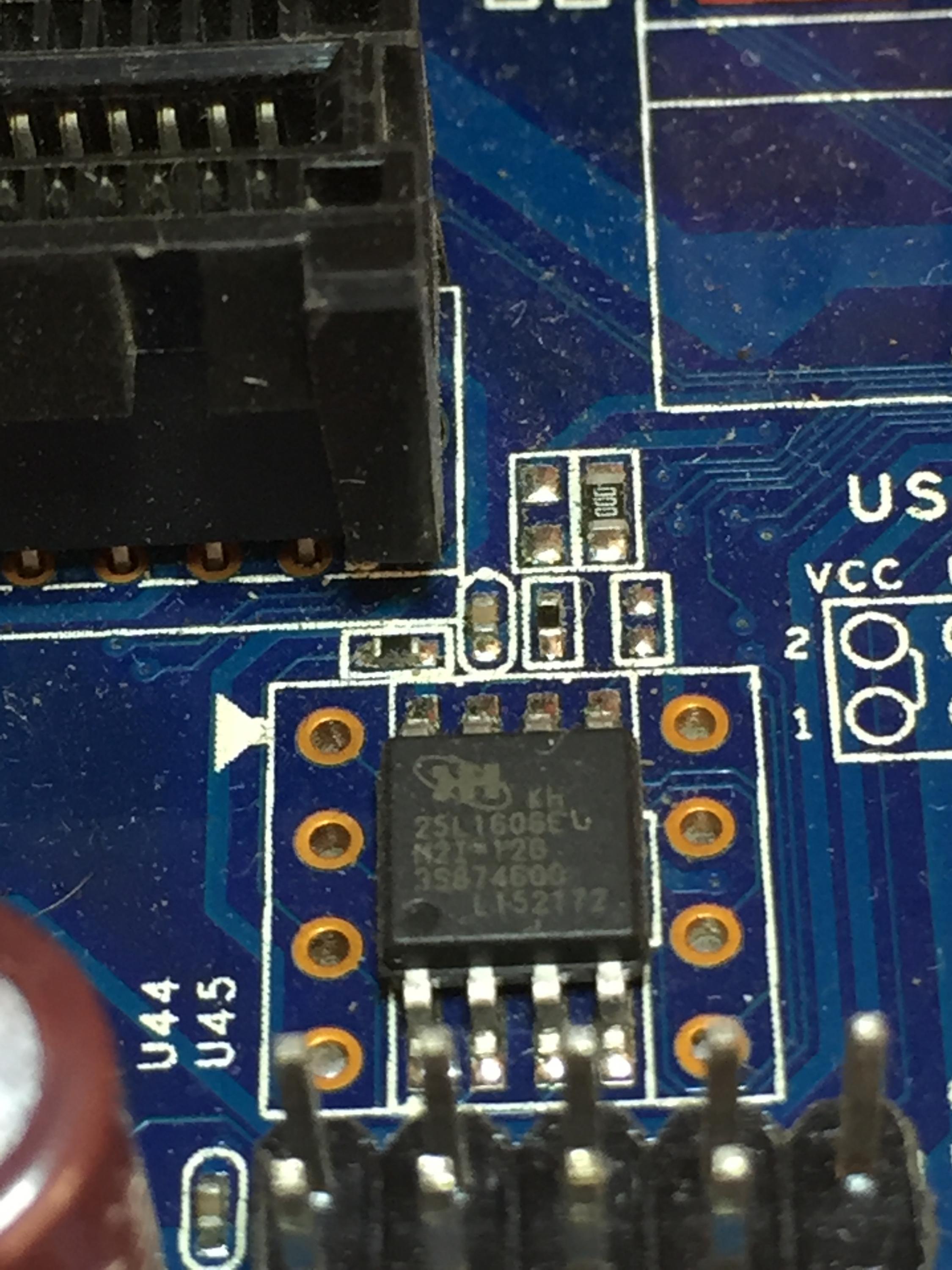

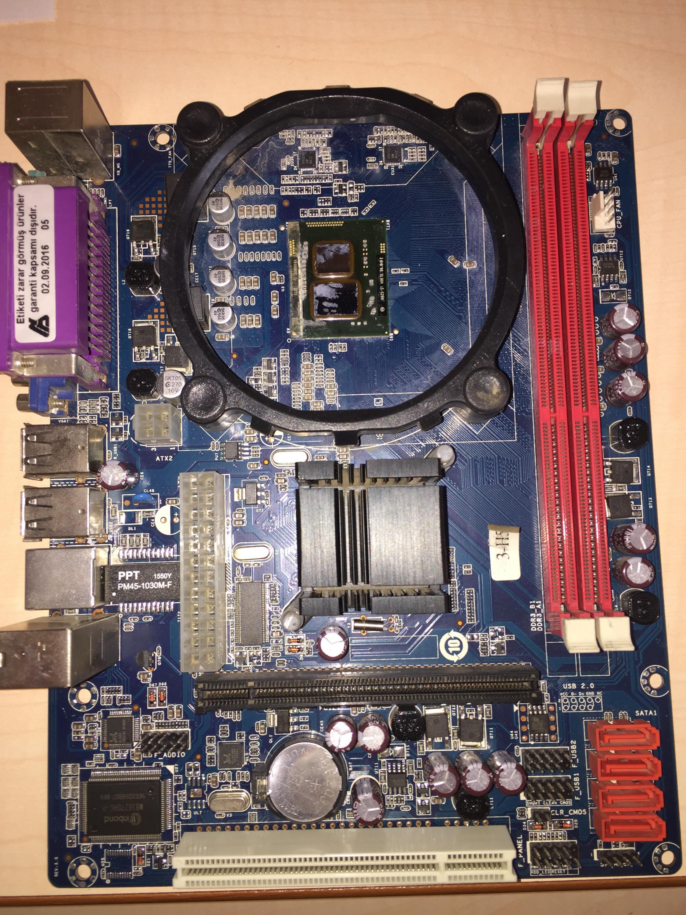

    Hi guys, I need a help. The mainboard I showed in the photo has a problem with the BIOS. But this mb is OEM. (Label: 3-H55+i5) ?
    How can I find? Thanks.
    Regards.

        Your backup dumps are both 1KB too long,also they are both badly corrupted. Are you using a CH341A programmer ?

          Yes sir,CH341A programmer.
          I'm uploading again

            Detail:
            American Megatrends Inc.
            Version: 080015 // INP55001
            12/21/15

              The bios backup is better than the last ones but still corrupt.Are you using a clip or have you desoldered the chip ? .Try NeoProgrammer software and make another backup - https://www.badcaps.net/forum/showpo...04&postcount=7

                Nope, Same again.

                  have you desoldered it ? or are you using a clip

                    Nope, using Clip.

                      It would be better to desolder it.If you don`t have a hot air station you can still desolder using a soldering iron.Run the soldering iron with flux and solder accross 4 pins on one side while lifting slighty with tweezers until its just clear of the pads,then do the same at the other side. Then put the chip into a sop8 adapter, if you have one.

                        Thanks for interesting. I probably won't find
