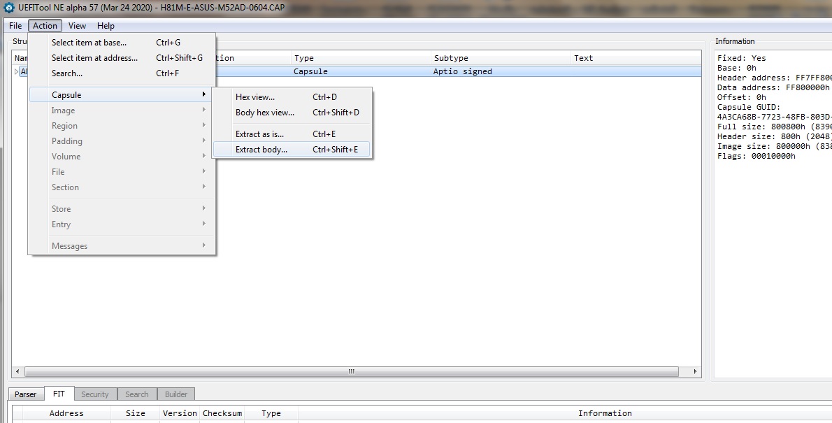

    Hi . I need H81M-E/M52AD/DP_MB bios dump. please help
    thanks.

    case asus K31ad

        Download the bios from the support page,open the bios with UEFITool , select "Action - Capsule - Extract Body" that will remove the 2KB header from the 8,194KB bios leaving you with the 8,192KB bios .
        https://dlcdnets.asus.com/pub/ASUS/D...K31AD-0604.zip
        https://www.asus.com/Tower-PCs/K31AD/HelpDesk_BIOS/
        https://github.com/LongSoft/UEFITool..._A57_win32.zip

          thanks. its tray
          • kesmeseker
            • Jan 2015
            • 121
            • turkey
            Re: H81m-e/m52ad/dp_mb
            thanks working.SMDFlea
