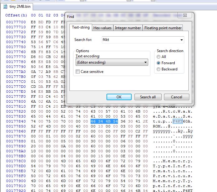

                            Is this bin file will work with Lenovo M72e, Machine Type 3598??
                              • 21914
                              Re: Lenovo M72e, Machine Type 3267, IH61I Bios
                              There are 3 different bios versions for the M72e models .Open your bios backup with a hex editor and search for these keywords to find which version you need
                              F1KT , F4KT , F9KT
                              ThinkCentre M72e (Ivy), ThinkCentre Edge 72 (Ivy) and Lenovo 62 is F1KT***
                              ThinkCentre M72e (Tiny) is F4KT***
                              ThinkCentre M72e (PCI) is F9KT***
                              The bios at post #8 is F4KT
