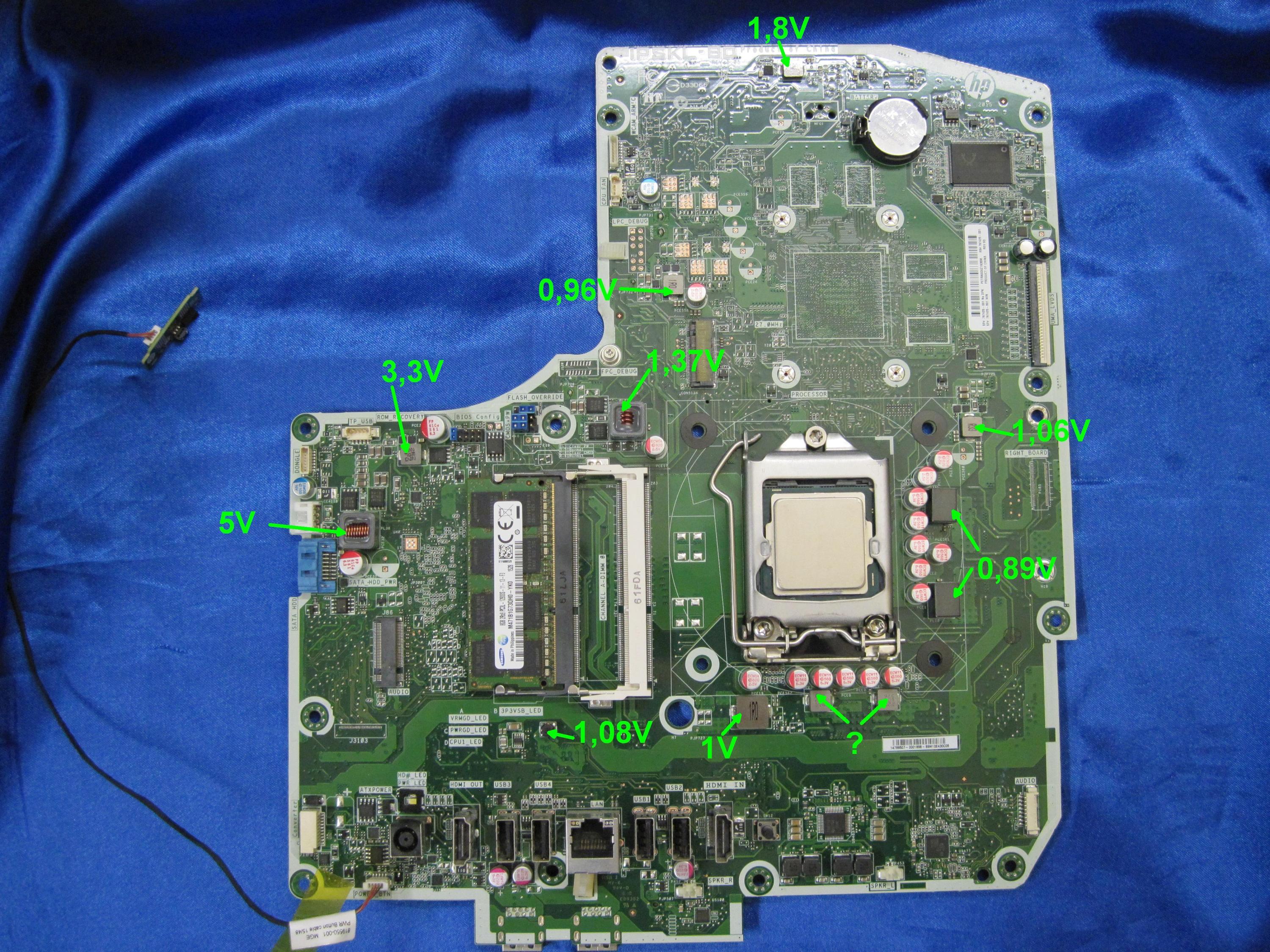

    I need a Bios DUMP.
    The computer starts without a picture, after turning on it makes sounds:
    8 long beeps and 2 long beats with a slightly lower tone, then several times 2 long and two short beeps followed by silence.
    The LED on the power key behaves similarly by flashing in this sequence.
    The basic voltages on the chokes look correct, only two parallel are missing in the processor area. I suspect that they are responsible for supplying graphics to the processor. The fan works as if it were normal. BIOS reset done, processor replaced (bought on Allegro) and DDR3 memory.
    Thank you in advance for your help.
    Layout cast:
    CPU: Intel Core i5-6400T SR2L1
    PCH: Intel GL82H170 SR2C8
    GPU: BRAK
    KBC: IT8528E FXS
    BIOS IC: MX25L6473F M2I (64Mbit = 8MB)
    BOARD: IPSKL-BD rev: 1.05
