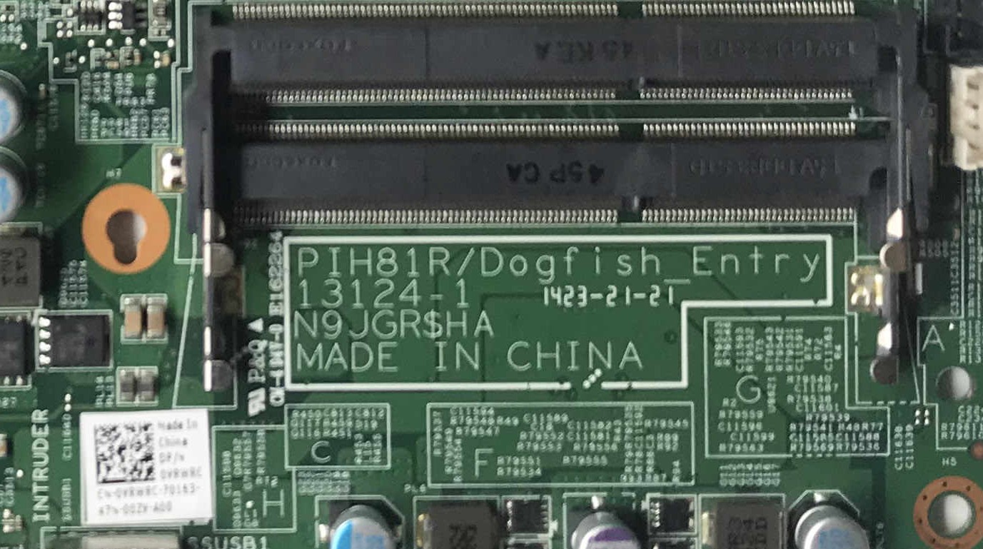

    Hi, help me to find a dump bios for dell 3020M (Micro model).

                          The bios you tried from vina,plus the one i posted should be the right one for your board PIH81R / Dogfish .Can you check your board part number ,and your CPU, you should have an I5-4590T .Its no good using a frankenbios ,as there are no fan headers on the M version afaik.

                              Re: Request DELL 3020M bios .bin
                              Attach motherboard picture
