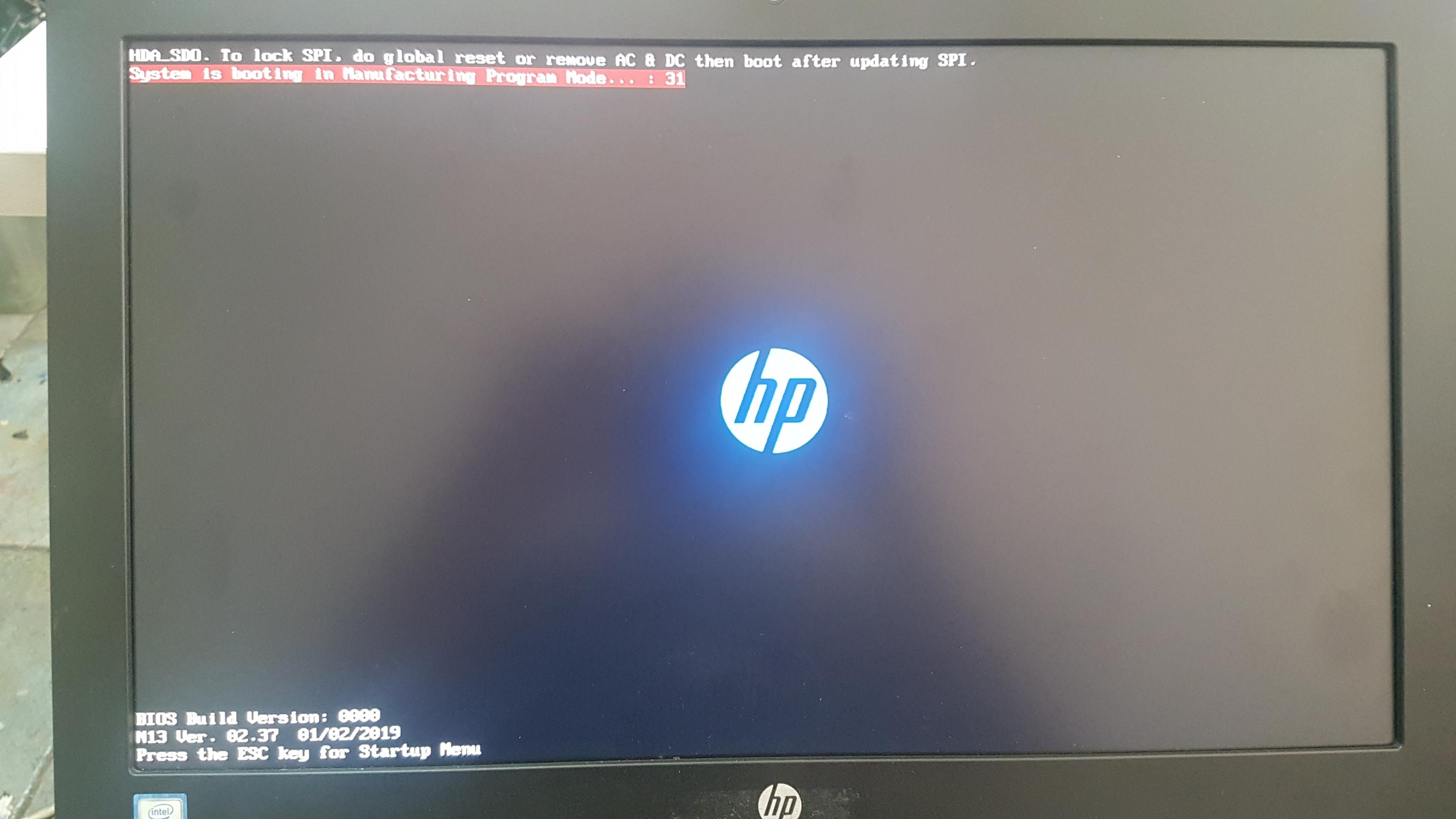

    Hp pro one 400 G2 PCB: 6050a2716601 A01
    Bios update and restart. No video screnn help me.

      Re: Hp pro one 400 G2 PCB: 6050a2716601 A01
      Try this bios.
      power on and video screen : manufacture programming mode is in unlock mode (34) .....
      0 and no power
          Originally posted by SMDFlea
          Try this one .
          problem persist

              i shared pictures
              When it is 0 it does not open again
                    Red error gone about restart more 31 time you can add manually serial number or dmi info..
                    And show Serial number error?
                    • mcplslg123
                      • Jun 2015
                      • 7262
                      • india
                      Yes, @imranromi is correct. Has faced this on a couple of HP's. You dont need to do anything. Just flash bios and let the pc restart a total of 31 times and after that . the red line will go away and it will boot normally. You need to add dmi info only after that.
