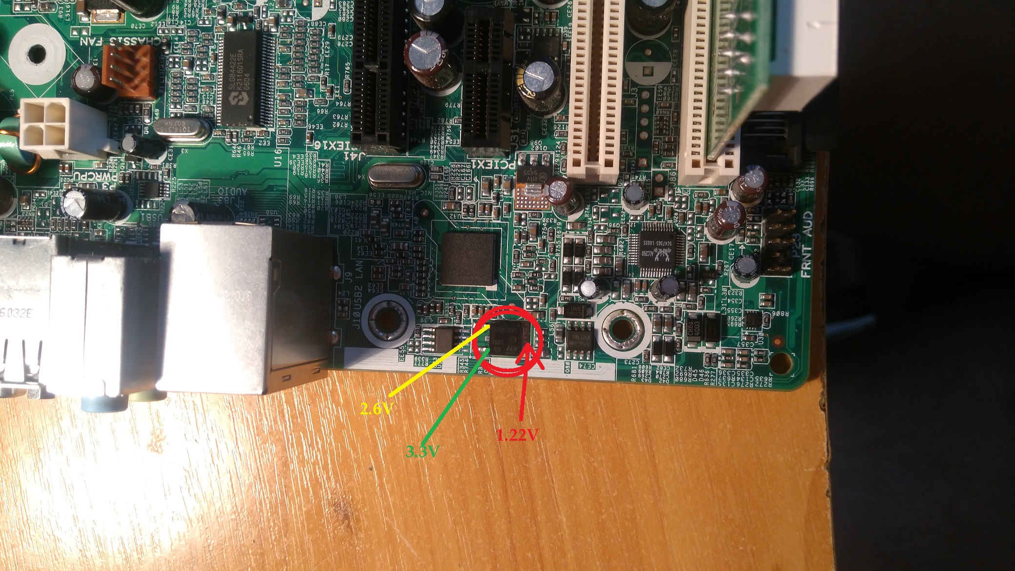

    have this HP P5LP mainboard that wont work.
    with processor power cable it start for half of seconds and without it for two seconds.
    dont have short anything on CPU power, no mosfet shorted, even with psu it didnt draw current
    without cpu power i check all power rails and looks good expect some ST D888 power transistor that have 1,22V output.
    Dont have schematic or boardview to check wat is supplying but i dont think 1,22V is something usual voltage.
    Any hint on this?

                  that 1.22v may be a problem.... look around that transistor for some driver (maybe gone bad) adn try to replace
                  other than that, you may shot black and green on psu connector and then measure, or test with good old finger if something is heating... my bet is on LAN chip.... in my country there is a lot of power surges so either sound or lan chip goes bad.... removing it from board fixes it
                  hope it helps

                    i look on boardview and that tranzistor is on 1.2V line so it looks ok
