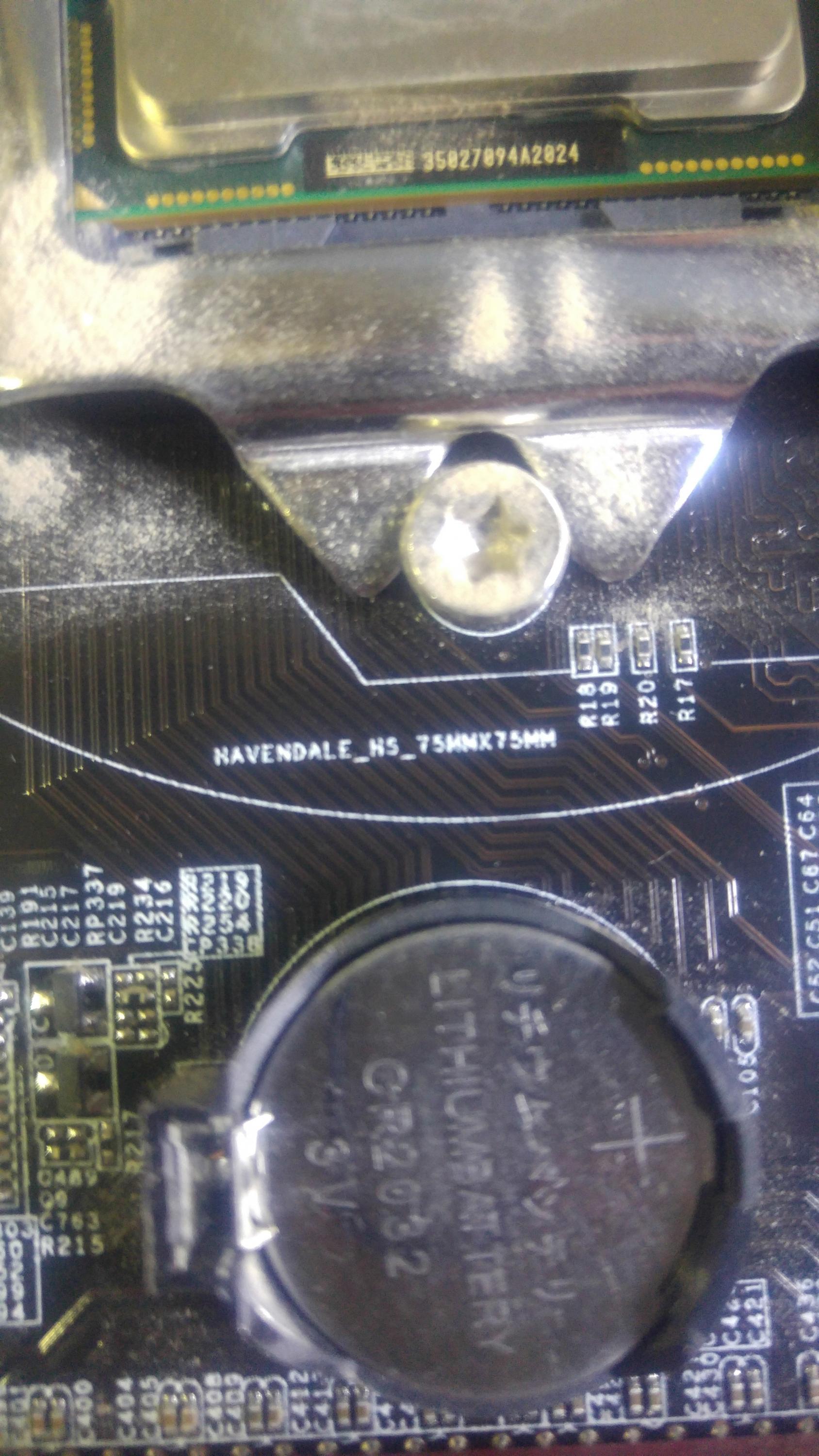

    desktop computer bios havendale_hs
    my friends
    desktop computer bios dump
    mainboard:havendale_hs_75mmx75mm
    2mb dump
    25l1606e flash

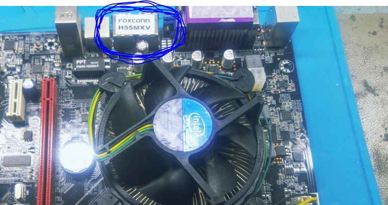

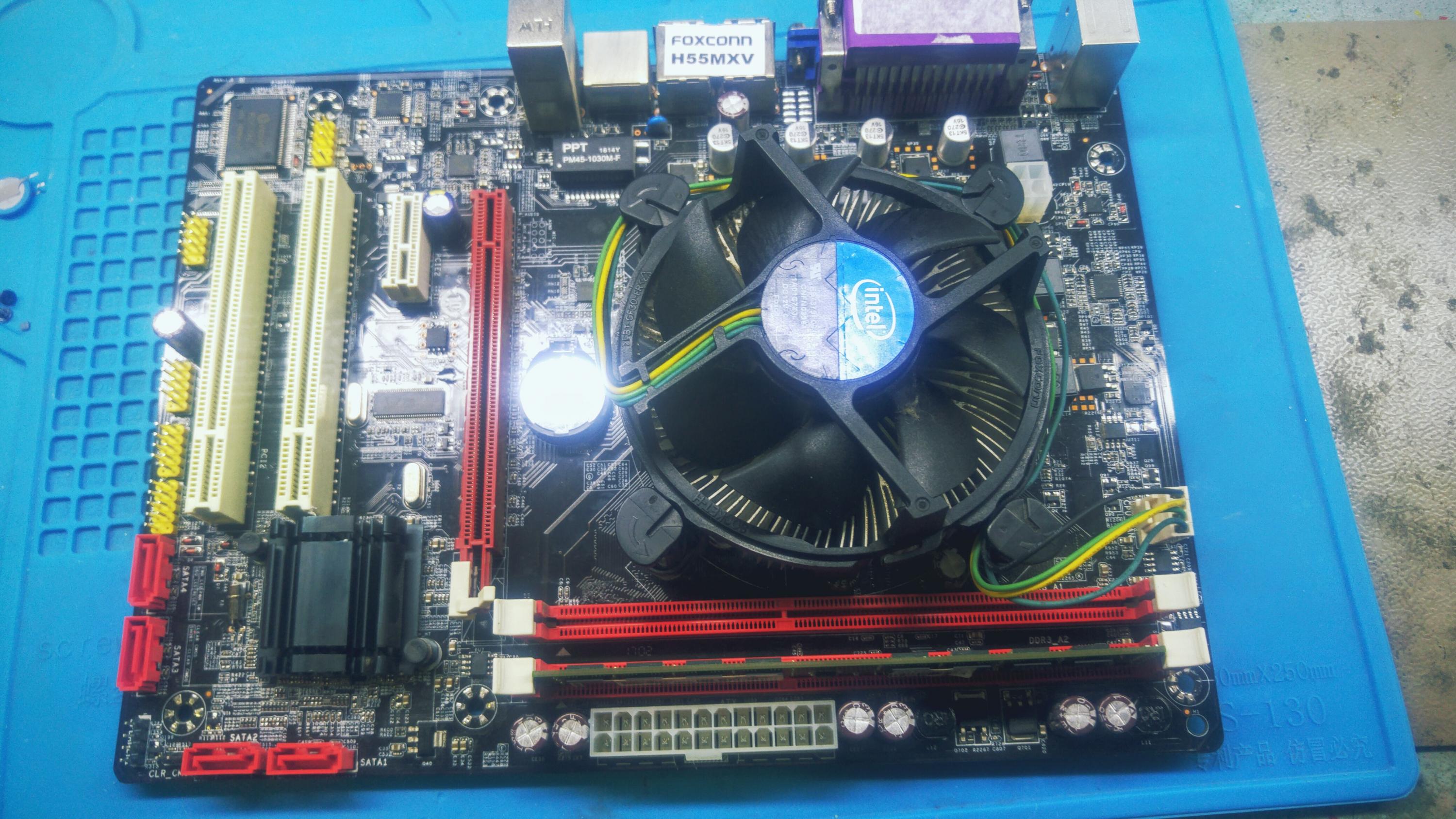

    Re: desktop computer bios
    What pc model did this motherboard come from,the motherboard label is h55MXV ,its made by foxconn. The bios is 8MB
    http://www.foxconnsupport.com/downlo...keywords=&sort
      my friend has 8mb and 4mb file.
      my file is 2mb
      mx26L1606E
          my friend
          vendor foxconn
          FOXCONN LENOVO G41R L-IG41M DDR3_G41T-LMF(R63007) could this model be
            • 21850
            No, the G41R L-IG41M is socket 775 .
            Don`t you have the PC that the motherboard came from or are you just trying to repair the motherboard on its own.
            There may be some info in the bios, if you can post it i`ll have a look.
            EDIT: I looked at google images for the foxconn h55MXV ,they all have yellow pci-e sockets and a different layout. Are there any labels or silkscreens on the motherboard near the RAM sockets .

                • 21850
                Originally posted by asliyucegsm
                Uploaded from own site Bios deleted
                What do you mean the bios is deleted. Your posted bios is 2,049 KB ,i trimmed it to 2,048 KB but can`t fix the ME area as theres no bios region. Is there another bios chip ? Also ,what PC did this motherboard come from, i asked already you but havn`t havn`t said .
