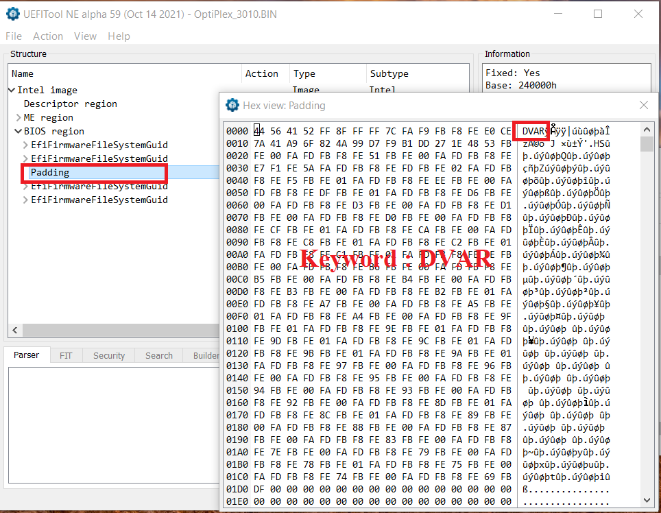

                            #33
                            Need bios Dell optiplex 3010
                            Need bios dell optiplex 3010 or repair bios
                            Board code MIH61R MB 10097-1 48.3EQ01.011
                            Service tag 2X89H5J
                            bios backup

                              #34
                              Re: Need bios Dell optiplex 3010
                              Service tag 2X89H5J
                              bios backup
                              Sir my board bios is 8mb
                              And aboce posted bios are 4mb
                              Anybody pls repair my bios

                                #35
                                Service tag 2X89H5J
                                bios backup
                                Dell OptiPlex 3010
                                Service tag: 2X89H5J
                                Any donations to Badcaps are welcome. Become a Badcaps supporter >>>>> click this link to donate <<<<< Thank you to all the supporters. -- -------------------------------------------------------------------------------------------------------------------------------------------------------------

                                  #36
                                  Originally posted by hoaca388
                                  Dell OptiPlex 3010
                                  Sir how u did it???
                                  And if i have 10 system dell optiplex 3010, and if i save bios from one of them, and may i use it to other 9 same model systems, even they have diffrent service tags???
                                  Or before programming bios to other same system, i should edit bios to enter thier own service tag no???

                                    #37
                                    Re: Dell OptiPlex 3010 bios
                                    The fastest way is to copy the DMI from the old file to the new file (the one I posted). Backing up the original bios file of each device is a very important step in bios editing. Do not skip this step.

                                      #38
                                      After opening bios in HxD
                                      How i can know which part of bios is DMI (Desktop Management Interface) part ????
                                      i means which part of old bios should be copied to new extrated bios???

                                        #39
                                        keyword : DVAR
