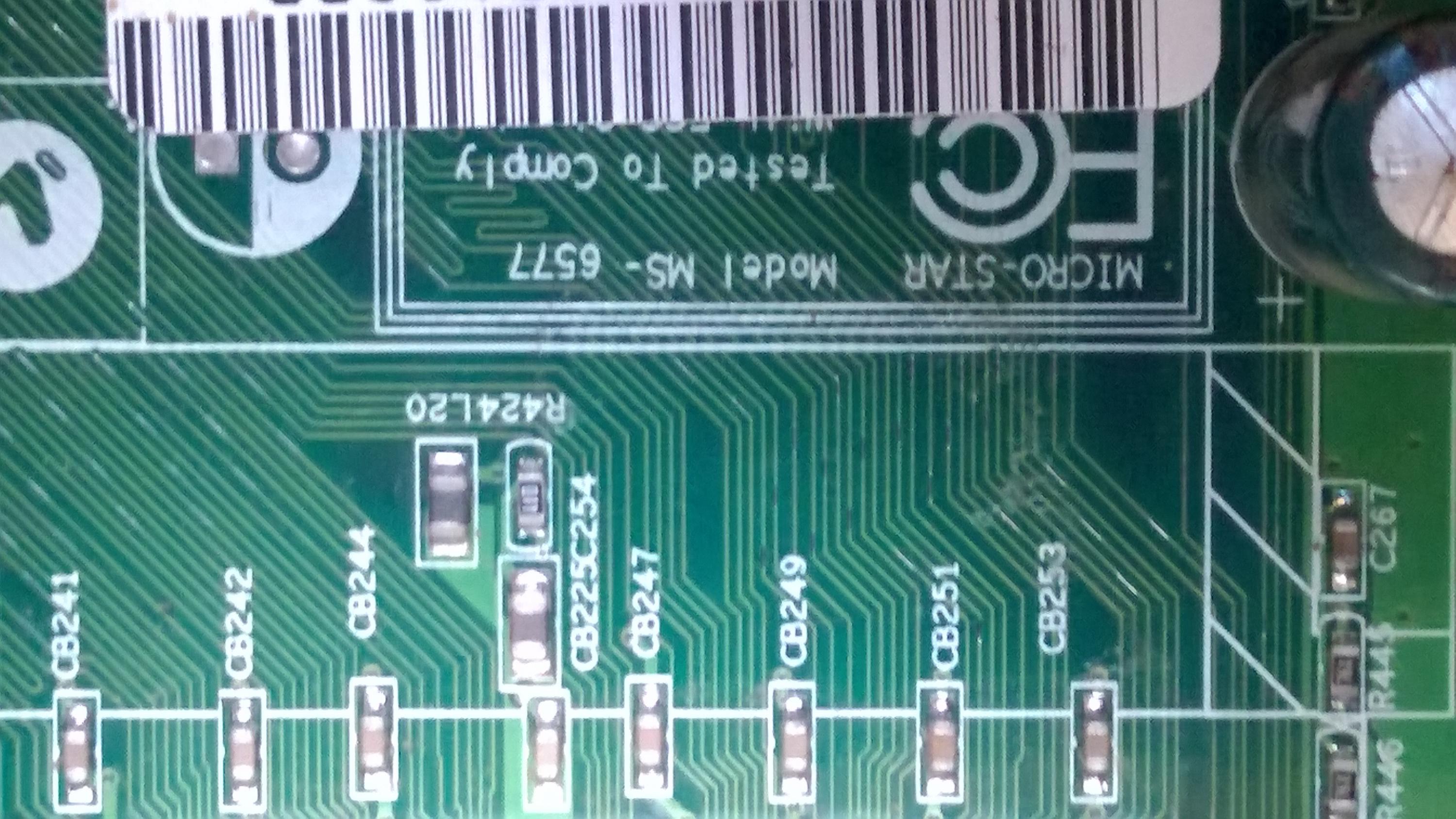

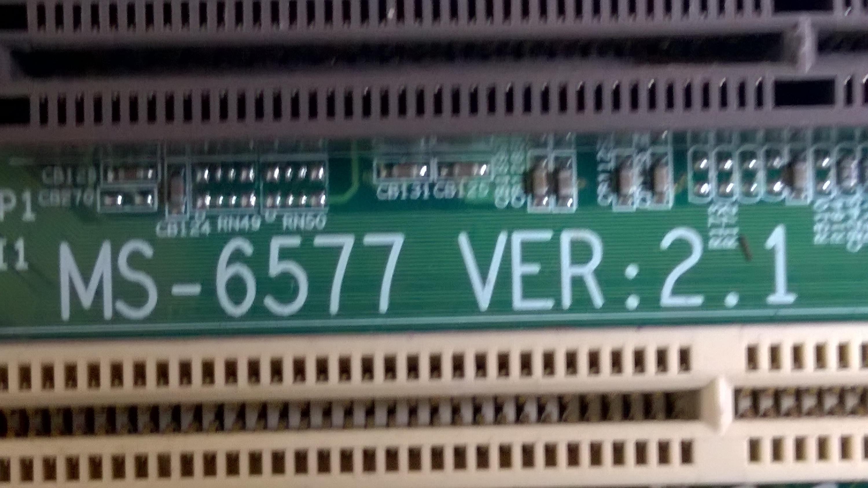

    microstar model :MS-6577
    version :2.1
    i need bios pls send

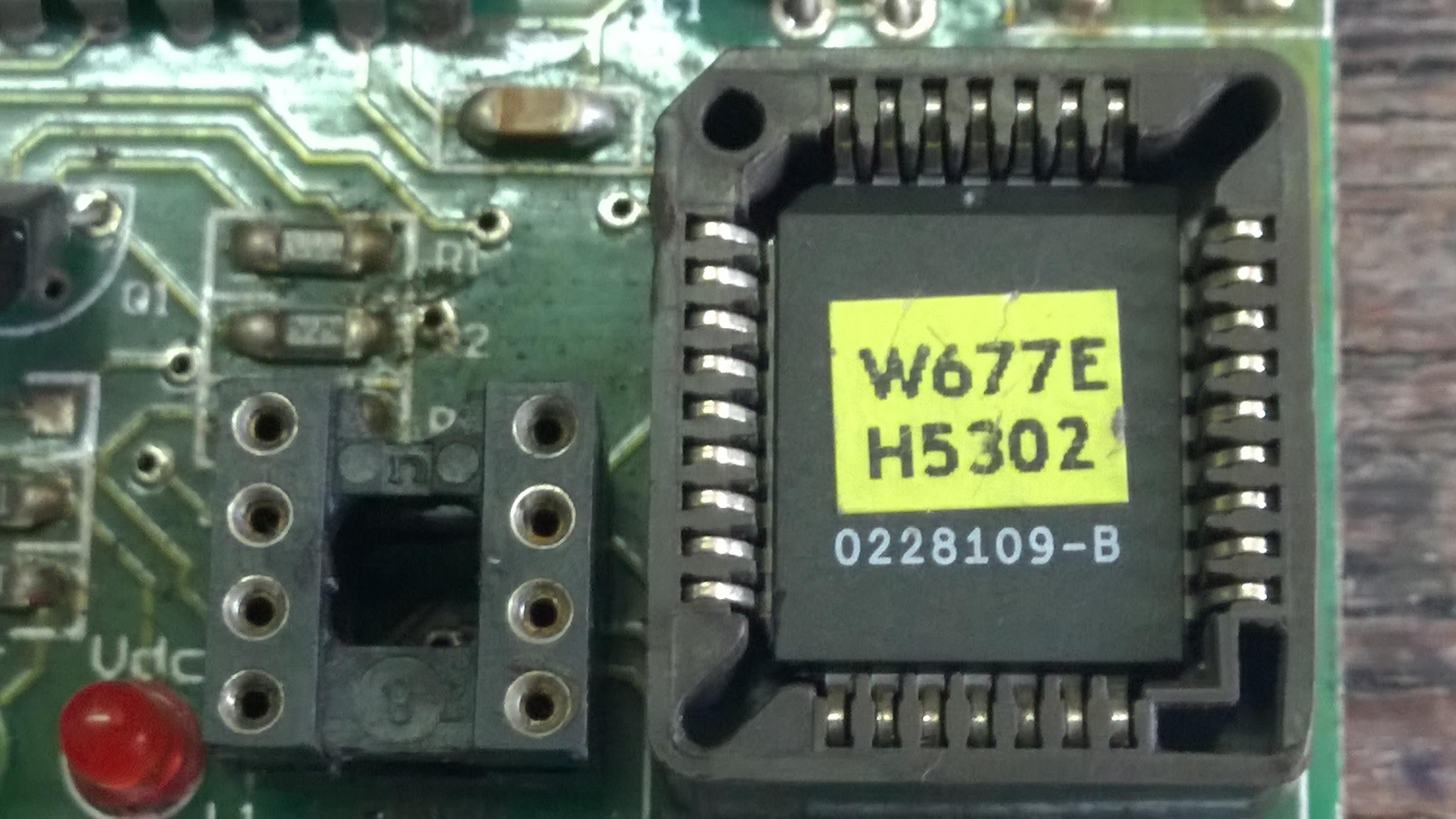

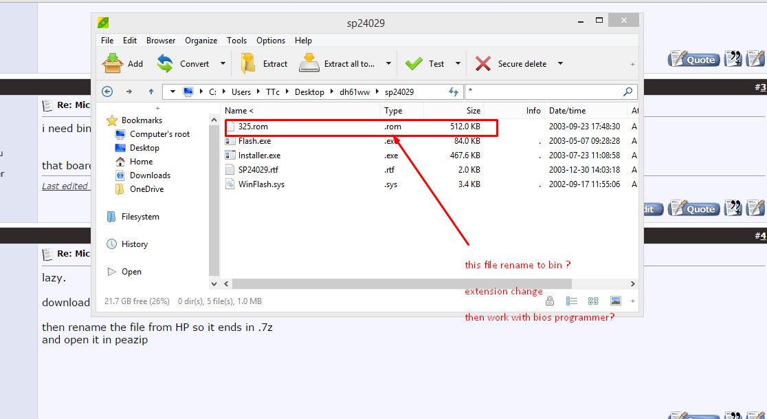

      i need bin file for bios programmer
      that board working .but no dispaly pls send bios file

        Re: Microstar desktop board
        lazy.
        download peazip http://peazip.sourceforge.net/
        then rename the file from HP so it ends in .7z
        and open it in peazip
        • balattc
          • Feb 2015
          • 153
          • india
          this file rename to bin ?
            • 31246
            that's the one, yes.
