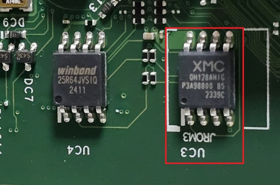

    Hello guys,
    Can a kind soul please help me with a dump file for:
    Lenovo IdeaCentre AIO 3 27IRH9 Type F0HM
    SN: MP2B7K7A
    Thanks in advance!

    post the contents of the bios chip even if it is corrupted..

      I have updated the backup from the XMC chip, I think that is the bios. I'm not sure about the Winbond chip though, there are a few of them on the board.

        Backup and post the other one as well, UC4

          I have uploaded the UC4 backup

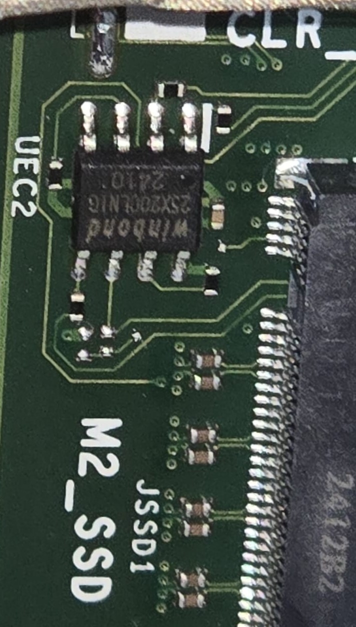

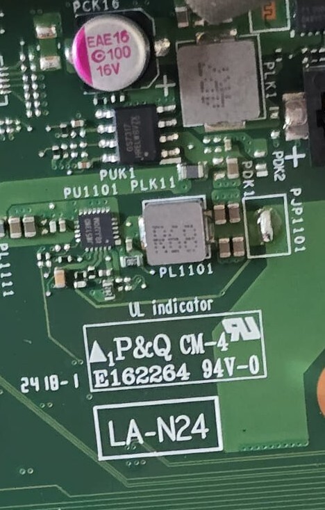

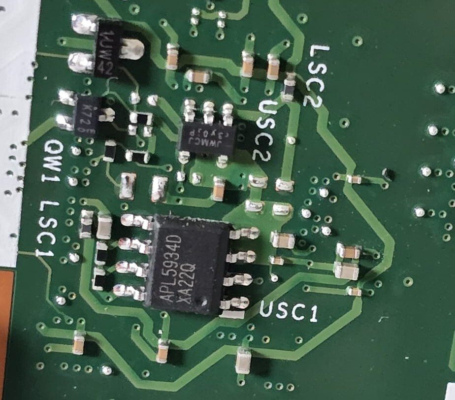

          Also, there are a bunch of other chips around the board, I have posted pictures of them.
