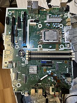

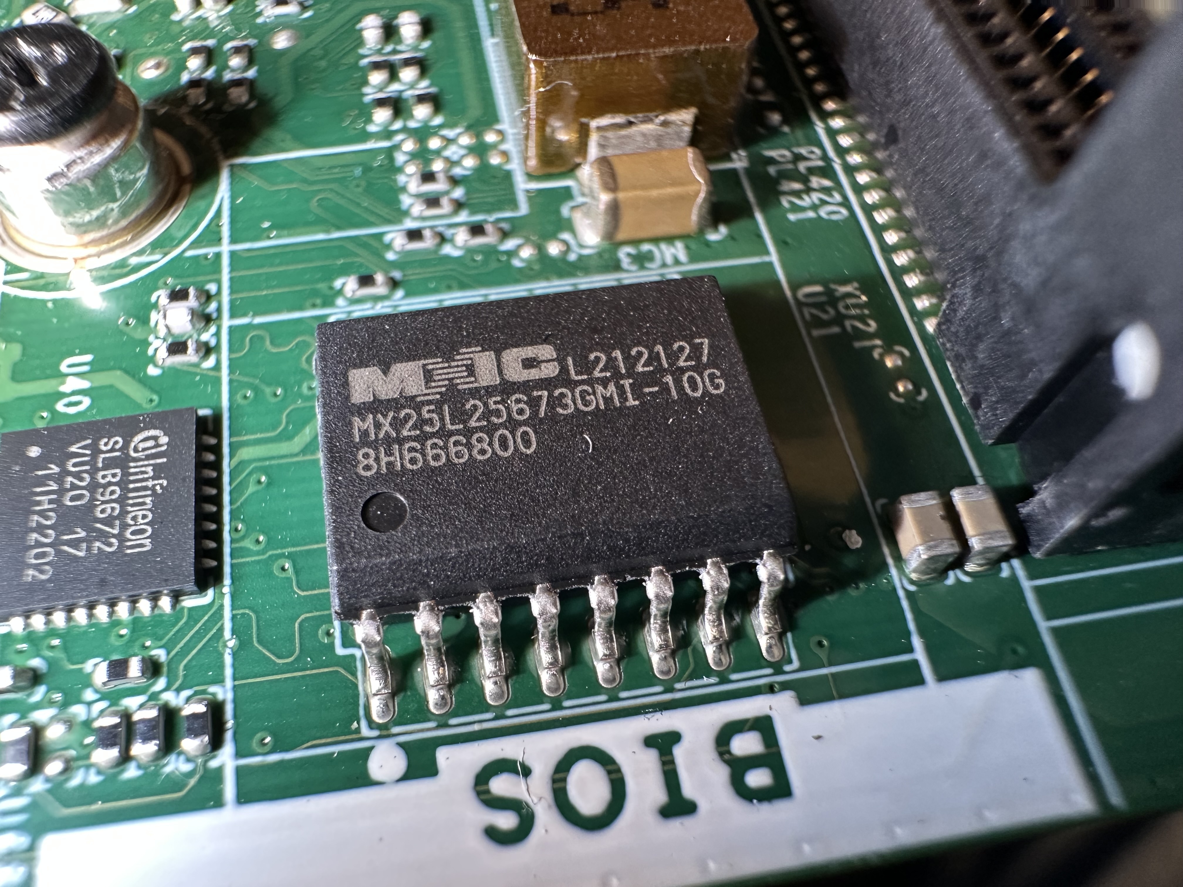

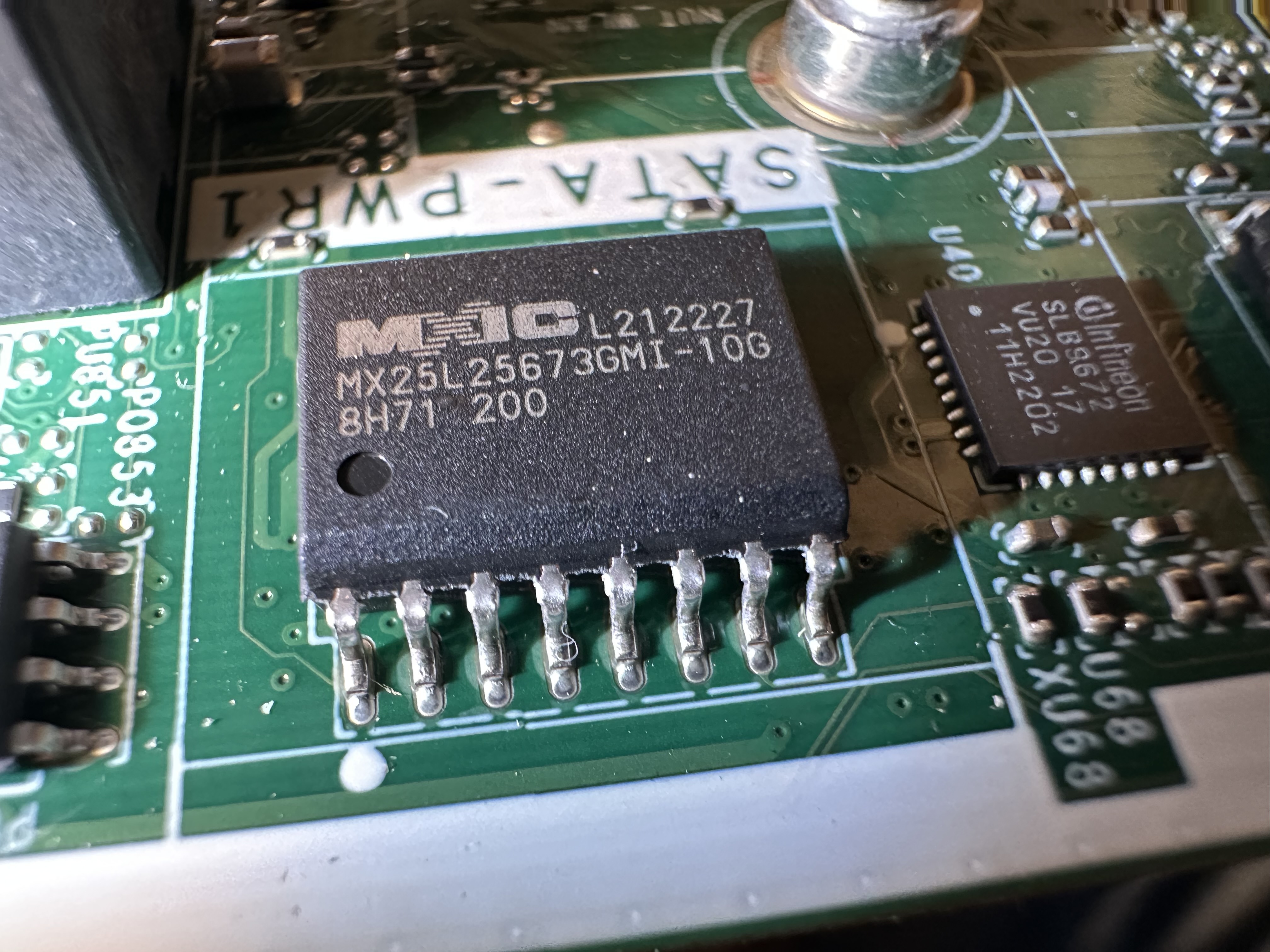

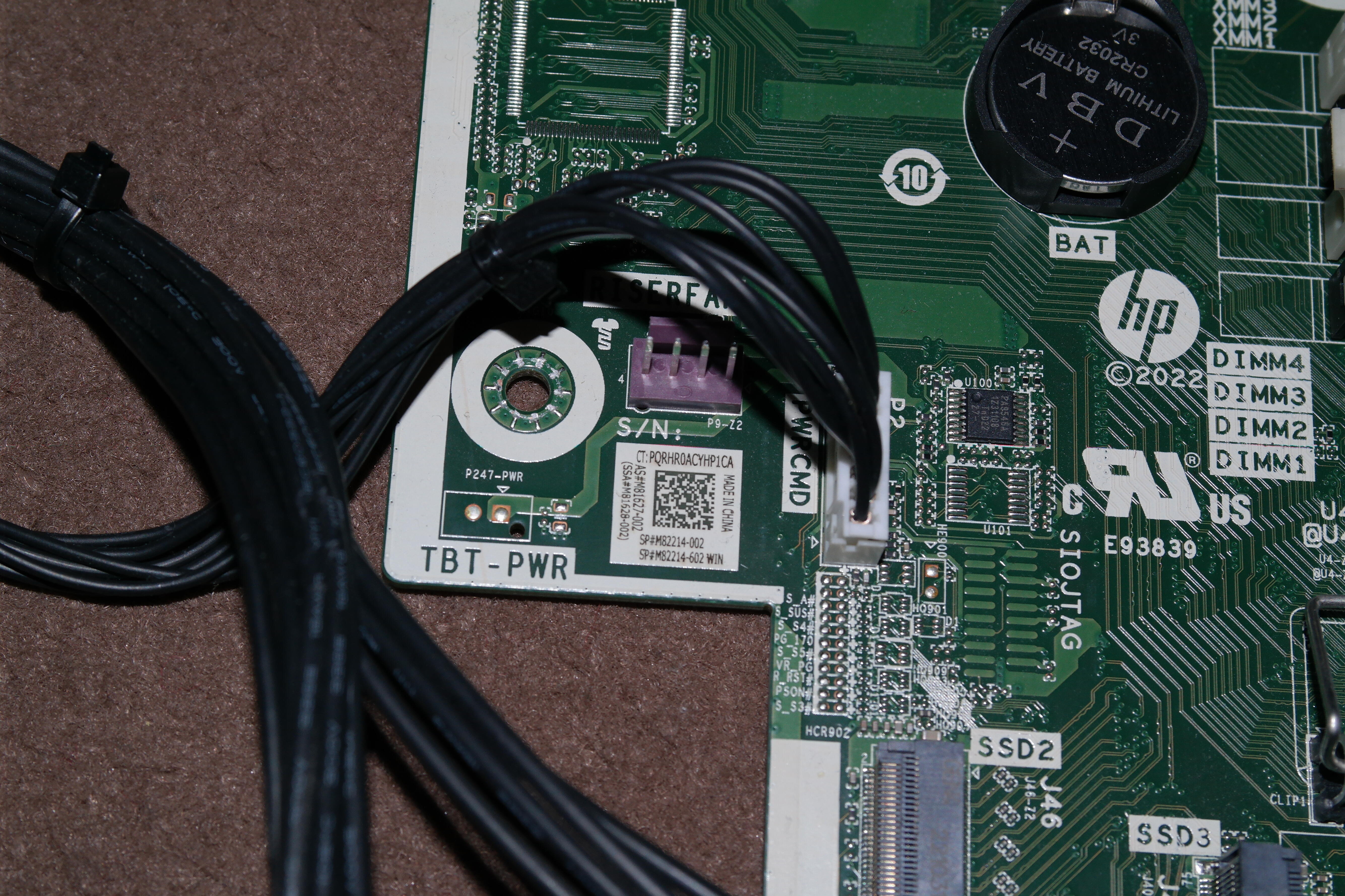

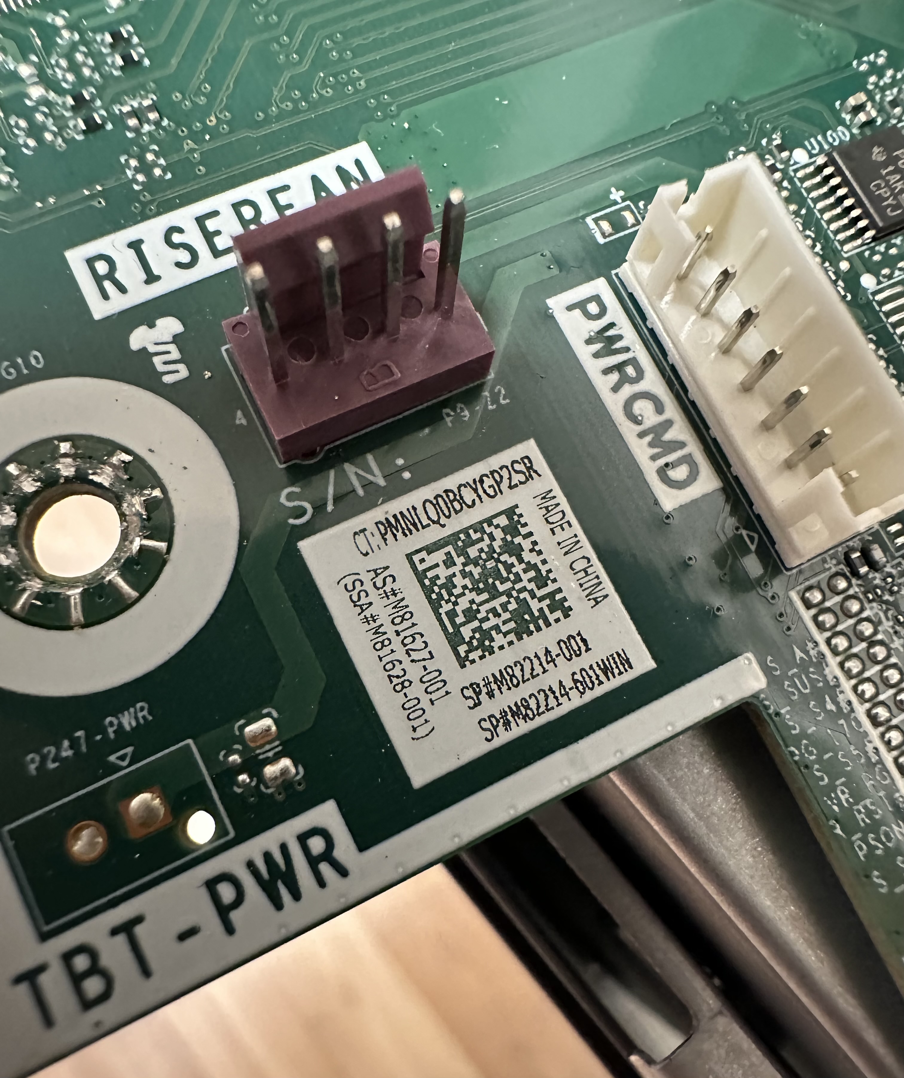

    Heya,
    I'm currently trying to fix a “HP Z2 Small Form Factor G9 Workstation (5F0D1EA)” after HP issued a warning that some models may become entirely unbootable if left on specific old versions. The exact issue happened to the one I got right now: https://support.hp.com/us-en/documen...235-8577455-16
    I've already desoldered and dumped the broken BIOS, over on the "level1techs" forums someone already took a look at it and sadly couldn't fix it either 😥 Still grateful of them taking a look however!
    I guess the current BIOS/dump truly seems to be dead. I'm a beginner so not even sure where to start looking but willing to learn 😃
    Later on I would also love to provide an anonymized BIOS dump to everyone who needs and looks for it if possible 😊 This specific model seems to be a bit of a nieche thing as I can't find too much information about it.
    Fault behavior: PC turns on for around 20 seconds, then turns off. No display output, sometimes it restarts automatically but turns off again after 20 seconds. HP recovery is not possible, it doesn't even boot that far 😫 Removing the RAM still shows the typical red blinking LED, so "something" is still working at least 🤣 Trying to turn it on without a BIOS chip at all doesn't even turn the Power LED on, so some functionality is still given by it.
    Board Details:
    SCRABBLE
    REV: A
    M11 FMB-2202
    Model Nr.: 5F0D1EA#ABD
    Ser. Nr.: Please DM if needed, thanks!
    Broken BIOS Dump: Please DM due to dump containing possible personal information, thanks!
    Mainboard
    Chip 1
    Chip 2
    Potential further information
    To my best (yet beginner) knowledge one of them is the BIOS/UEFI chip and the other contains Intel ME data.
    Thanks a lot already for your help! I'm also of course willing to donate a few coffees if this board works again ❤
    Best regards,
    Stefan

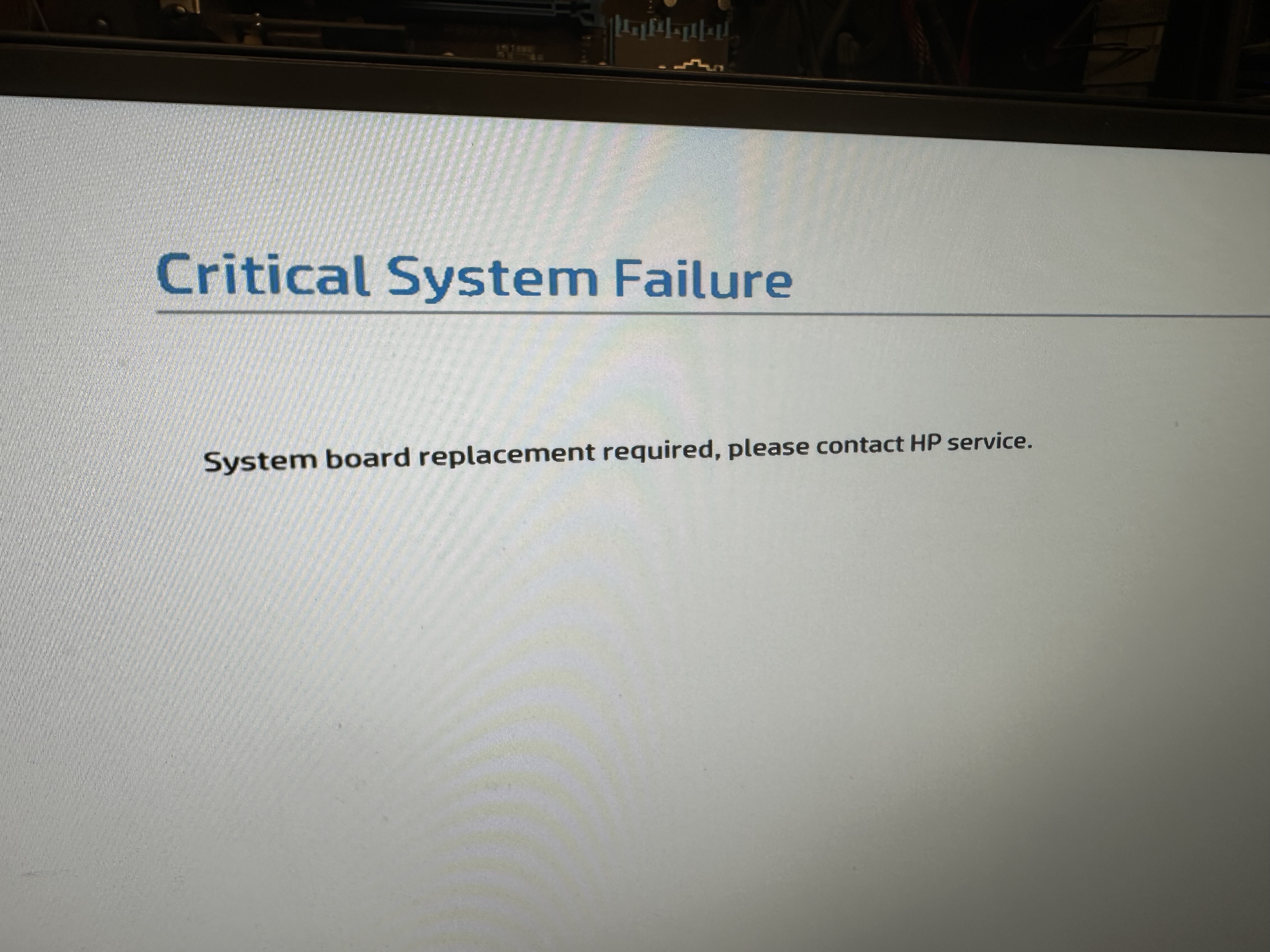

                  Originally posted by SMDFlea
                  Yes i did
                  Oh my god yes this works almost! There is LIFE!
                  It started up, complained a few times about something not being right and then showed the HP logo screen for a few seconds before restarting. Then it started beeping 4 times slow (red LED) then 2 times fast (white LED). After a hard power cycle it then showed "Critical System Failure", but I think it might be due to something else not being quite right yet with the BIOS or Intel ME.
                  I tried to quickly boot into the BIOS recovery but always ended up on the same critical failure screen, tho I still need to try another keyboard or USB stick potentially and see if that works.
                  If you still have another idea to fix the critical system failure screen I welcome any suggestions But this is BY FAR the furthest I've gotten yet! 👀

                    • EpicLPer
                      Average Techie
                      • Mar 2024
                      • 11
                      • Austria
                      Try this new one.
                      This one has the same behavior as the one before, it starts up, restarts a few times to recover things, then shows the same replacement board message again. I've also held Win + B the entire time to see if I can enter recovery mode, even while it restored some values, however it never booted into it.
                      So close, I can already smell a success 👀

                            Originally posted by EpicLPer
                            Heya,
                            Hello
                            i used your bios also the machine gone same yours
                            critical system failure system board replacement required please contact hp service
                            may be your bios is fataling destroying pc ?

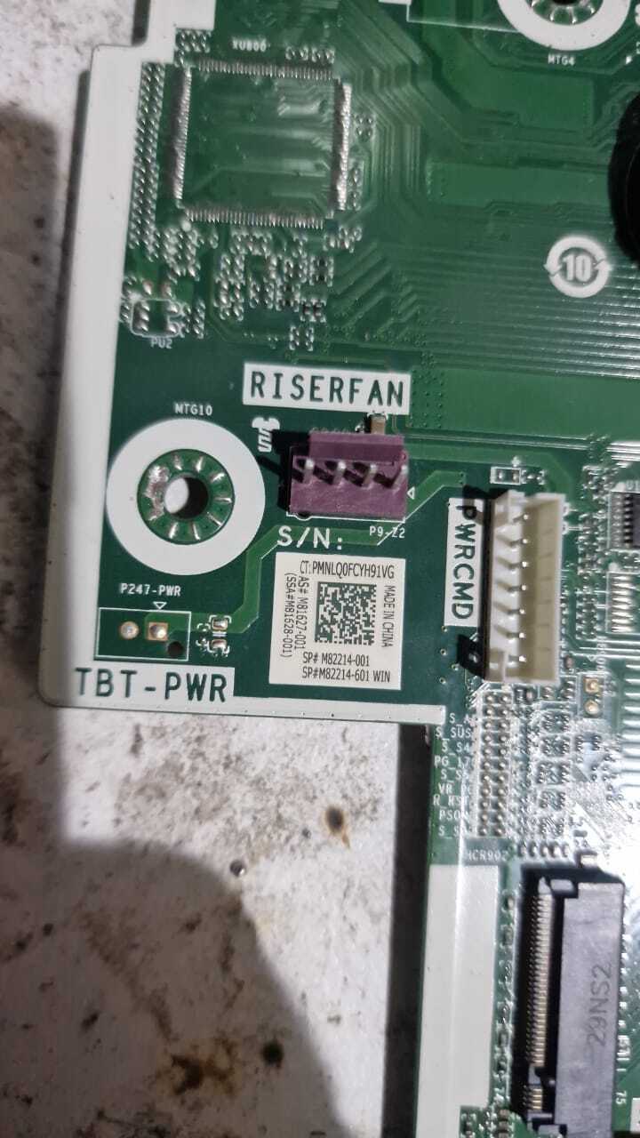

                              here is images of the pc Serial Numbers

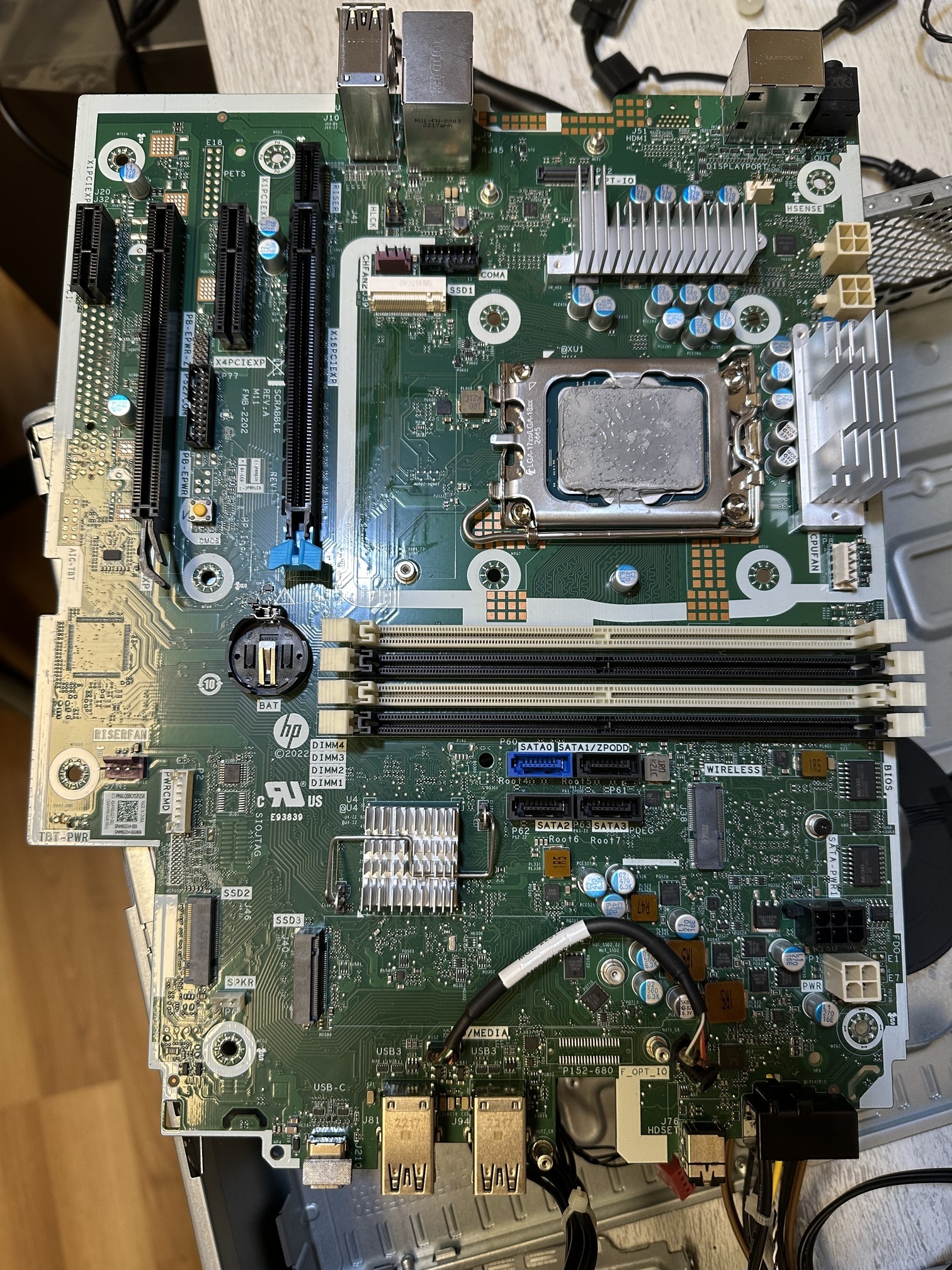

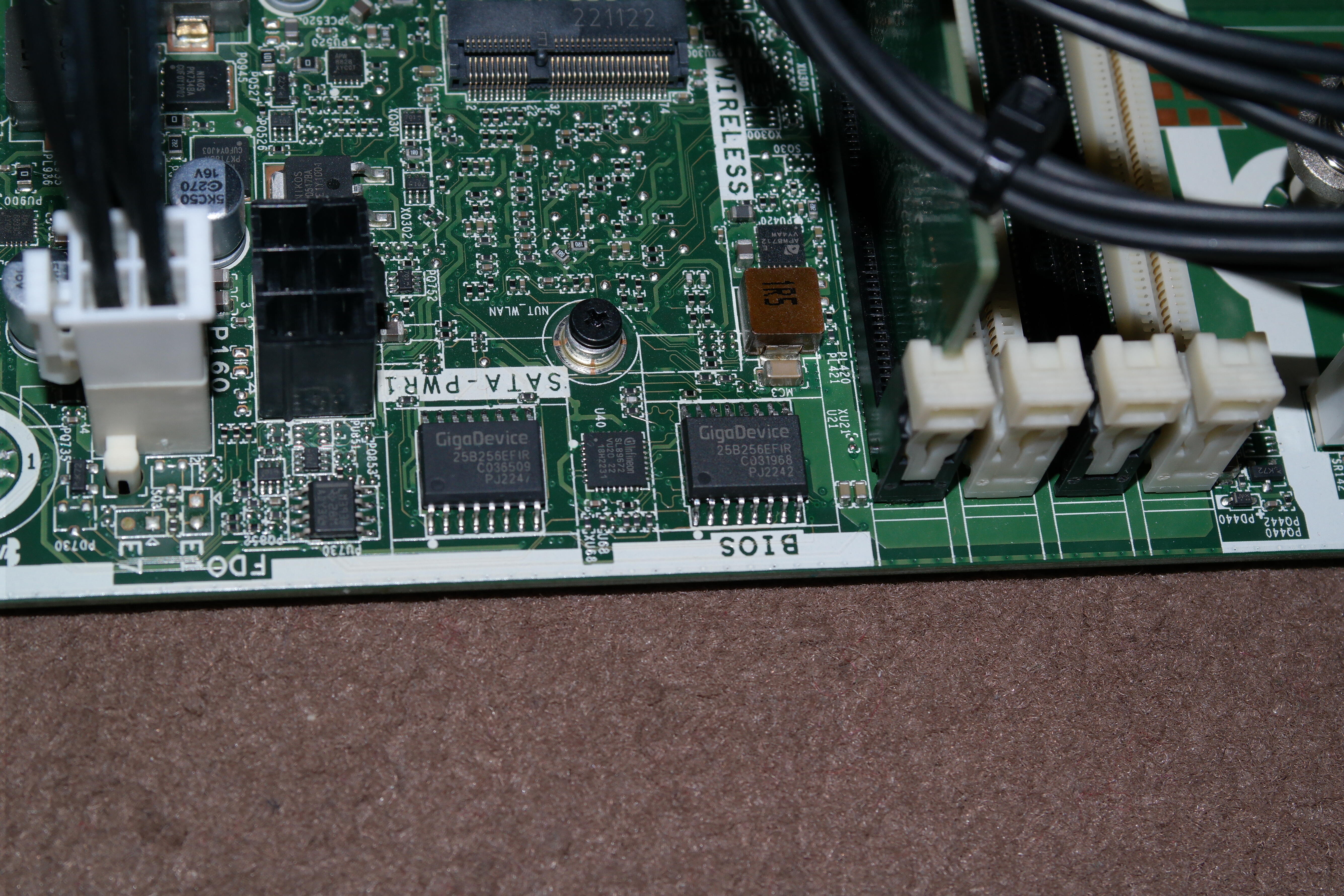

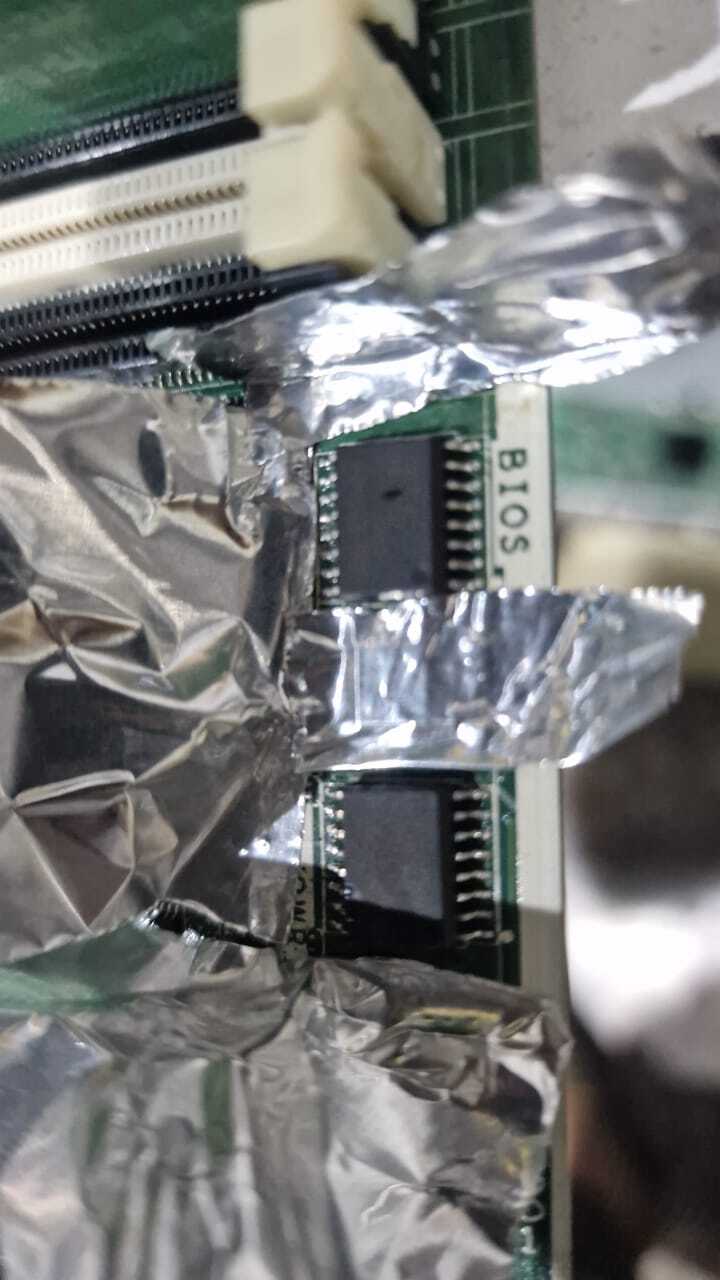

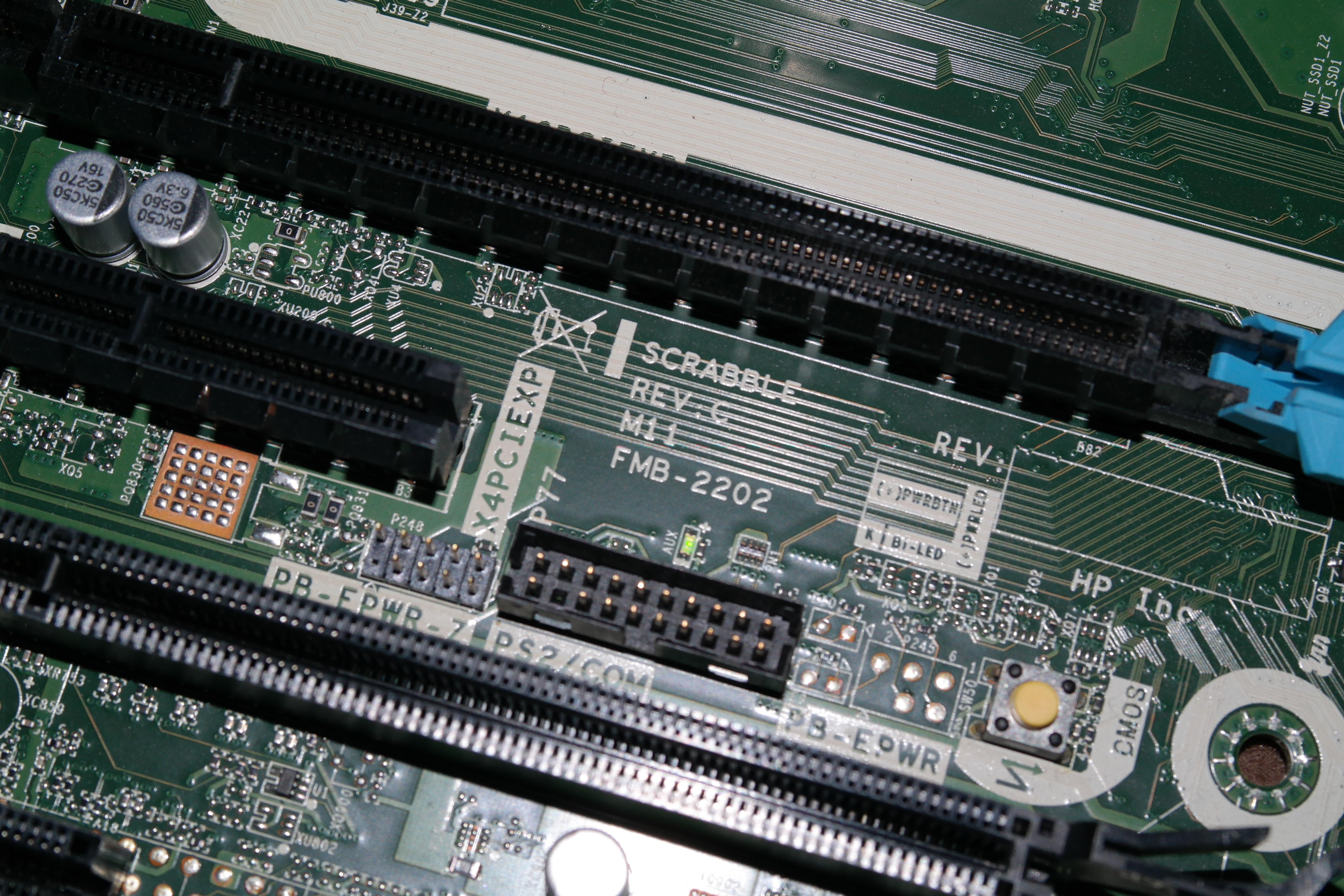

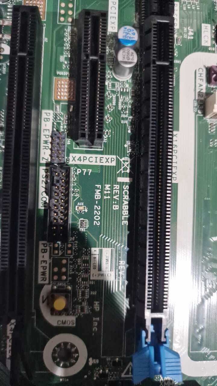

                                Hello, I have the same issue as EpicLPer where the system does not boot. Tried flashing the BIOSes from SMDFlea and the symptoms were, again, the same as EpicLPer's (and now HAWKAR's).
                                I noticed that the revisions of all three motherboards differ (rev. A, B and C) but I don't know if that means anything.
                                The model number of this HP Z2 SFF G9 is 5F157EA#ABU and the serial number is CZC325719X.
