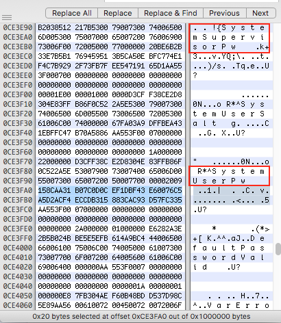

          try this but I'm not sure. I deleted what I think is supervisor password, see photo. I filled selected area with 00, you can try filling with FF if it doesn't work.

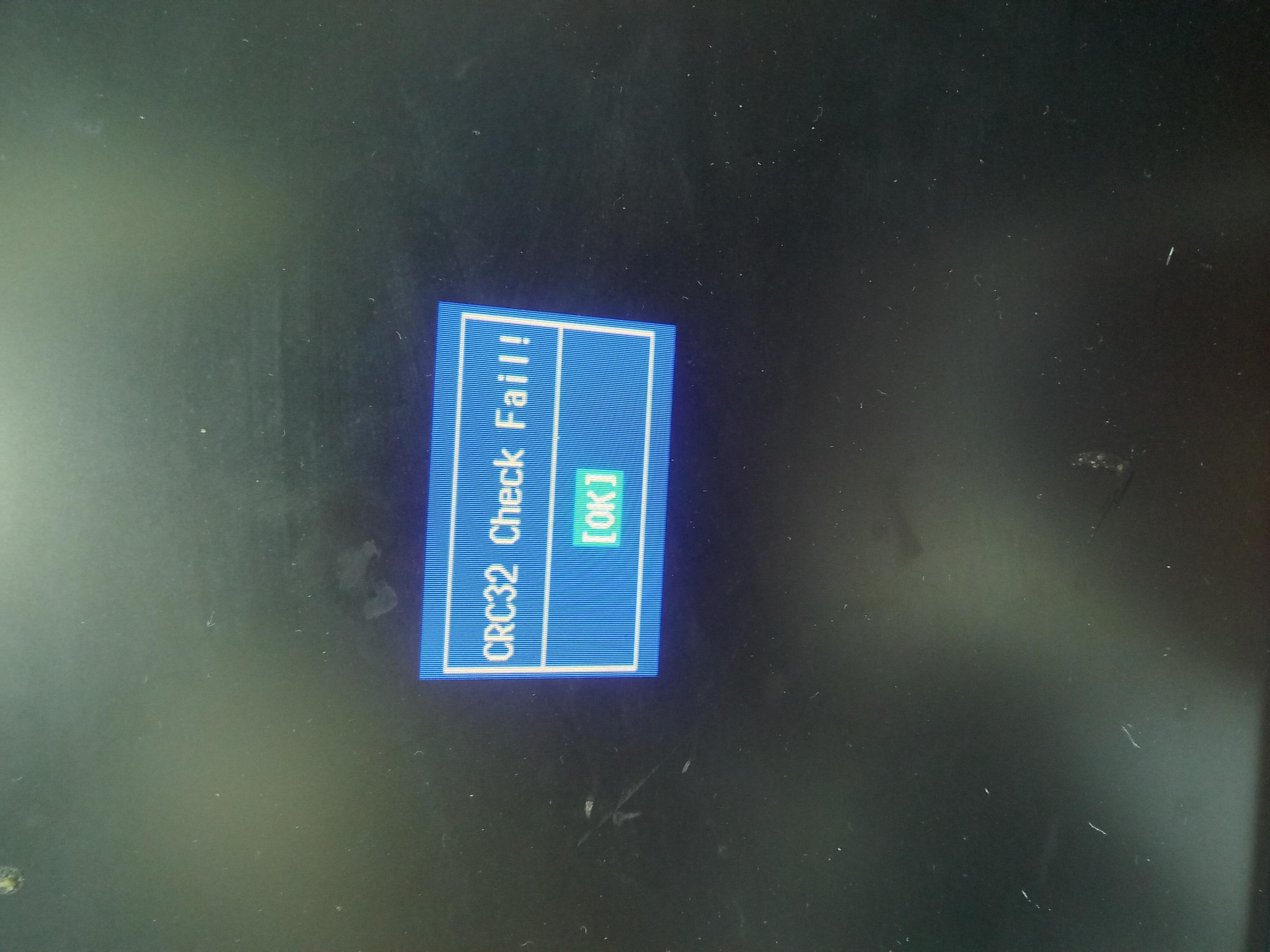

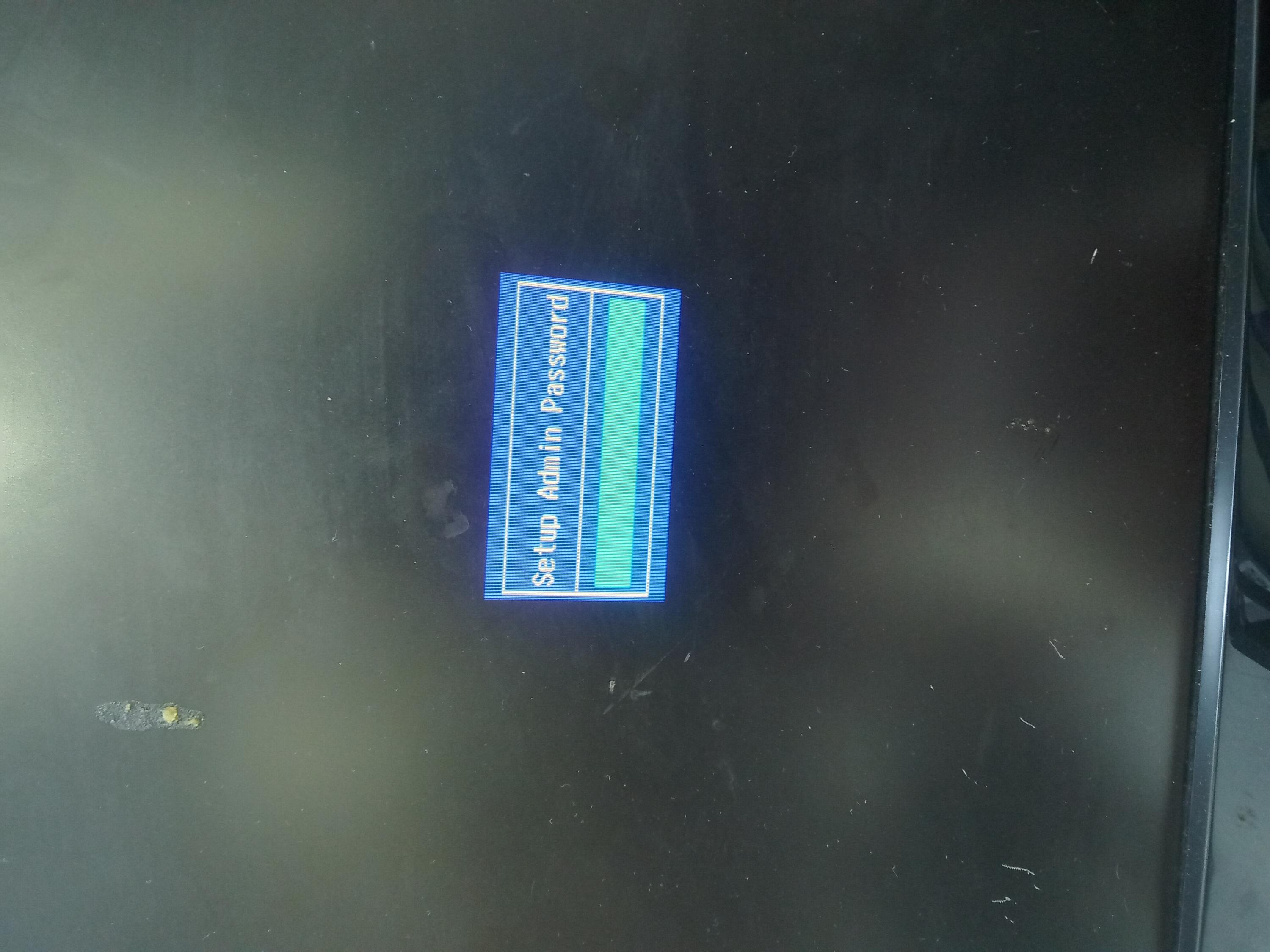

              Re: NCR_MILANO_V3.1 bios password

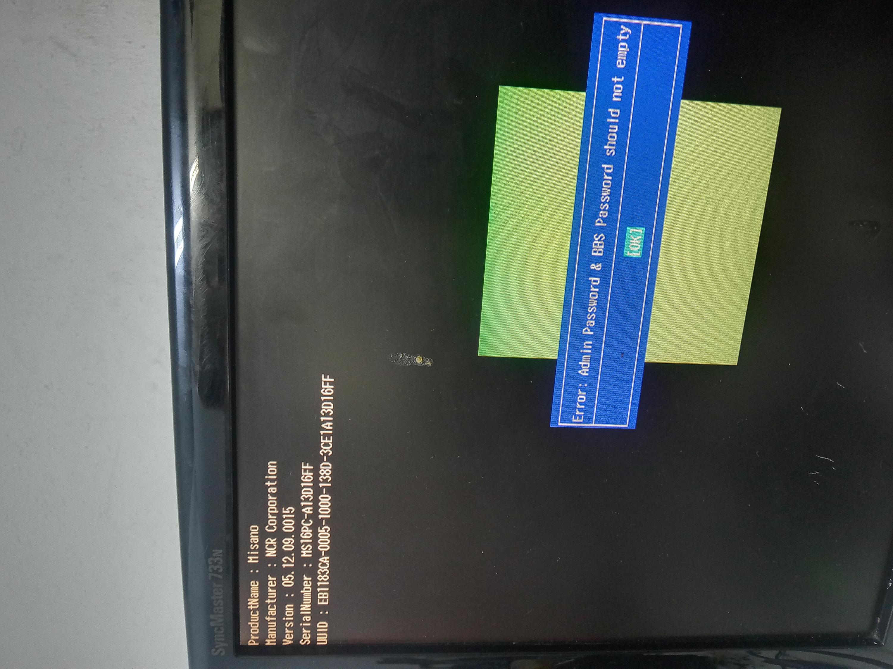

              i have flashed the bios and it comes on but says
              Error: Admin Password & BBS Password should not be empty.
              then it gives me the option to setup new admin password but after i do that it then gives me error: CRC32 Check Fail and then goes back to Admin password setup screen. i have attached the pics of the errors. any help will be greatly appreaciated.

                Change 00 by FF

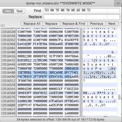

                  sorry for the trouble guys, i have a challenge the hex editor i am using when i search inside the file for offset 13516464 gives error that there is no such offset found in this file i don't know what i am doing wrong. what HEX editor did you use VOLINAKIS?

                    search for hex:
                    53007500 70006500 72007600 69007300 6F007200 500077
                    (SupervisorPw)
                    also check SystemUserPw below, it seems there is something there

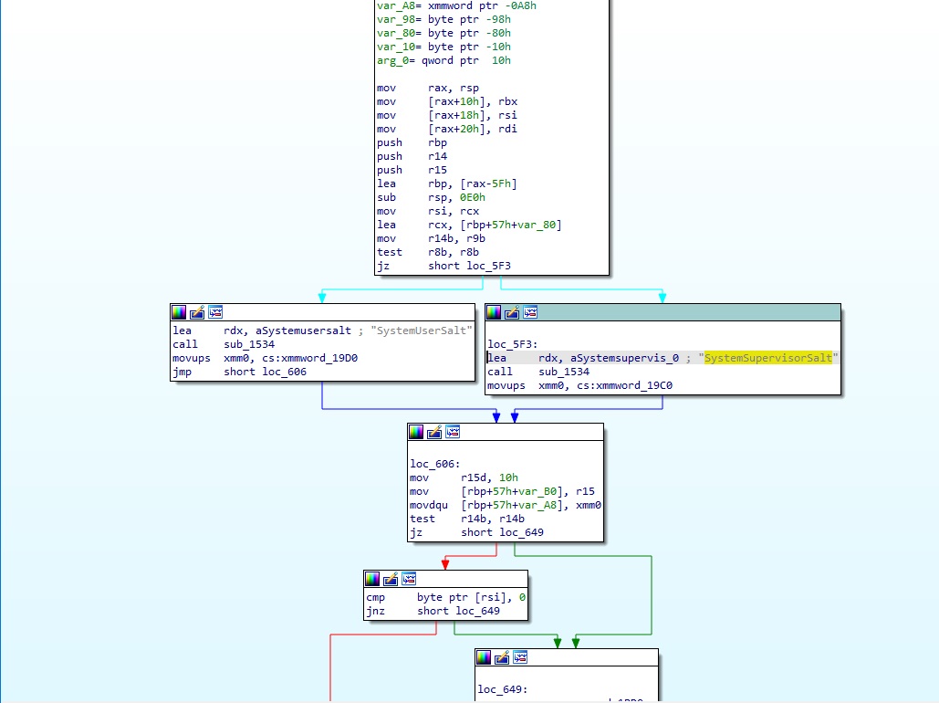

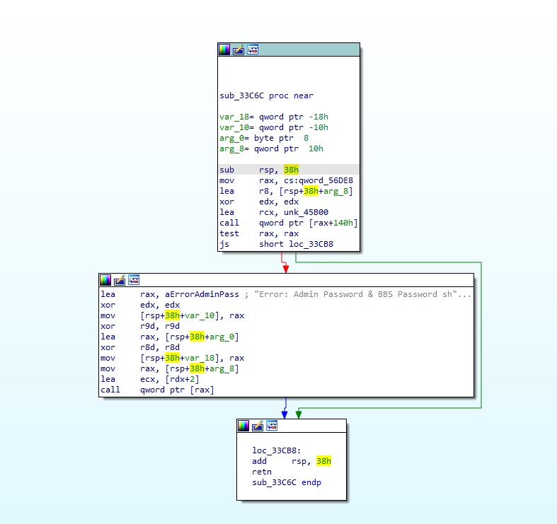

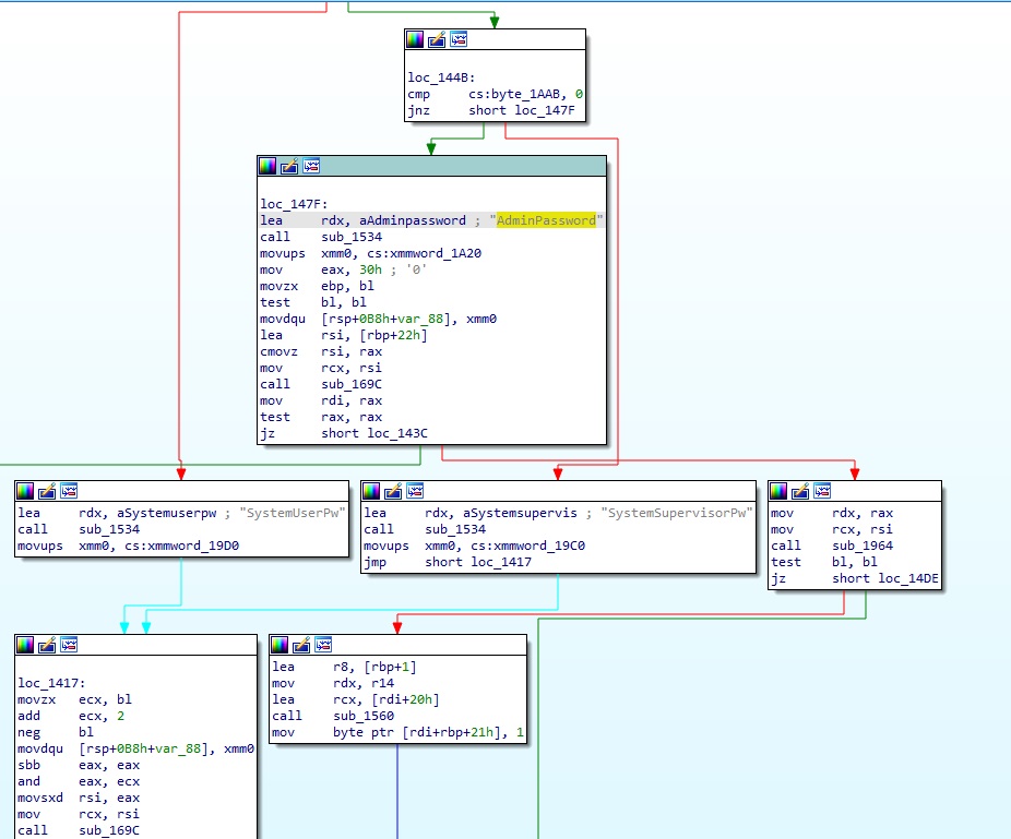

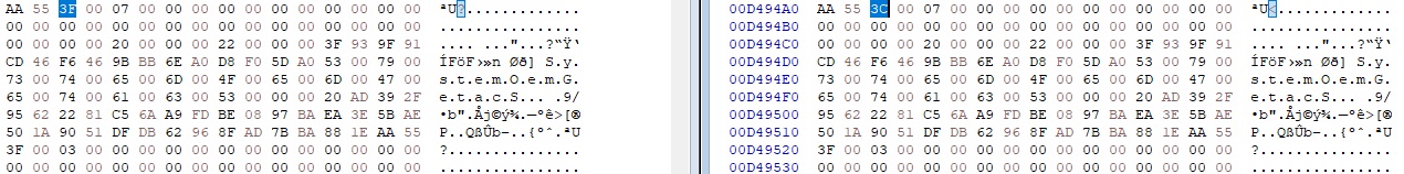

                      search for hex:
                      (SupervisorPw)
                      The password is too salty
                      the Getac solution (see last image) AAS VS CMP (3F Vs 3C) cannot work on this model?
                      • volinakis
                        • Jan 2021
                        • 2728
                        • N/A
                        too advanced for me! But he can try.

                            • vladimirplus
                              • Nov 2024
                              • Deutchland
                              Thanks to everyone for the help!
                              I managed to do it, but I had to replace the password with zeros in three places, as FF didn't work. The next part is more interesting: the BIOS complains about the CRC32. The secret is that NCR came up with the following solution: when entering a new password for the first time, you enter the password itself, and instead of confirming the password, you enter its CRC32
                              (https://crc32.online/), and everything will work.​
