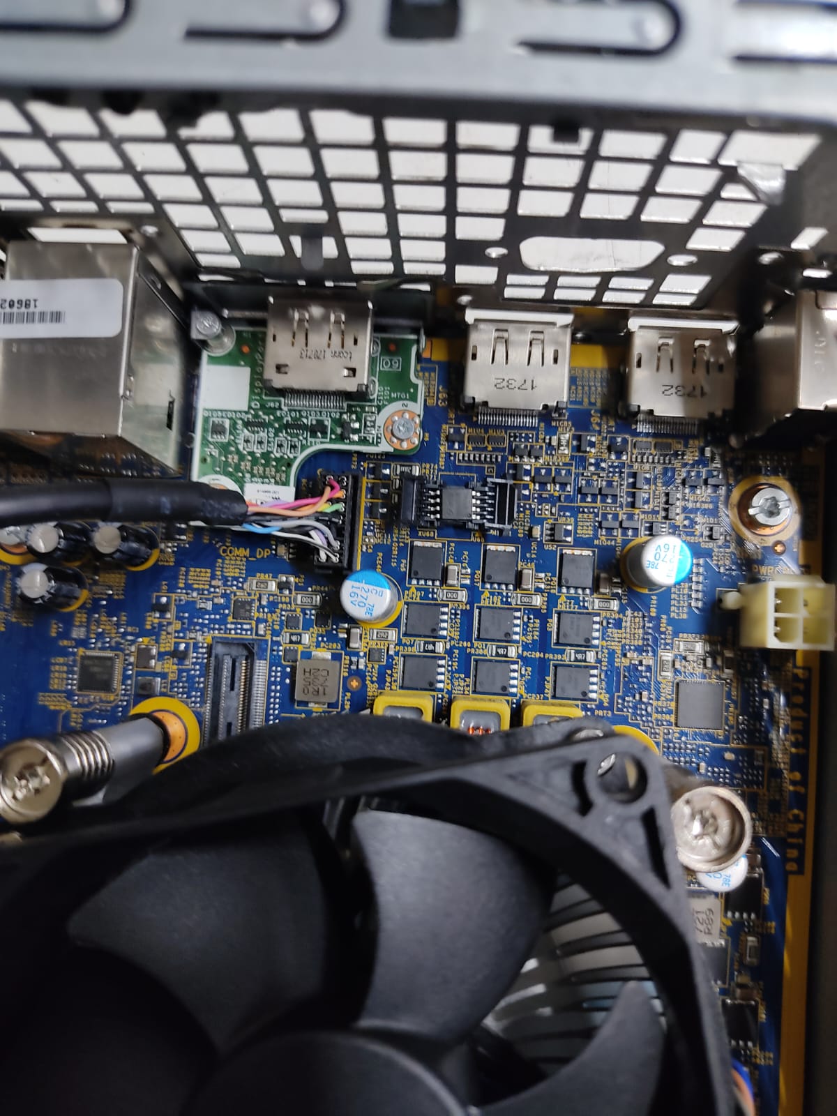

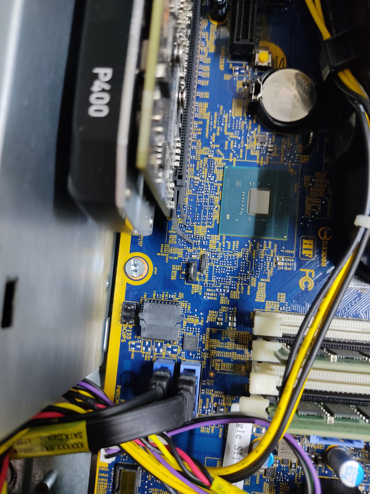

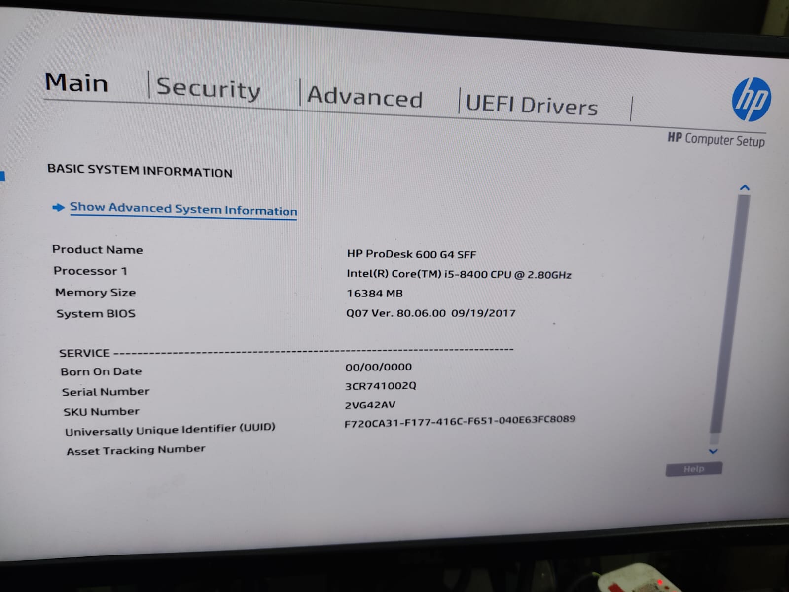

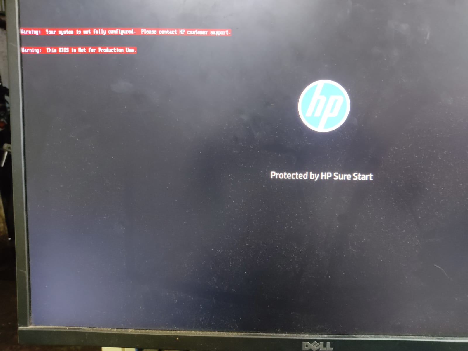

    Recently I received a batch of HP desktops all of which are in testing mode bios.
    They all display the error "Your system is not fully configured. Please contact HP customer support.
    Warning: This BIOS is Not for Production Use".
    It has a main bios and an EC separate on the board.

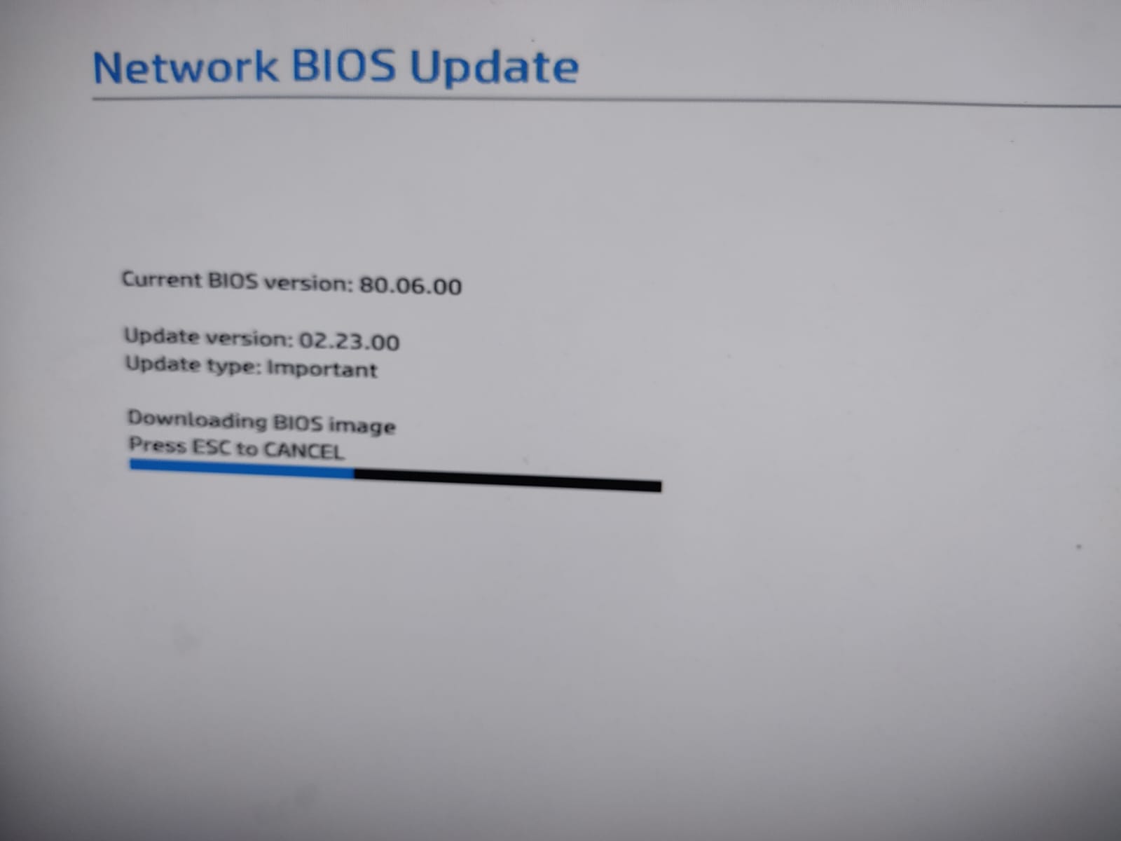

    while trying to update the bios from the network it connects to the HP site downloads the bios with a version of 2.23 but restarts after downloading, same happens with a recovery pen drive. I tried programming it with a bios from another site didn't work.
    Can someone provide working bios for the PC

    Re: HP ProDesk 600 G4 SFF - Warning: Bios is not for Production use
    Looks like it's a prototype/engineering board, retail BIOS might not work properly on there.

          If flashing the bios doesn`t work this might help
          https://www.badcaps.net/forum/showth...lly+configured
          https://www.badcaps.net/forum/showpo...6&postcount=42
          https://www.badcaps.net/forum/showth...light=sssm.bat

            Hi tried the files you gave dosent work

              tried sssm.bat from WNDMIFIT not working either.

                Ok well, as piernov said it could be a prototype/engineering board.Changing the PCH could be the only option.

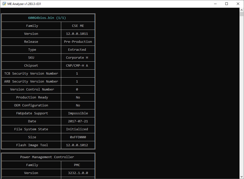

                  Using Analyzer i have noticed an option FWUpdate Support │ Impossible
                  is that why I am unable to update the bios using a USB drive. Is it possible to mod the bios to change this option.
